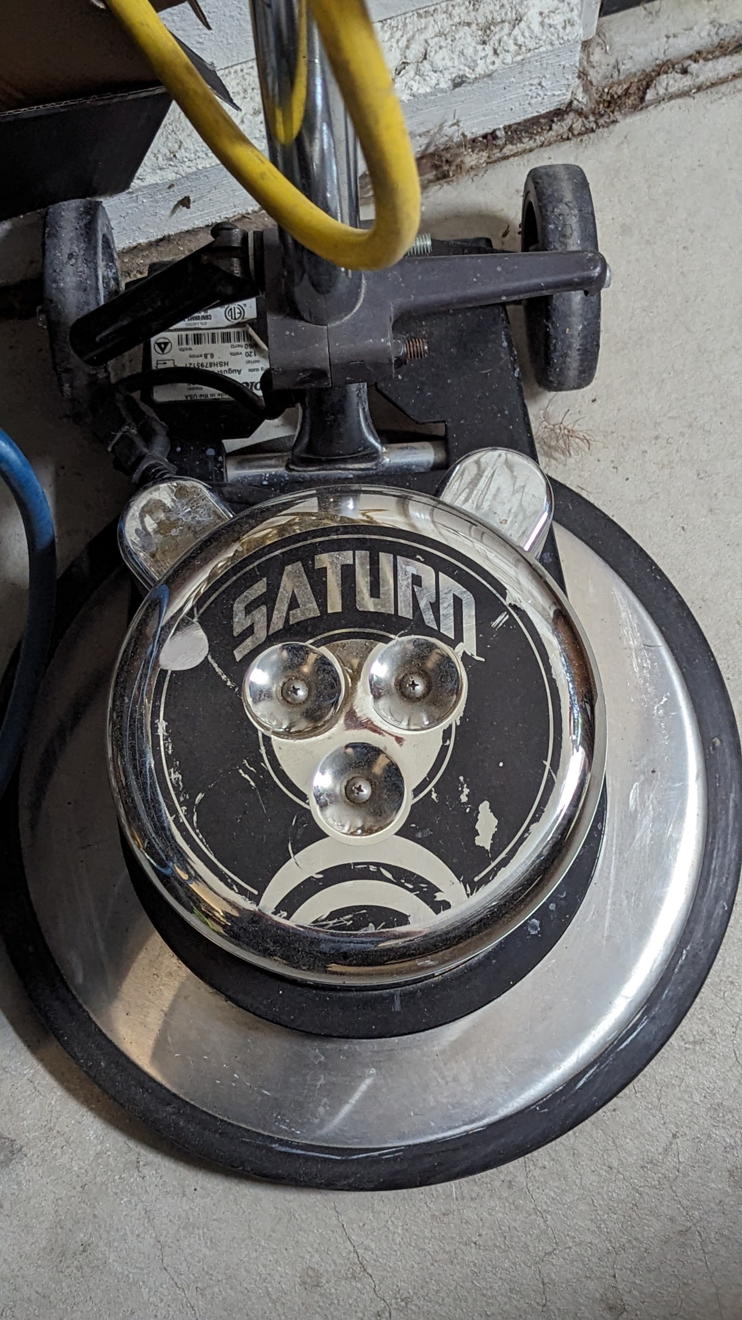

Saturn the sad monkey can scrub in your prespray for excellent results .. PXL_20230922_023656645.jpg
