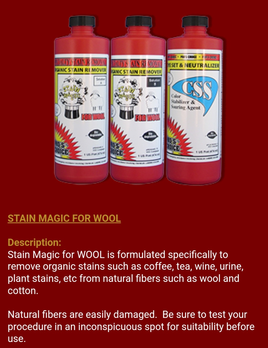

Soap Daddy makes a product for that, but I haven’t had an opportunity to use it yet, so I don’t know if it works.

Great advice everyone! Thanks!
Stain Magic for Wool looks promising.
It's shameful that after all these years I've never tried it. How embarrassing.
Thanks again. Much appreciated!
