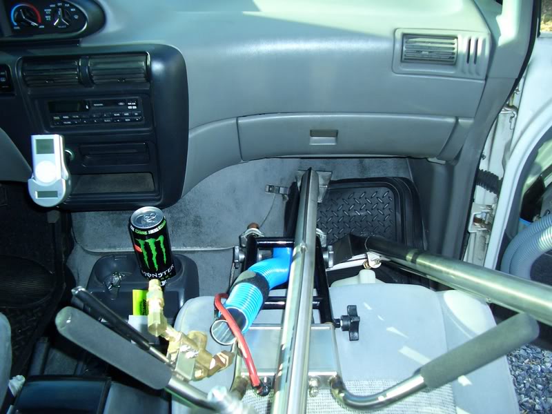

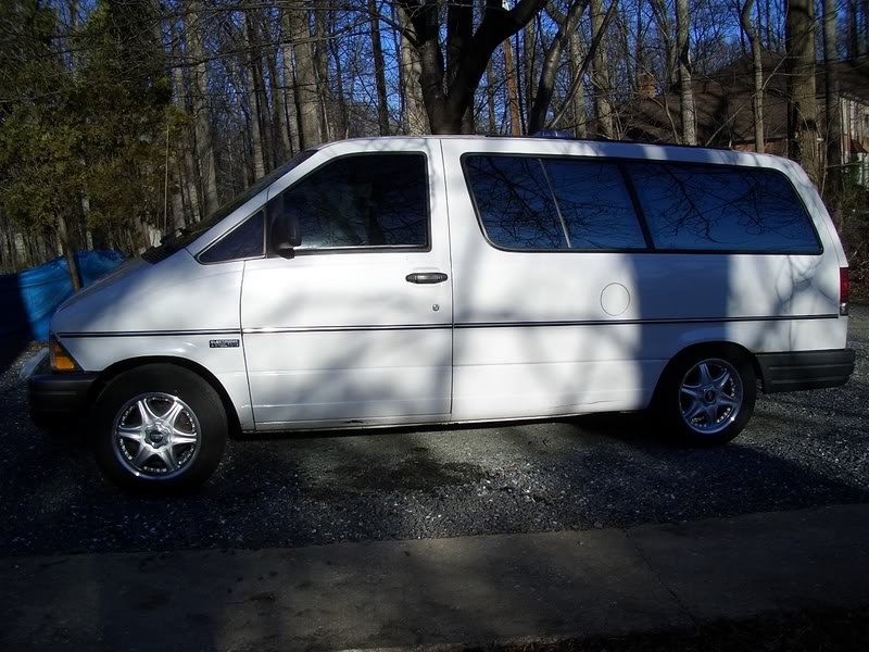

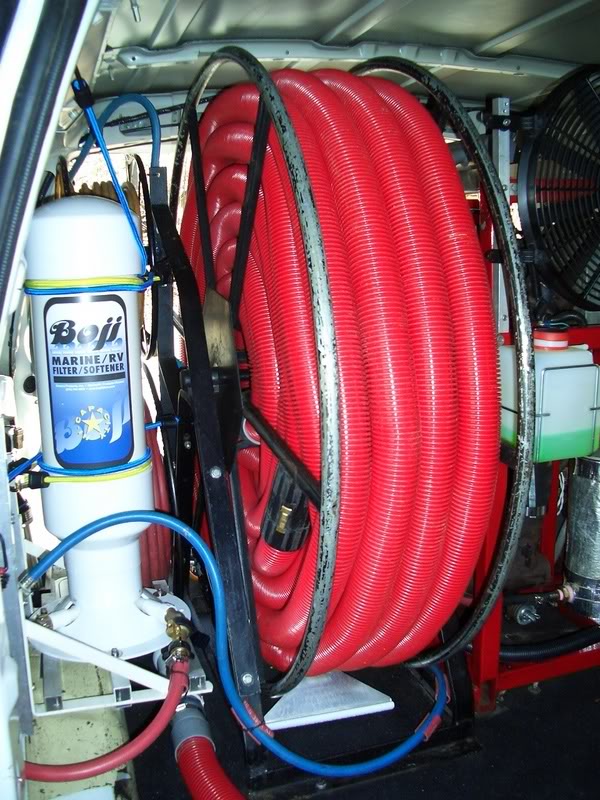

I Just recently transfered all equipment over to my new mini extended Aerostar 4x4, I decided to maximize space as much as possible.
My narrow TM footprint allows me to run this awesome rear mounted configuration. Everything is at my fingertips. My equipment and I are protected from bad weather due to the overhead protection of the hatchback. That mainly is why I use a mini. If only there was a full size van with a rear hatch.
I'm such a nut for keeping everything in its place and in top condition.
My re-located, re-designed, ceramic coated custom exhaust I came up with SS heat shields, no more belt failure and component cooking!
I try to use every inch of space
I'm proud of all my hard work turning this bitch from a multi-problematic lemon into a high performance beast. She is tricked out and back with a vengeance! Many thanks for all that helped me with my numerous failures and problems over the years.

I know you've spent a lot of hard work on your van, but I think it is unsafe because of the propane bottle behind the seat.
In the second picture, the little circle on the propane regulator is a VENT. It will release propane if the temperature in your van gets too hot. The pilot on the heater looks to be about 18" away.
It is clearly illegal in most states, including Texas.
Go to an external tank for safer operation.

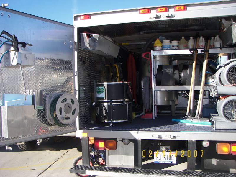

The Cleaning Artist's truck looks freaking amazing!!!! If that thing was parked in my driveway I would know this guy is for real!!
Fast Eddie
it looks like you are doing the best you can with what you have but I hope you never get into a wreck. If you get into a wreck you better hope you are killed because if that thing hits and kills someone else you will be sued for everything you have!!!! Very unsafe. A cheap cargo van goes a long way.

Adam, can you please explain a little more in detail what you mean by that and why my set-up is so much more dangerous than average? Besides the LP bottle, which Larry pointed out, which I was aware of and kinda sketched out about it from the start. A year has passed with no issues though.
I would think that having a half ton TM, like the majority cleaners do, mounted directly behind the driver and passenger seats would have a high degree of danger involved in case of an accident as well?

I think what he means is tools laying loose in the van. These become flying objects in the event of an accident.

I really don't have any tools loose and laying around. The ones up front are strapped down using a rachet strap which I removed for the pics.

I have a friend that was in a car wreck. The insurance would not cover him because he had Birthday balloons in his back seat which was blocking his view. ( So they say ) I can imagine what they could say about your minivan.
I guess I think Lawyers look for anything to go after. If somebody hit me and caused damage to me or my truck I would look into why they screwed up. If I saw a minivan sagging down in the back way over loaded causing way more wear and tear on the brakes, shocks and struts then ever were intended for that van. A LP bottle and sharp tools ready to fly into the driver or on to the floor by the brake or gas pedal. ( I now understand and you strap them down ) It would make me wonder if the van is safe and did any of those things cause the accident? I think people look for any good reason to screw other people and I think that van gives a few reasons.
I think you would be a great friend to have if I was going to move because you could pack my whole house into a small UHAUL! You have used every inch of space perfectly. I do think you would like a cargo van lots more and be less of a liability. I may be wrong.

"If I saw a minivan sagging down in the back way over loaded causing way more wear and tear on the brakes, shocks and struts then ever were intended for that van"
I hear where your coming from Adam but I have a beefed up suspension with extra heavy duty springs in combination with rear air shocks. Brakes were upgraded as well. The van handles very well and stops just fine. As far as heat build-up I have no issues due to the radiator fan mounted on TM moving large amounts of air out the back. I also have a solar vent that exhaust air out 24/7 during the warmer months.
I am going to work on getting a LP belly tank or going back to H/X heat. Eventually I will get a full size cargo.
