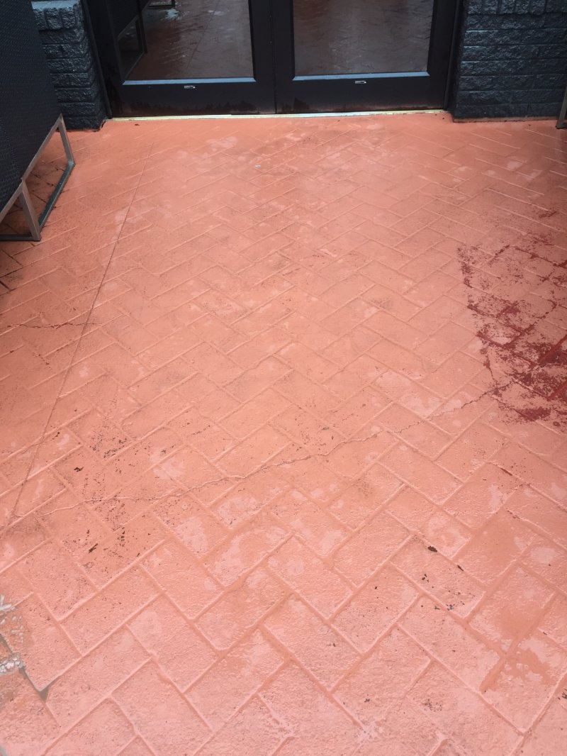

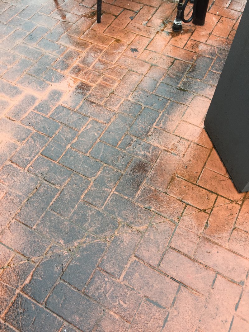

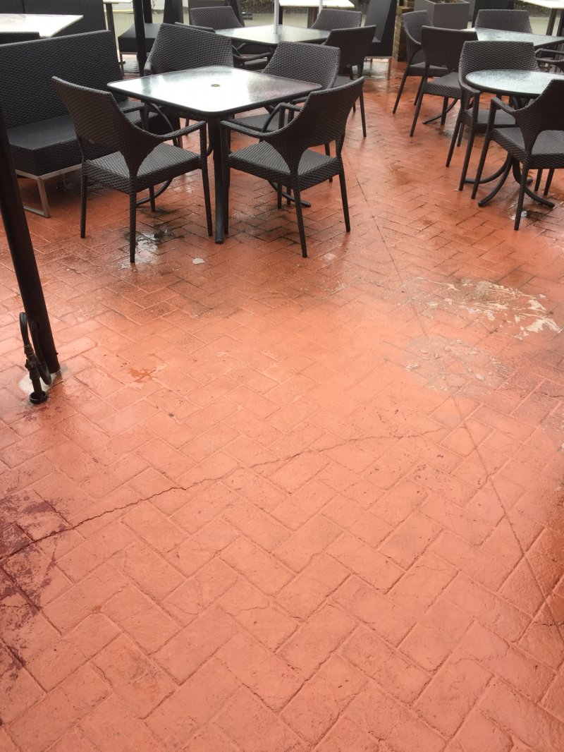

How would you clean with a TM? They usually have it pressure washed but this year is different. AThey have money to burn to get it done correctly. Going to do a sample area tomorrow in the AM.
Was thinking of sweeping it rinsing with hose to get all debris of then typical TG process with degreaser and nuclear pre-spray....sucks that I don't have access to brown TG brushes for my CRB..
It was red then painted terra cotta....STAY AWAY????? And how much to charge them... IMG_2252.JPGIMG_2250.JPGIMG_2252.JPGIMG_2250.JPGIMG_2246.JPGIMG_2252.JPGIMG_2250.JPGIMG_2246.JPG

Ed, when you bid jobs like that, take a spray bottle of something with you, and a stiff brush (like you'd do dishes with).
Test a spot and see if it gives way.
My recommendation is to use a straight degreaser, as they tend not to bother paint. I've taken really thick, gummy restaurant grease off painted stucco with just a sprayer, a brush and rinsing hose, after the Green Guys ("Like we never even tried") failed twice with a pressure washer. This probably will come off with sprayed degreaser, dwell and agitate with an automotive washing brush. Then rinse and repeat.
Hedge your bets and emphasize that the greasy soil has probably ruined the brick stain, and when you clean it, it may come off. Make SURE you dump that monkey ahead of time. If it doesn't damage anything, just smile and schedule your next visit.

looks like the paints coming off anyway. Let the customers that the paint may come off. You can't guarantee some elses work.

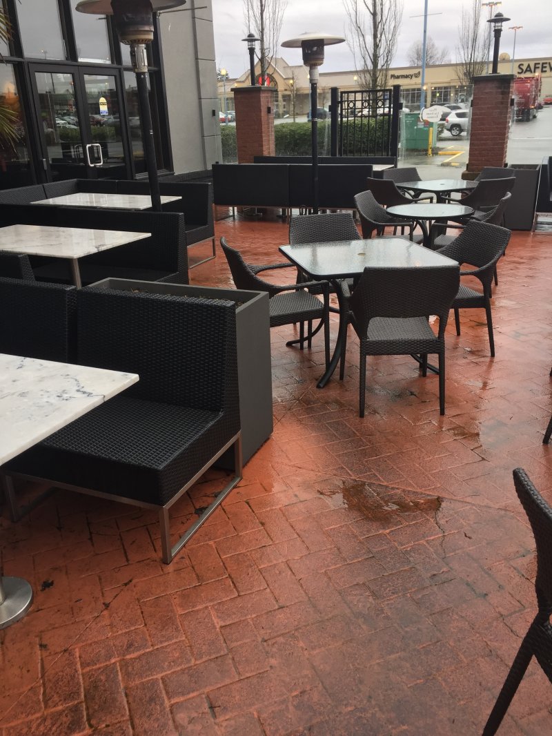

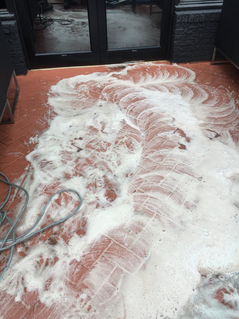

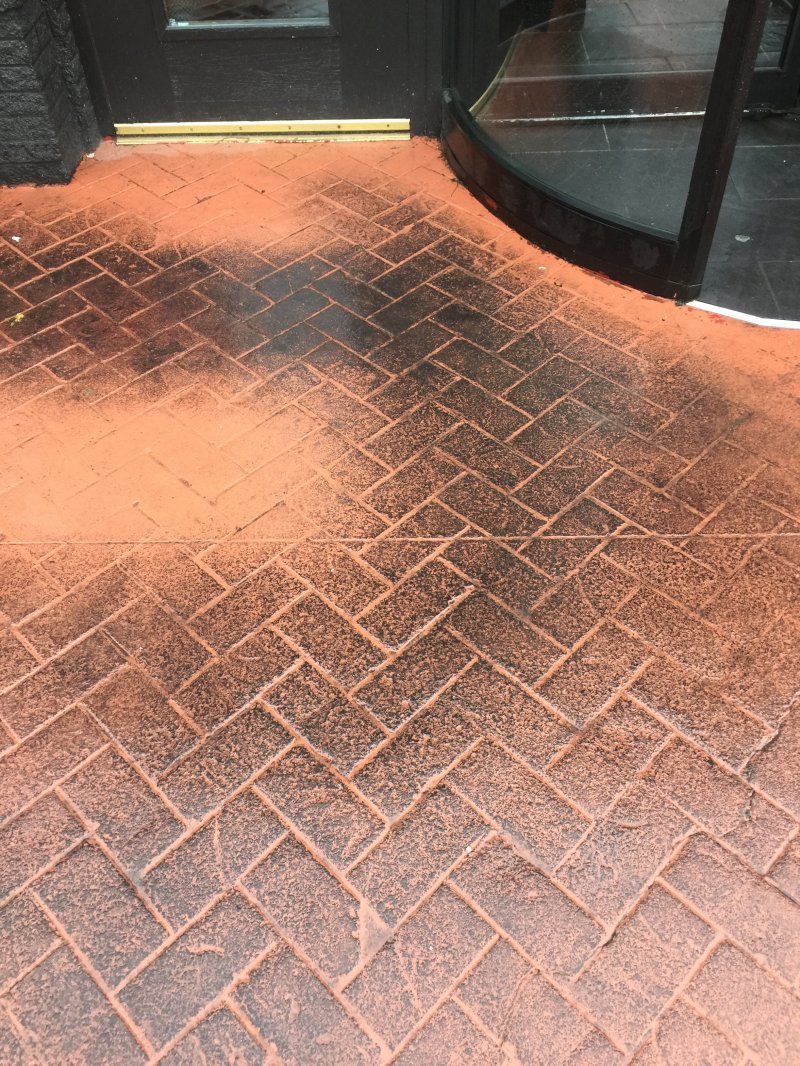

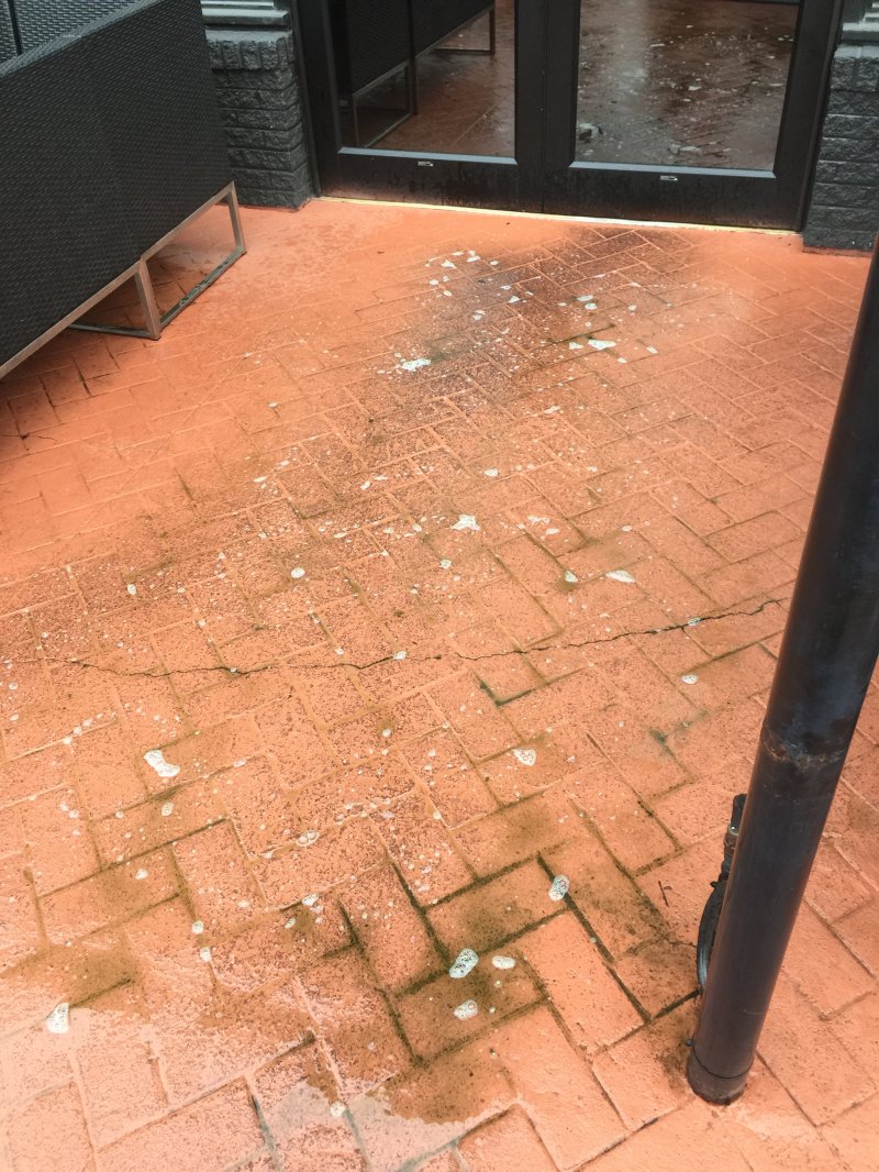

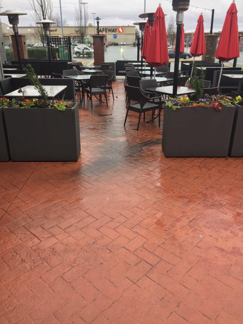

So could not find a decent degreaser and cleaner. Not the purple. I think with a heavy duty it could come out better.
Notice the red came through in one area. Probably did not bond well in that area.
Very labour intensive. Priced it high and if I get it good and if not then one less problem. Already have the carpet and upholstery for 4 stores...

looks good to me.

That ZEP purple degreaser you get at menards is the shitz. But watch getting it anywhere on your skin
