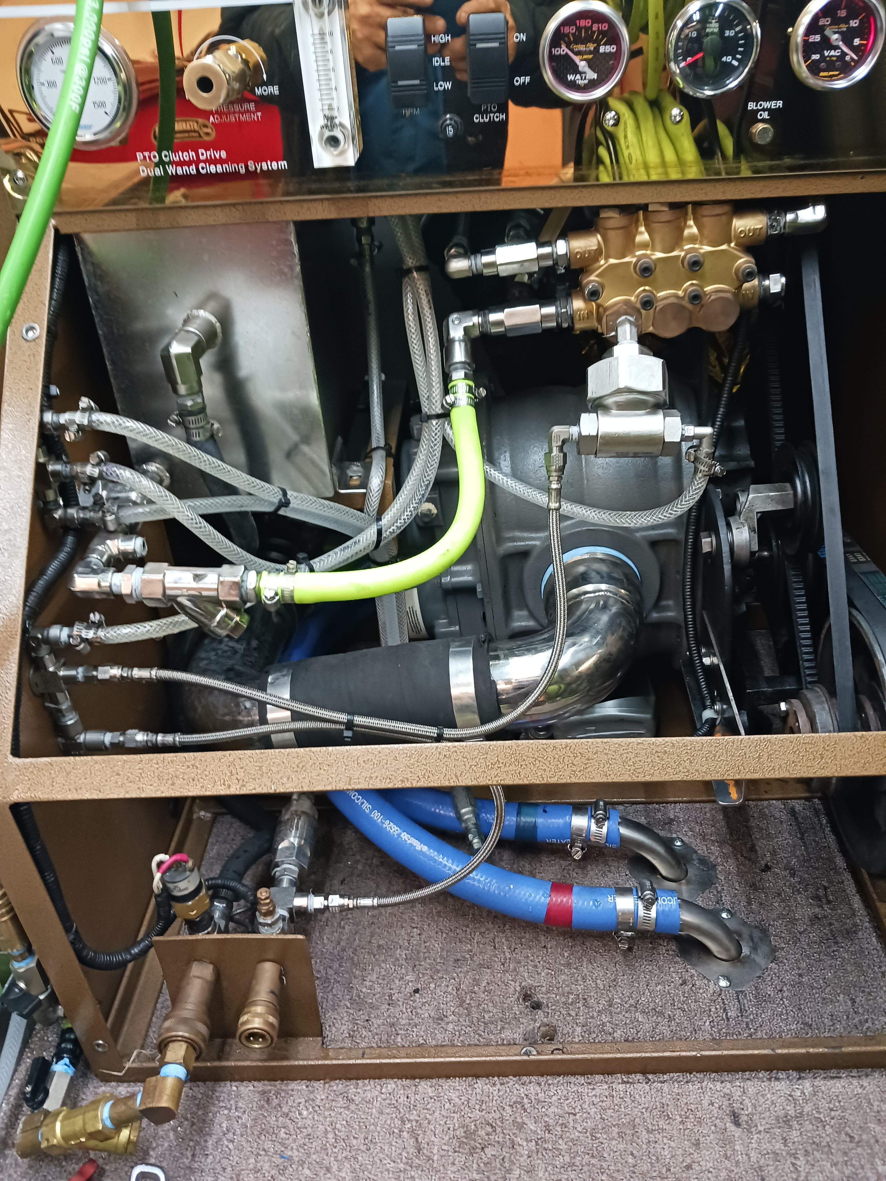

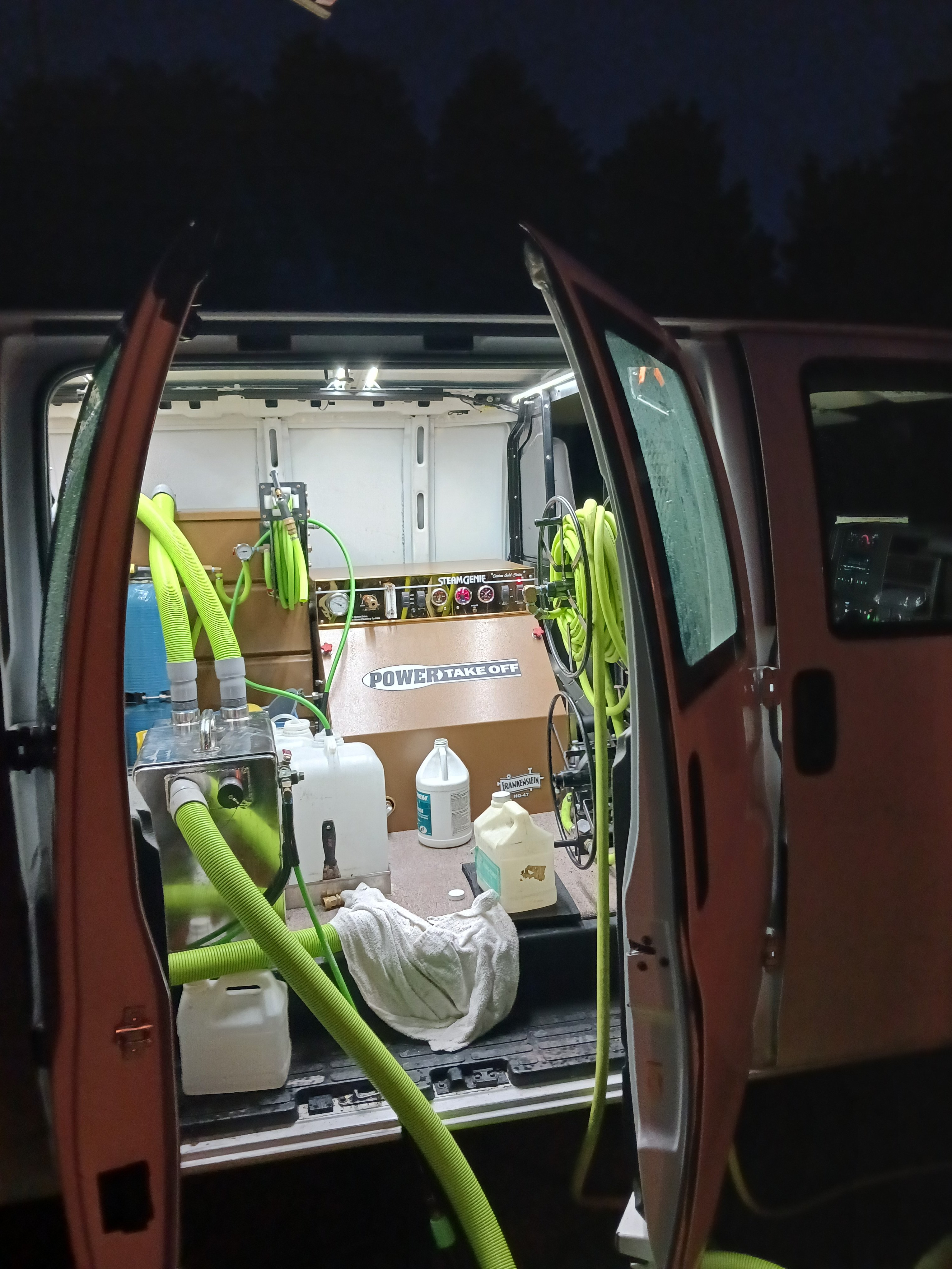

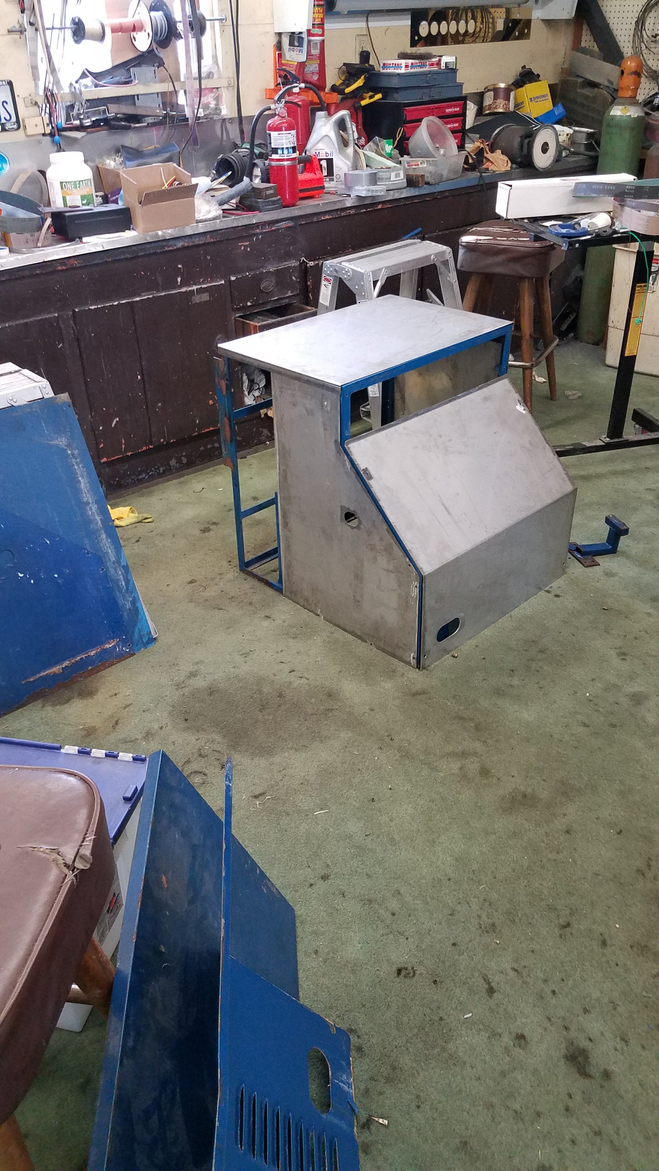

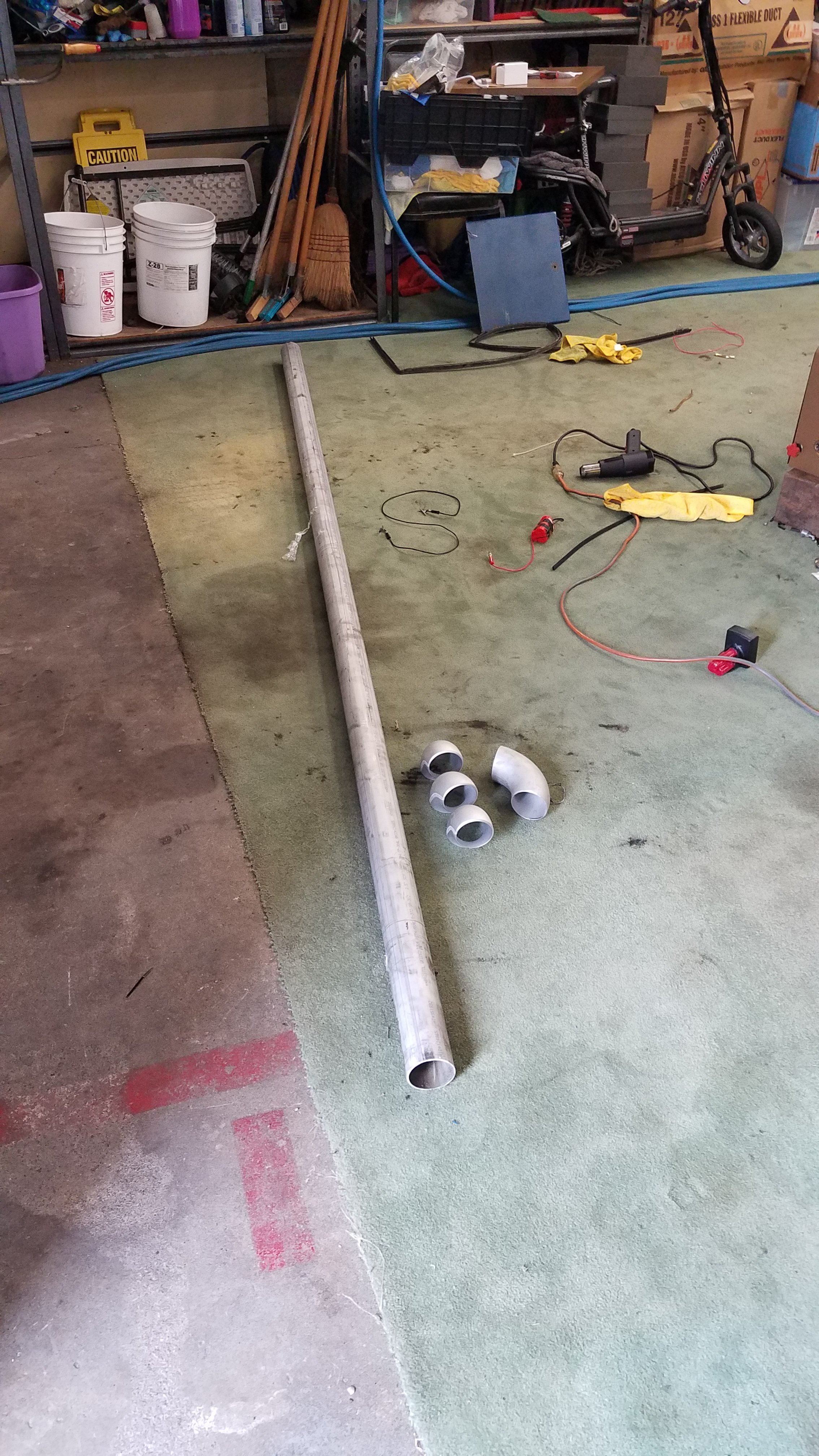

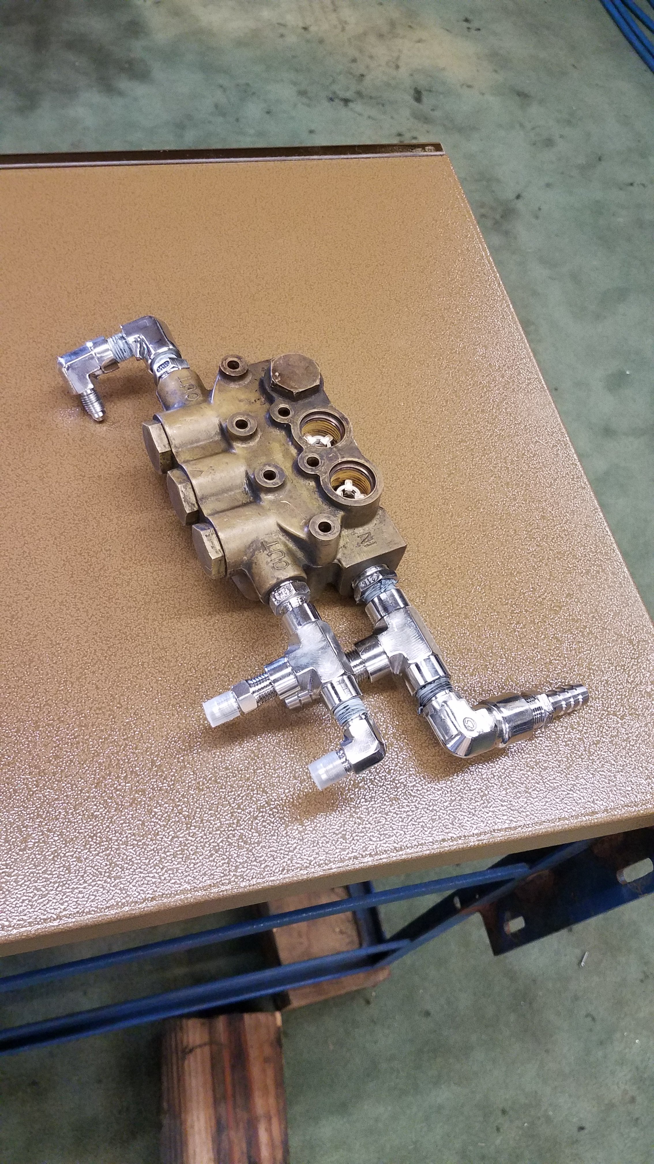

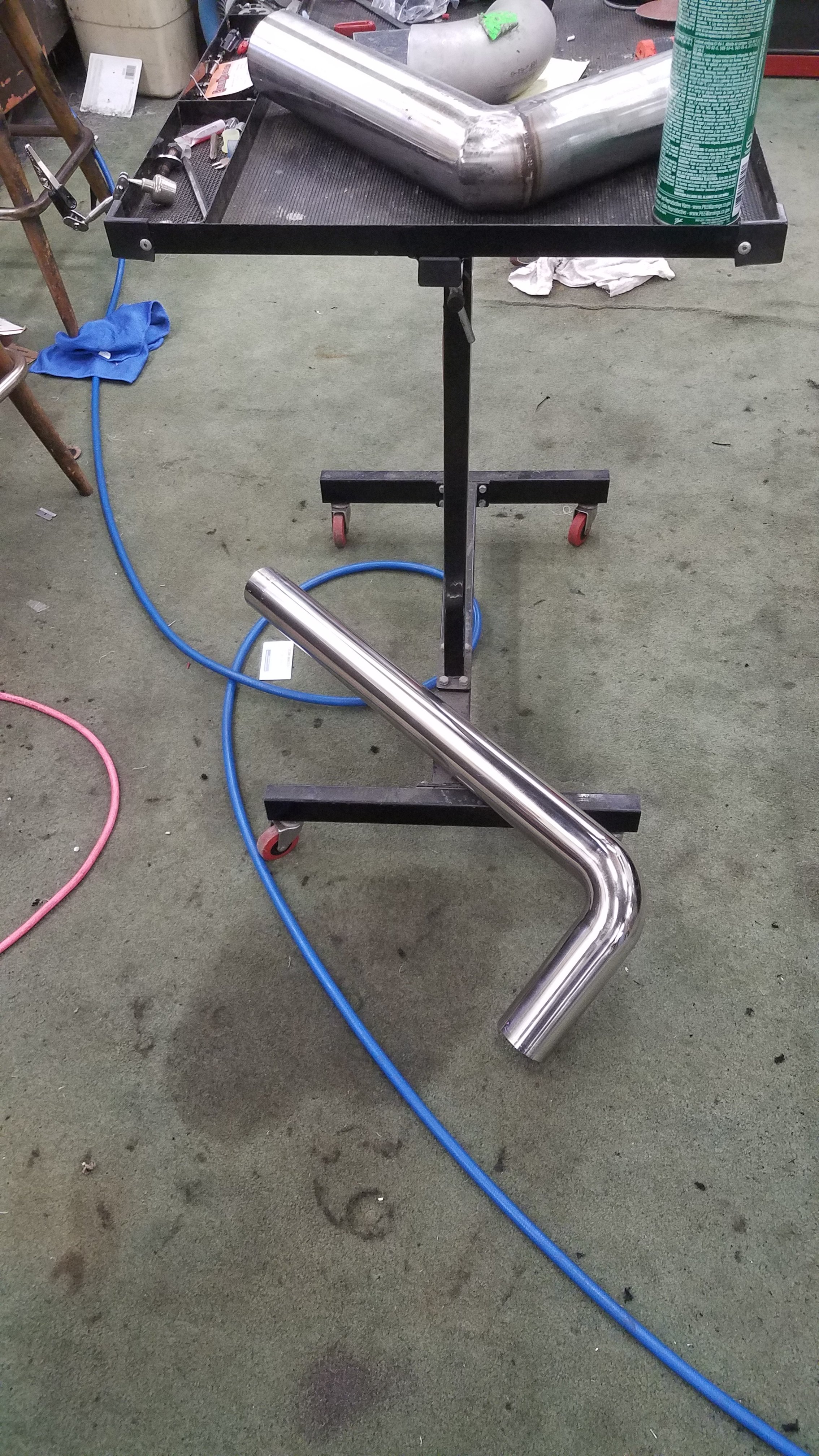

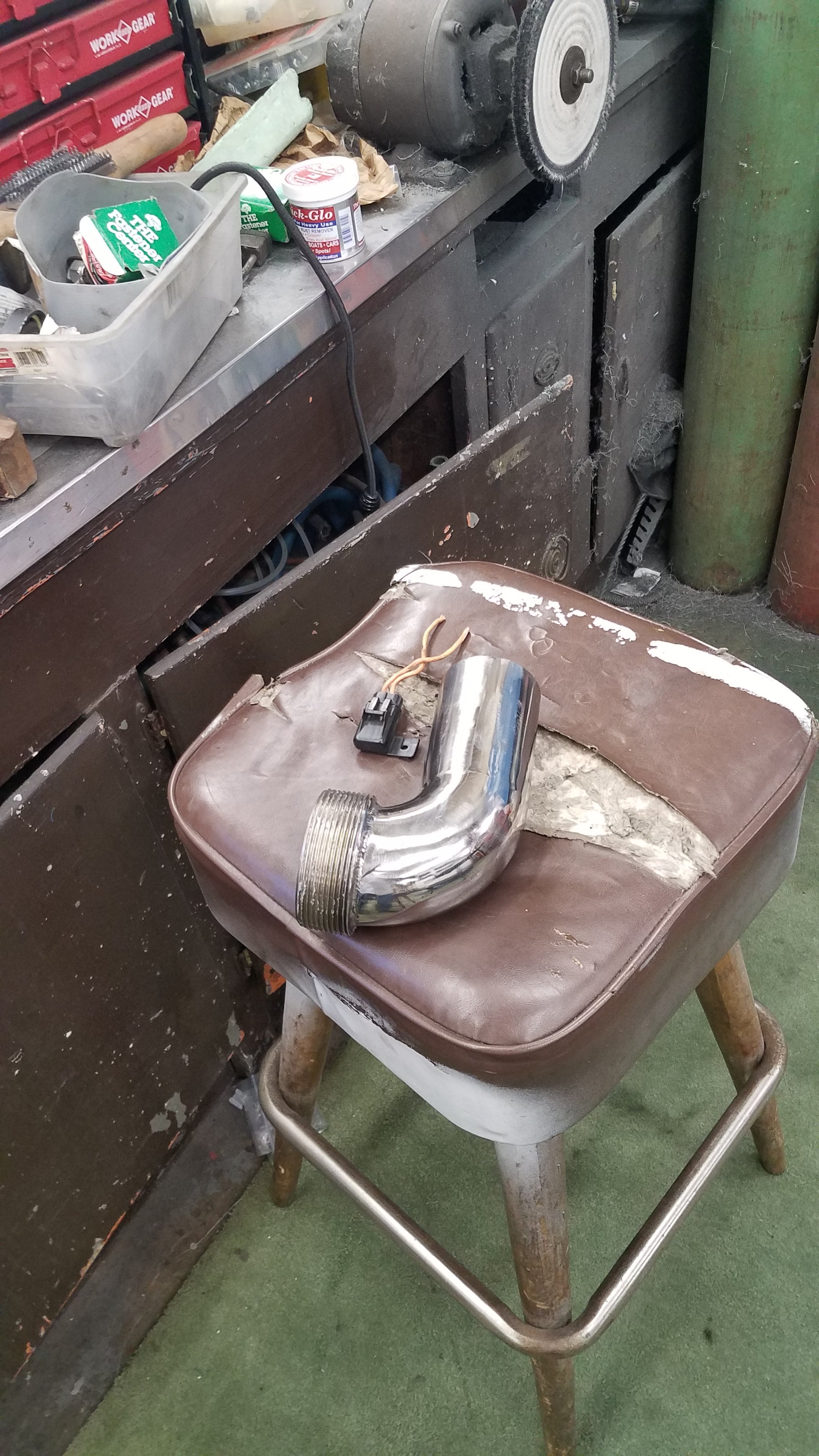

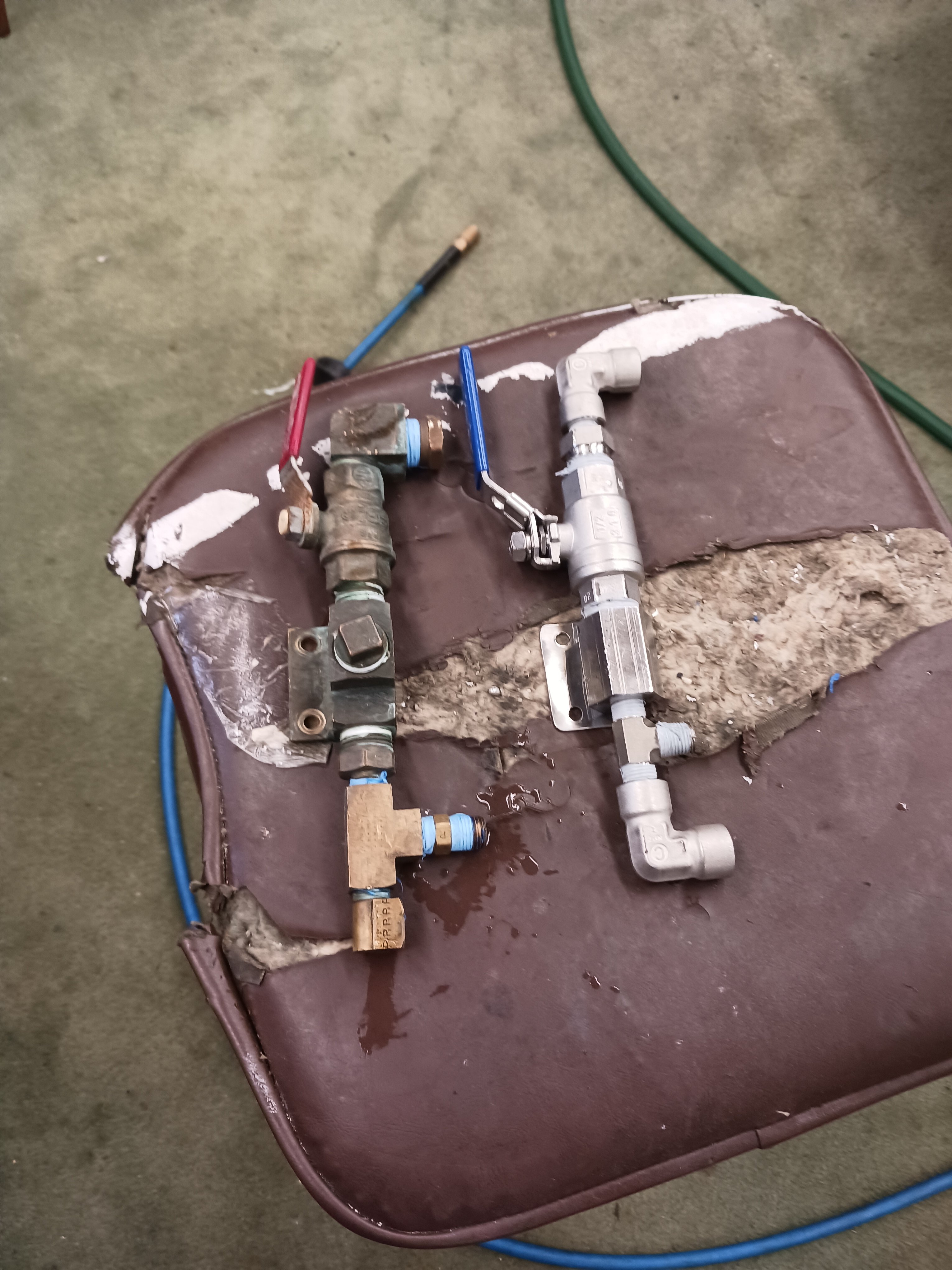

Why not build your own? I did , i needed a machine to do tile and grout cleaning. My 2000 steamgeni pto was and is still a highly reliable machine, but it's heat exchangers wouldn't handle the pressures and its installed in a 23 year old van. I went looking for a replacement what i found was for 35,000 i could get a great machine but it's life expectancy was about 10 years, replaceing a perfectly good 23 (20 at the time) year old machine with 1 that would only last 10 years rubbed me wrong. My supplier convinced me into building 1. I Took all i didn't like off my machine and replace it with better. When John DeLorean built his car he designed a body and the rest of the car was off the shelf parts i decided to take that route, first obstacle was the drive, i really didn't want to engineer that part, so a couple trips to trade shows i landed on butler but they wouldn't sell me the parts so i went to cleanco bought their frontend install kit modified the bushing for steamgenis larger diameter driveshaft, next was heat exchangers opted for cleanco's new high pressure ones and a hydramaster salsa unit for that little extra heat, got rid of steamgenis fill valve (always leaked) up graded the 45 blower to a 47, got rid of the 100 gallon waste tank went with a steamgeni 50 gallon stainless instead. Replaced aluminum vacuum relief with a custom built stainless, added a chemical pump instead of starvation system replaced every brass fitting with stainless replaced outer steel tins with stainless chose a powdercoat color as close to the dirt on my old machines waste tank so as to always appear clean wired 100% marine grade tined wire with delphi connections,installed it in a 2020 van and done . I have a very powerful highly reliable machine that is easy to maintain can be practically rebuild using a screwdriver, crescent wrench and a pair of pliers,(that's really not an exaggeration) and with reasonable maintenance should last 25 years. Also added waterpond comet waste pump custom crash screens , filter box and shelfing and a great lighting system, to hell with them over engineered pieces of crap their pushing on us, i say if you can do it find an older machine from the "golden years" like big red or something and if possible build your own youll be better off in the long run unless of course your so big that your tax advisor says you need to throw a shit load of money away or lose it to the government then by all means buy the crap out there . If your interested in seeing what ive built I'm always happy to show off Frankenstein and have over 500 pictures of the project

Coming from someone that has built and refurbished more machines than i can count it really doesnt cost that much more to go stainless (frame, lines, tanks, etc) not when you consider the headaches it would save

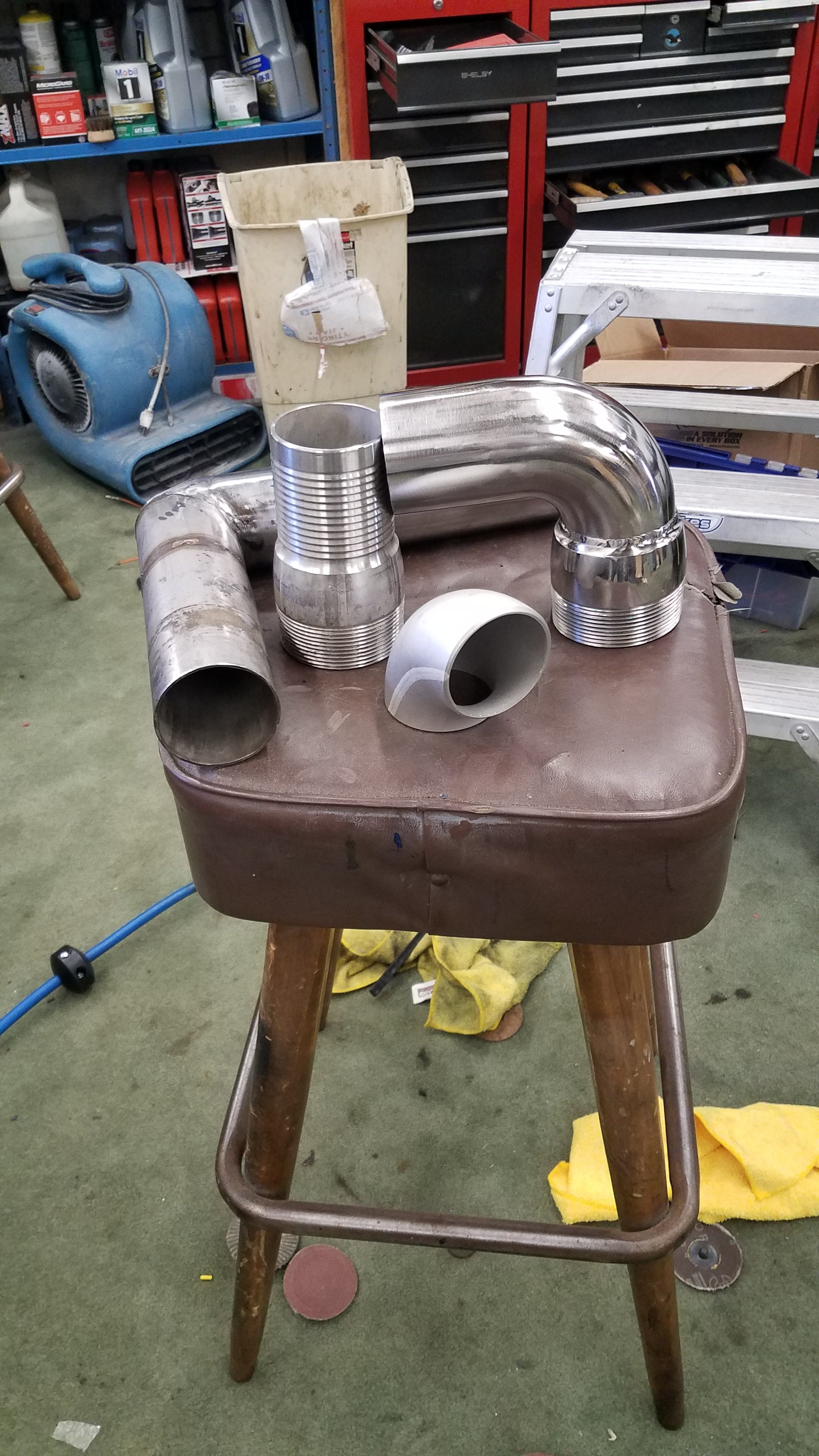

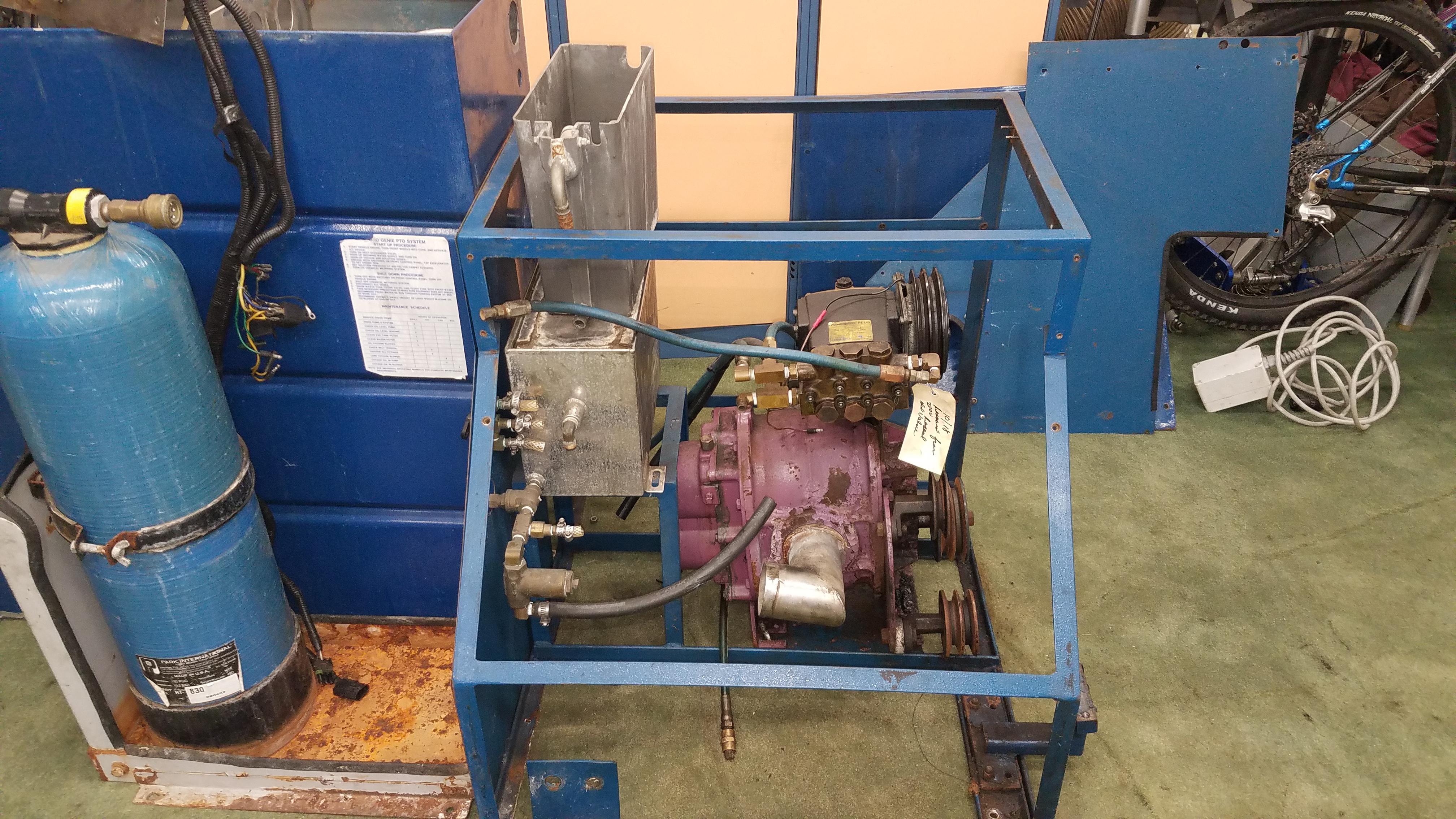

I agree and disagree being a person who resently built one most stainless cost about double over steel or aluminum however anything that has to be machined can cost considerably more because of the time it takes to machine harder metals but when it comes to pipe and tubing your looking at 4x the cost of steel and fittings on average they cost 7 to 10 times more than brass i spent around 1,500 just for 1/4 &3/8 stainless fittings on Frankenstein however over the life of the machine if you consider down time for repairs it is a bargain because unlike brass aluminum and steel the stainless won't corrode it generally only fails due to metal fatigue .
View attachment 120586 View attachment 120587 View attachment 120588 View attachment 120589 View attachment 120590
When are you gonna produce more of these? Can you find an investor to partner with you?

If or When i need another one.the problem with building something for sale you have to warranty it and sometimes warranty others stupidity , you build a machine, install it in a new van and the dipshit runs it with no oil and burns up the engine who pays?
now firmly in my 60's I'd rathet have something no one else has than what little money id get for it, however willing to help others do it for themselves

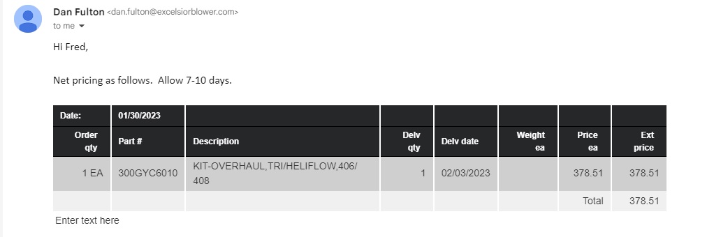

I was considering getting a rebuild kit for my TI410, but they were a year out on back order. Douchebag move you guys pulled on that.
did you have a part # on that? Only chart I found showed the same service kit across the TL406/408/410 range but I don't know how accurate that is
if it is the same excelsior has Overhaul Kit 300GYC6010 for $378 and 7-10 days on the quote they sent me.......but it only says (406/408)
14,266
I never looked up the part number. I was talking to the same blower company on the phone in Memphis who you have posted above that I’ve purchased from in the past

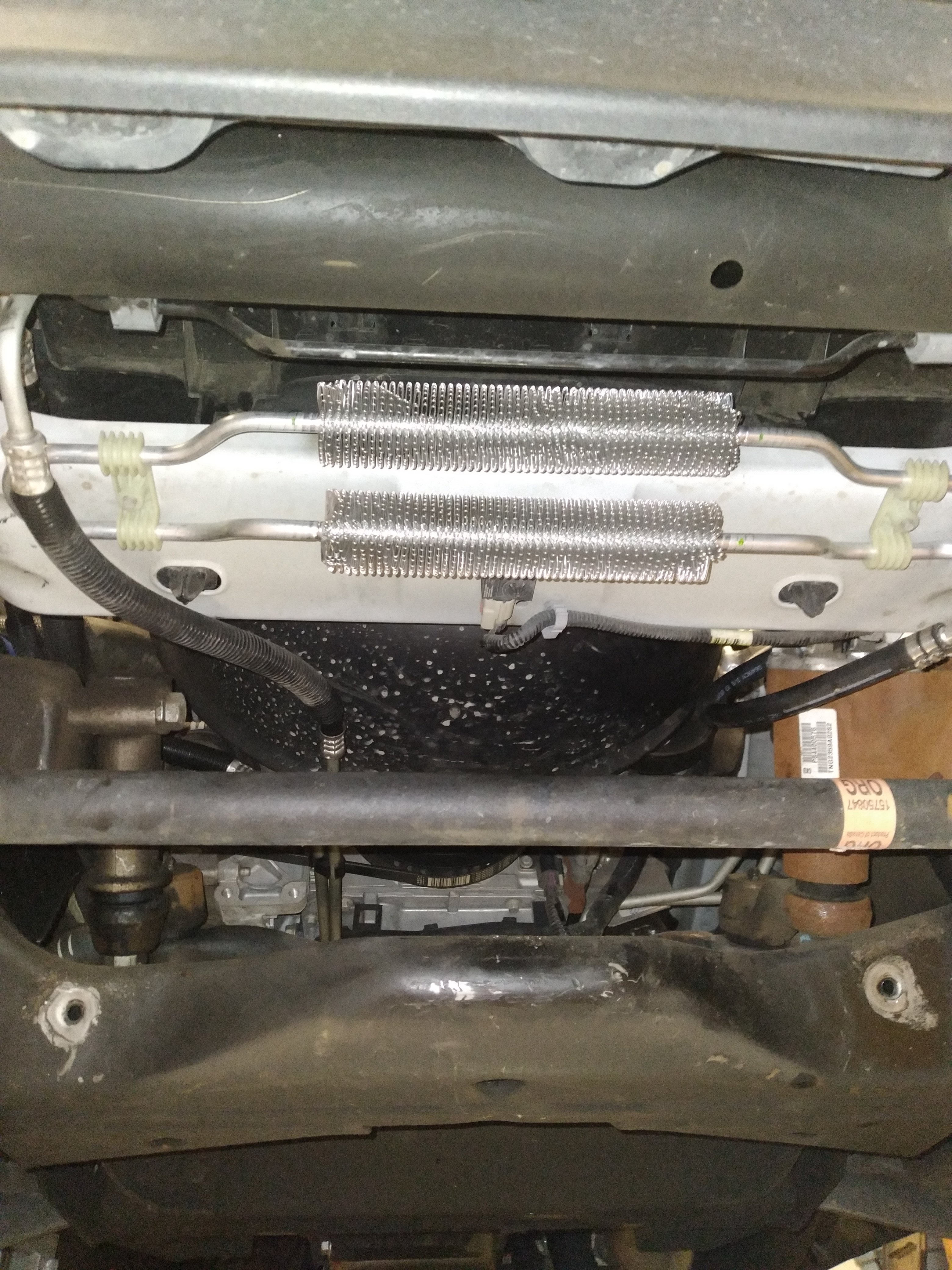

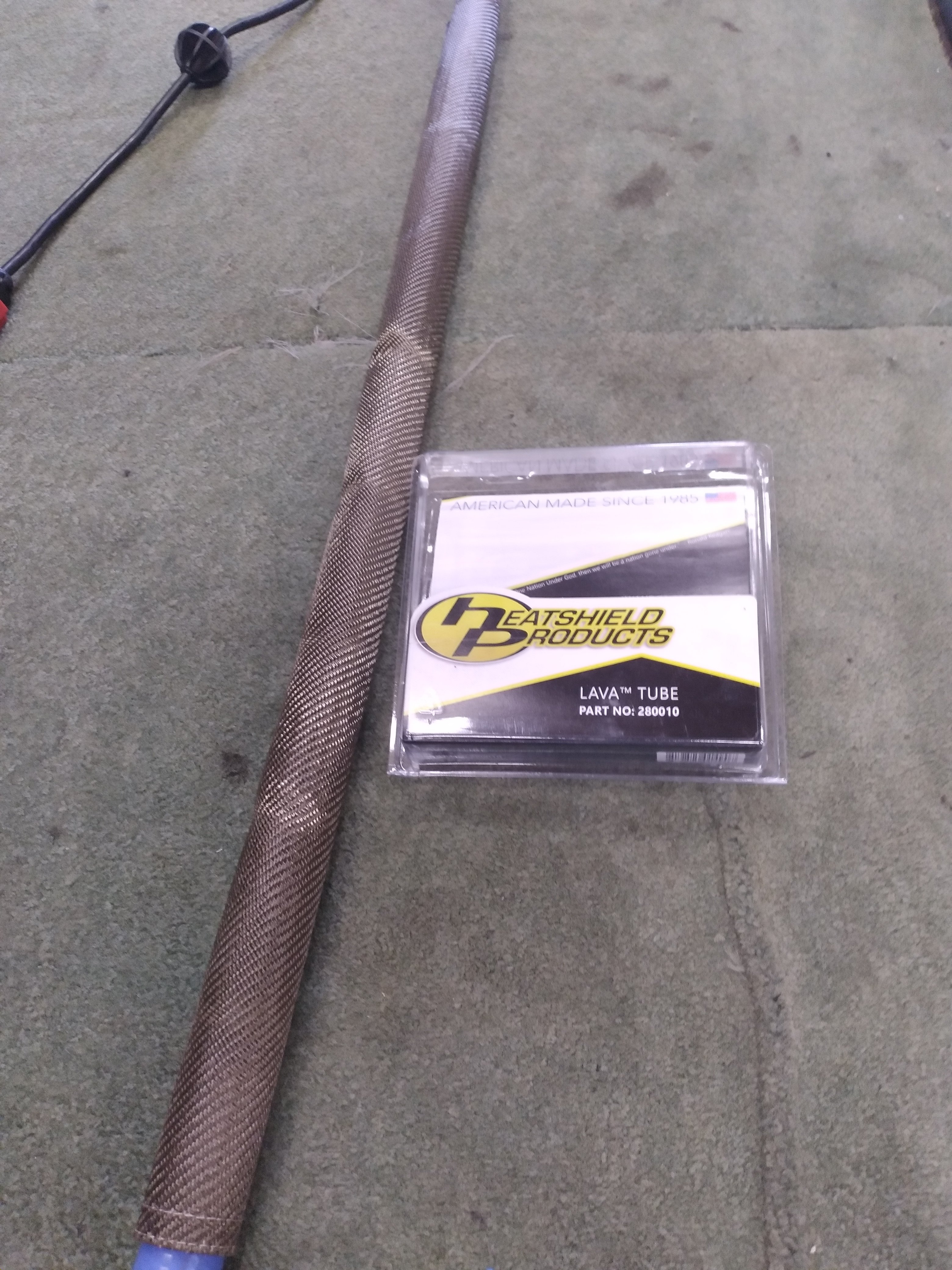

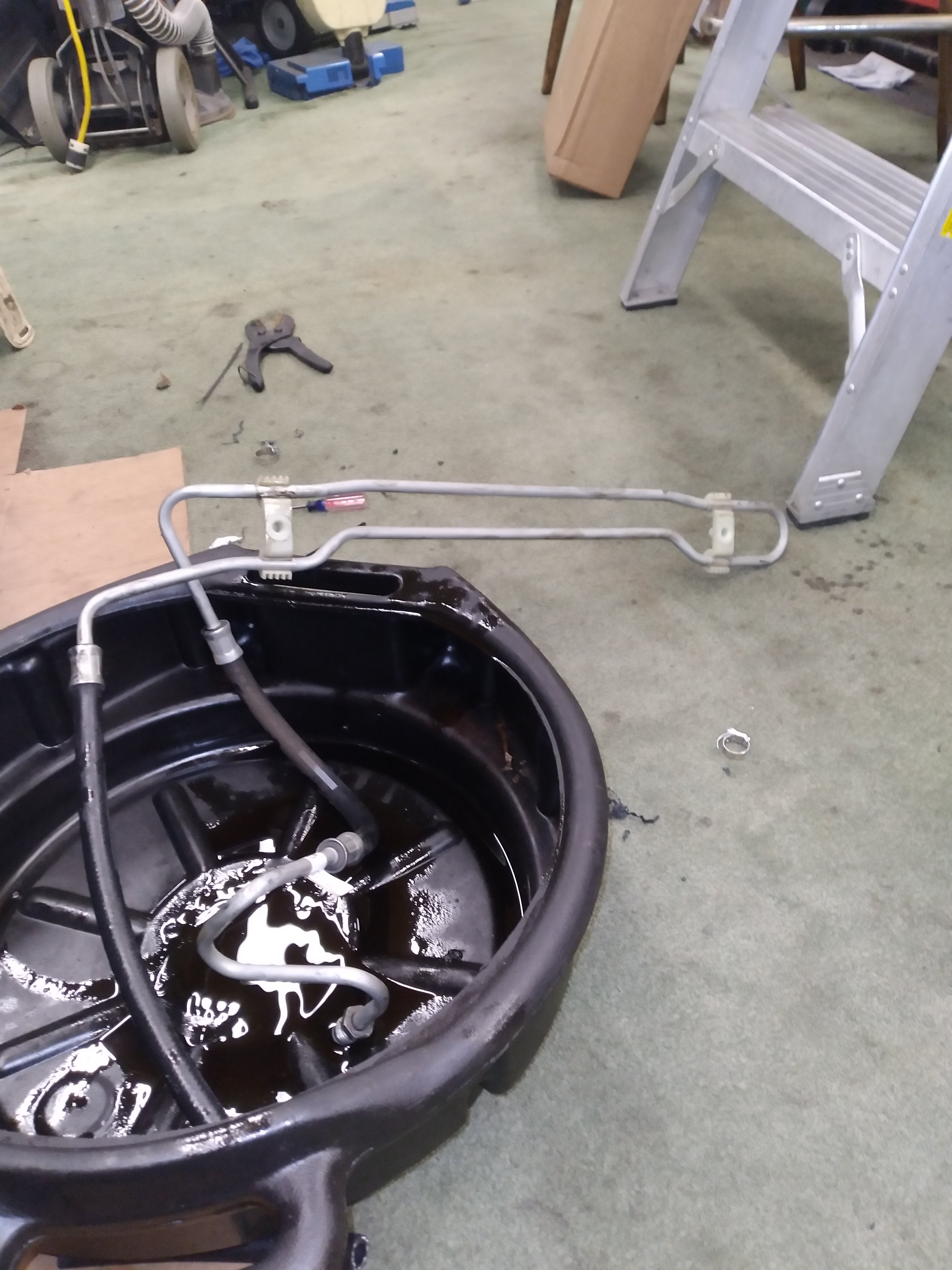

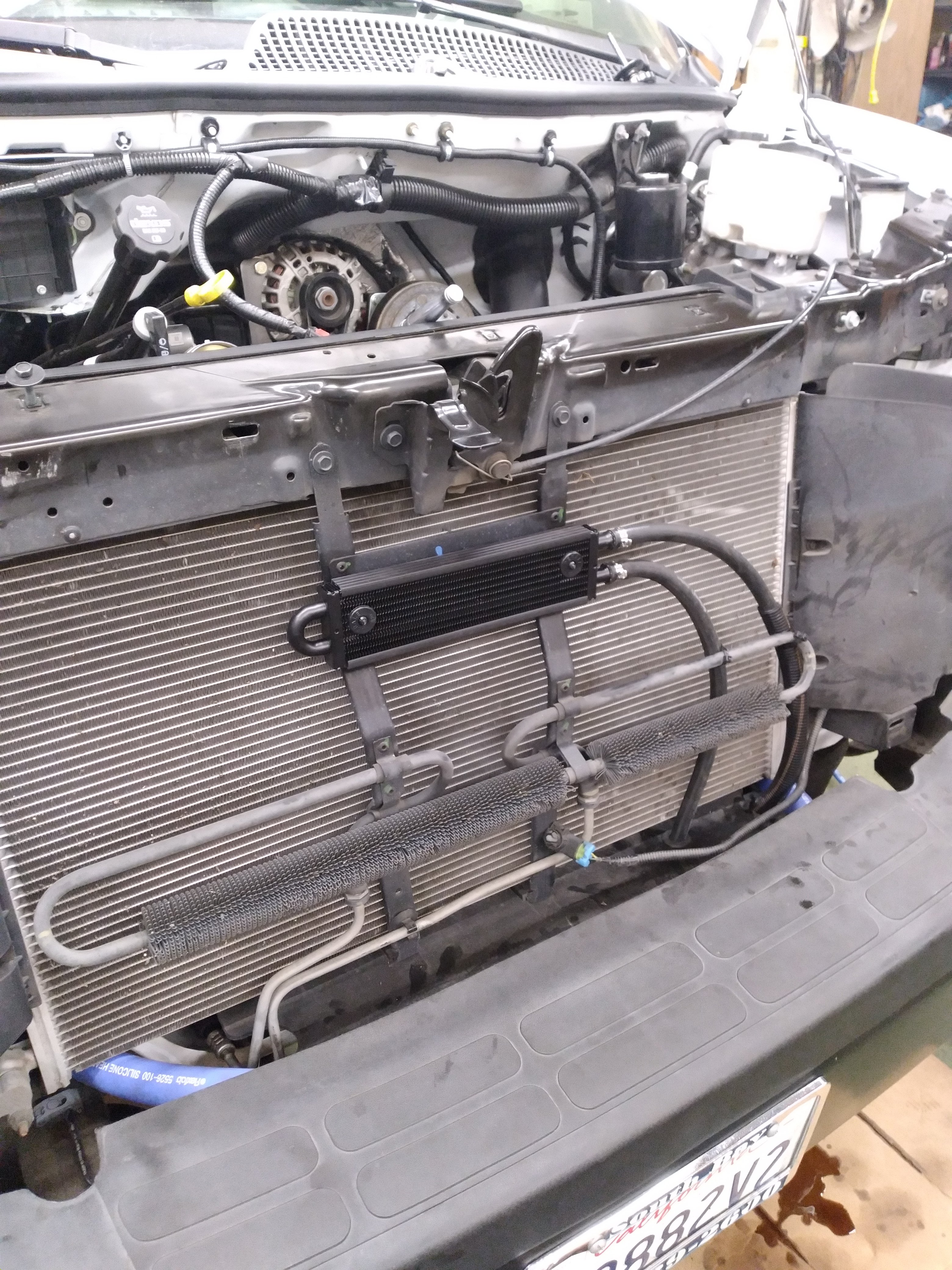

If you're considering pto's over slide in, heat is a consideration, i bought an entire fleet of steamgeni pto's from a company in Sacramento, the 2 problems that most of them had in common was due to #1 lack of maintenance and #2 heat . When the machines are running the vans engine rpm is at the equivalent of approximately 35mph however 35mph winds are not moving threw and underneath the van as designed . In Sacramento where these machines came from it reaches 100-110° during the summer common problems with vans were burnt spark plug wires brittle wiring harnesses, power steering and hydraboost leaks and failures fuel system problems and shorten transmission life span etc etc. I however live on the coast my shop within site of the ocean advantage year round temperature about 59° and highs around 72° in the summer not so much of a problem. When building Frankenstein and designing to eliminate future problems a few modifications were made to the van to address the potential heat issue #1 insulation on spark plug wires#2 removal of power steering under van pipe and replaceing it with factory severe duty cooler and also adding additional aftermarket power steering cooler with filter lastly adding severe duty transmission cooler. Adding these things at the time of pto installation has greatly reduced the under hood heating problems and i highly recommended anyone considering buying or that owns a pto to do these simple modifications it'll save you alot of money and eliminate alot of future downtime. These modifications i do where temps are low and find more and more important the hotter it gets outside you guys with the leaky power steering systems probly already know what im talking about anyway it's a thought ounce of prevention is definitely worth a pound of cure
