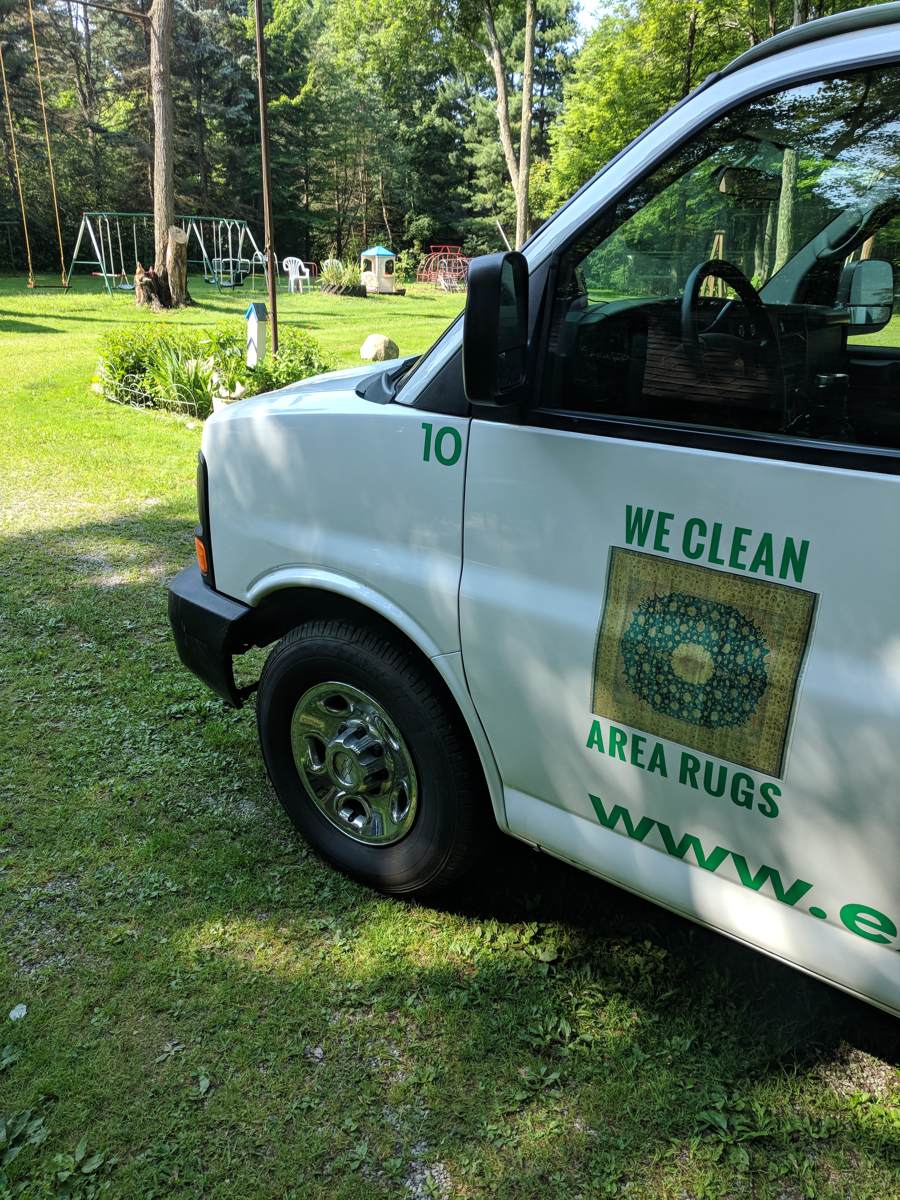

9.5 years and 12000 combined hours on the van engine (6k on the CDs), never had the hood up. It consistently gets to 90 and above here in the summer
