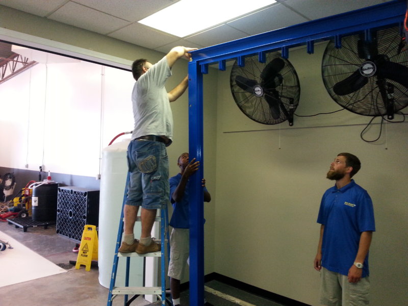

We have about 3000 cubic feet in the dry room.
We are drying over night with 2 450cfm B-Air Dehues and 4 Air King 30 inch fans that are wall mounted.

Ray's been kind enough to let us test one of his blowers.
