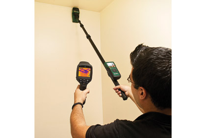

Steven have you see the non destructive meter that has the electrode pad on an extension pole coming back to the meter? It allows you to stay on the floor and off a ladder. Looks like it would be excellent for commercial work. I saw it in a magazine but it's at home. I'll try to remember to bring it tomorrow and scan it.

Rich - Look forward to seeing it. I have not seen, but heard about it recently. I would think it would be great for commercial, or even on 10-13' ceilings. We use to run into a lot of sky lights leaking around the edges from ice damming. Man I hated getting up on a 12' ladder with awkward angled ceilings.
Are you considering buying one ? Who makes it?
A planet far far away
Yes I'd like one but I just glanced over the article and didn't see a brand name listed. I'll bring it in the AM and scan it in and post. If it works, it looks like a very handy addition to inspection tools.

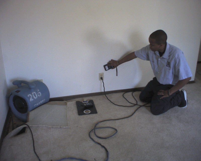

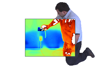

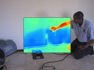

Thermal Image (IR) cameras read temperature differential, so while it shows up as a different color you still need to confirm it with the other two meters. Where it helps you is when it comes down from one level to the next, it's not always obvious unless there is a stain. It also helps on larger projects when you have multiple rooms or commercial where you have large sq/ft affected.
It directs you you confirm it and then you don't have to slide the nondestructive along all the wall space or probe everything. They are time savers, money makers in that they help sell the job by showing the true scope of what is affected. You can also look much more professional than your competitor that doesn't own one.

Dave - The thermal imaging camera will show temperature differences. A cooler area MAY be the presence of water, but not necessarily true. For example, look around door and window frames its normally cooler there than other areas. Also where the ceiling meets the wall it typically will too because of poor insulation.
The thermal imaging camera helps with the guess work of where water may be, but you should always confirm your finding with other tools, such as non-intrusive moisture meters, hammer probes, electrodes, ect ect.
When you get your handy man service off the ground, you can use it to find poor insulation jobs, and can use it to easily sell insulation removal and replacement. Or possibly replacement of windows and door if you're going to go that far. I've done that in the past and called it a "Home Energy Audit".
When dealing with mold - the imaging camera can give you a good clue and see "into" walls where a leaking pipe may be if the source isn't known. It sure beats going around an entire room on your knees with a moisture meter hitting a bunch of dry spots.

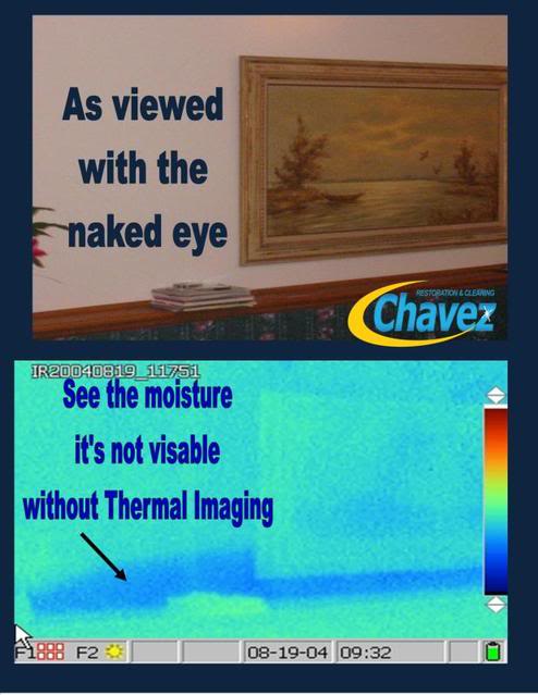

It doesn't have to be the next purchase but it needs to be somewhere near the top of your list.
See how without it we wouldn't even know to look there. Yet with the camera Greg is able to go right to it to check with the nondestructive and he can stick his pins down near the baseboard line or completely remove some base and check with longer probes to see if the insulation is wet in the wall cavity.
