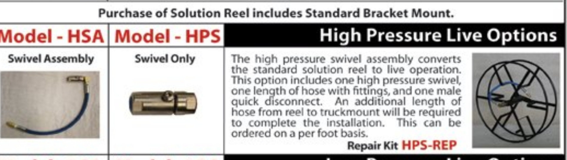

I'm considering converting over to live solution hose on my reel
14,275
My main concern is how often do you replace that 250-350ft of hose? Because I replace 1 section of my hose 75ft once a year. If I have to replace all that hose every year... no way
And where can I get the hardware to convert it without getting ripped off $$$

300ft in multiple 75-50ft sections that I have to disconnect from the reel and connect to the machine. I'm wanting to do away with all the crimps and QR's and just run one long 300ft. hose on the reel and have the hardware to make it a live hose always hooked up the machine.

Just don't leave it on the spool to build heat and cook your hose. It will last fine if you unspool most of it each time. So just don't stick it all on the spool, hang the extra that doesn't get used that often. Make sure that section also has a ball valve so when you need to use it, just pop it on the front end.
Rokan had a conversion kit at one time.
