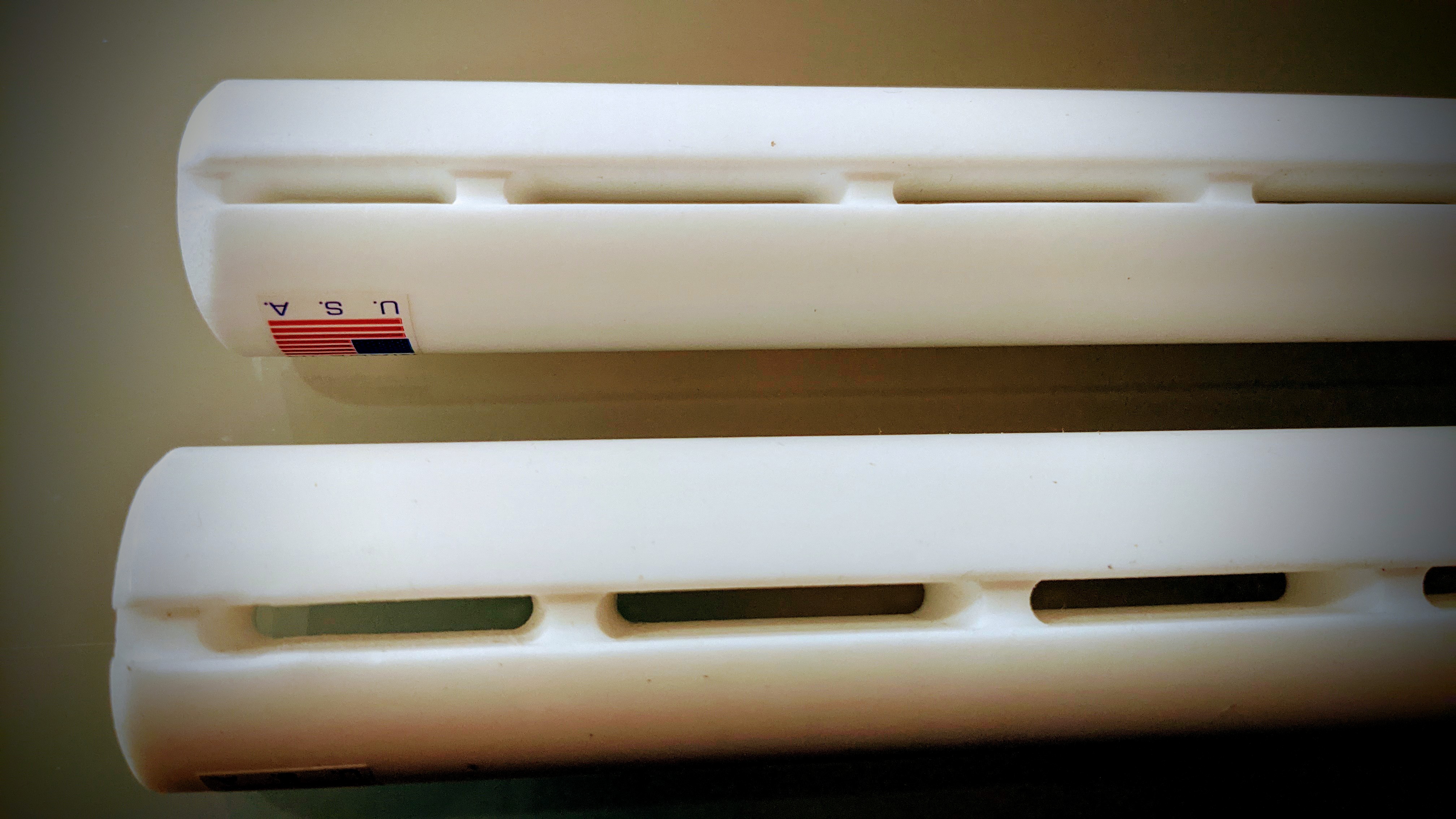

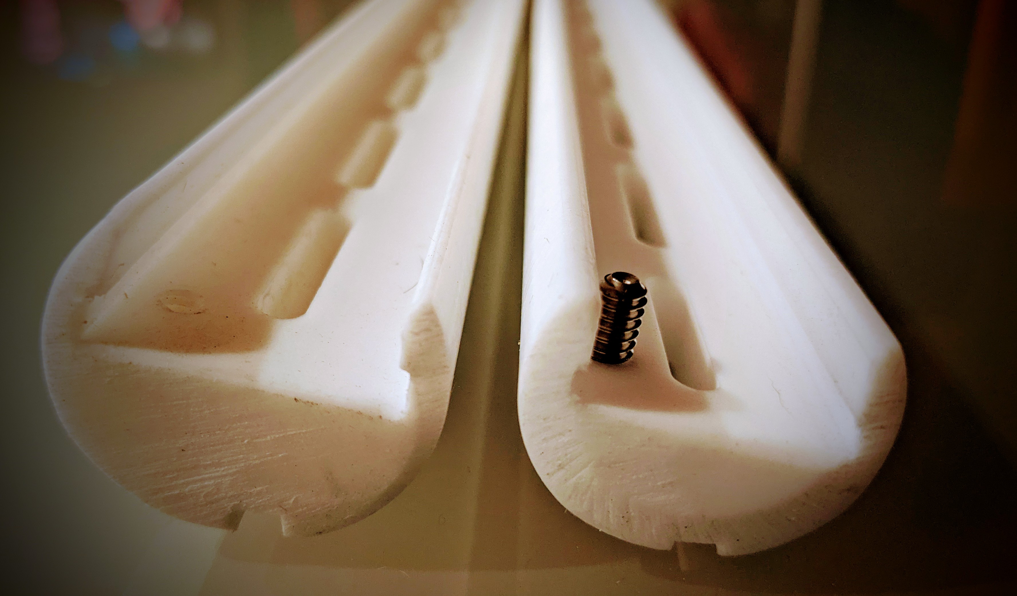

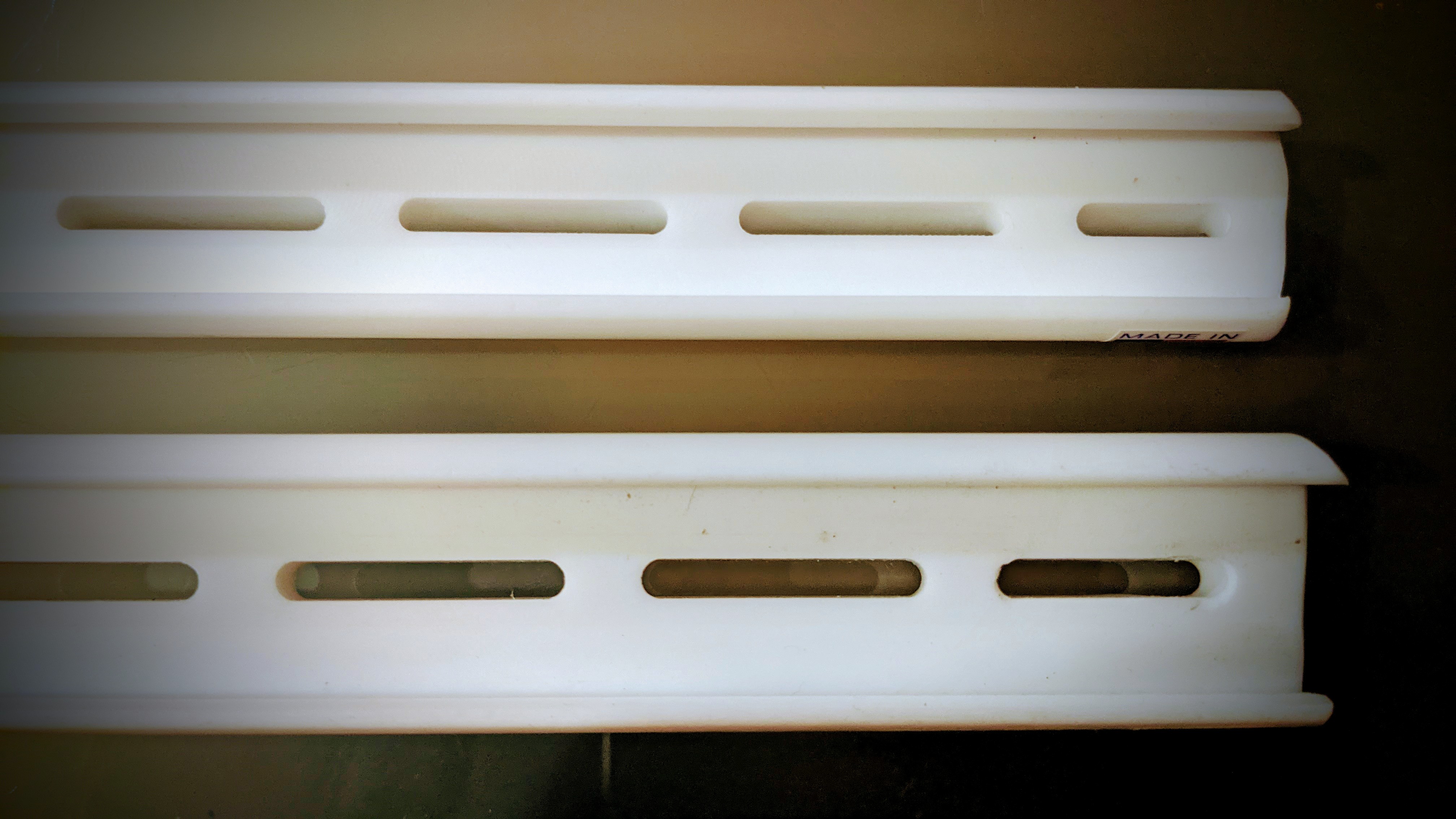

That is our "slot" glideWhy is it no one likes straight slot across...
I'm not a fan of stopping to clean a wand opening orifice for no gd reason...
Straight slot,if clogged butter knife crap out keep moving...
We want the Teflon slide,the holes an slots make no difference.
One step forward two steps behind...
Where is data on slot,hole,straight air flow results...
I was skeptical of the water recovery due to its narrower slot
I thought hole glides extract better and slot glides are for those who don't prevac. A summary of the characteristics, advantages and disadvantages comparison of each glide would be helpful here and on the
GG website.
How much harder for an old man is a slot glide to use? The single-piece PMF slot glide that came on my Mach 12 was difficult to move, but the slot is wider than the GG slot appears to be. I got the M12 because I was having shoulder trouble and it was the lightest wand available. I replaced the PMF glide with a GG hole glide.
One of the differences between the pmf glides and green glides is that the pmf glides are very flat and that is what causes the lock down. The green glides are rounded and present less surface area to the carpet which makes it easier to move. I have a 2 inch titanium wand made by pmf with their flat Teflon glide that is almost impossible to move with a 47 blower. I also have a steel westpak 2 inch wand with a green glide that is a joy to use with the same machine.I thought hole glides extract better and slot glides are for those who don't prevac. A summary of the characteristics, advantages and disadvantages comparison of each glide would be helpful here and on the
GG website.
