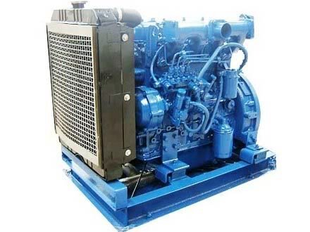

1. 65 hp DIESEL ENGINE. <img src=pic's

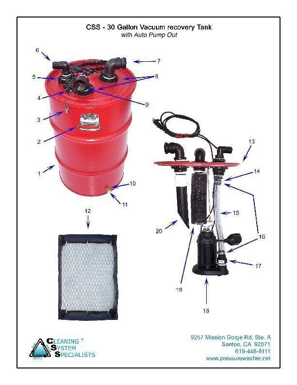

3. 2 30 gal waste tanks <img src=pic's
> ( I have tested these at 18 hg and they work fine)

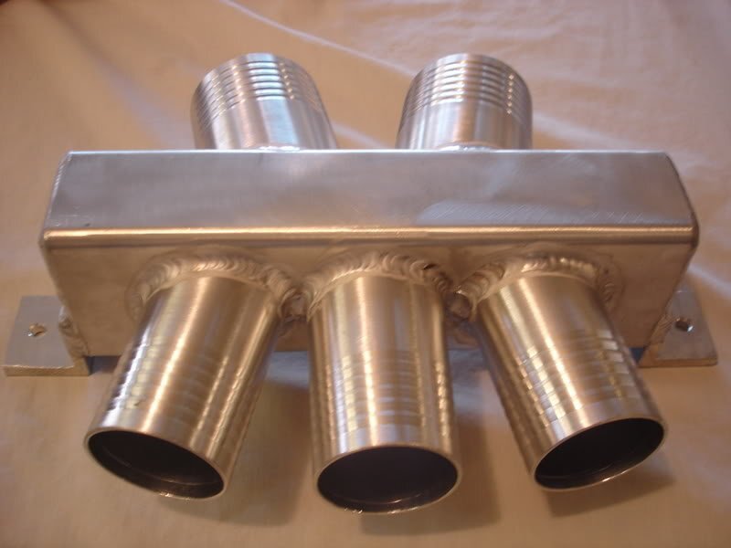

Greenie says that he is going to have some glides and other fixes for the rotovac. I’m going to purchase a high flow wand 3 inch Knuckle and the. Manifold<img src=pic's
> (2.5) and the y (2.5) from him also. . I will split the 5 inch Npt from the blower to the Greenies Manifold <img src=pic's addy > ( two 2.5 ) to two 30 gals waste tanks . Why because I’m hard headed and I have to do it my way.

Now that said, you mentioned capturing all your waste water for processing, I assume you are going to use a big poly tank that will be filled with these little barrel tanks and their pump outs?

You are absolutely on point I have two 550 gallons tanks that will be used for recovery...
I do a lot of industrial work and so I know the shop foreman and just about everybody that deals with plant operations , which brings to the reason I’m using the 4905 blower and the MTD engine. Because that’s what they are using and they have parts on hand to service them. Greenie they used the diesel engine on a generators and to power large pumps and other equipment the supervisor told me that they routinely get 10,000 hrs on the engines. The blower they run at 18 hg 24/7 and don’t use water injecting either. I was told that the blower cost around $3500 dollars; we made a deal to trade out some cleaning for the pump and mounting the equipment...

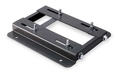

Greenie we are thinking about the following motor base
it will support 2095 lbs and this one
