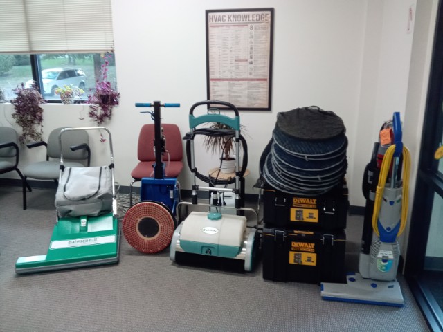

I love my 20 and 25 whittakers.
25'' must be a monster and close to $5000 new. How much does it weigh ?
I bought my 20'' Trio for $2500 used like new off ebay. New it sells for $4500

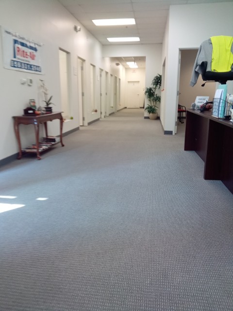

I love my 20'' Trio. 75 pounds plus water weight on top of 3 brushes. A super duper 3 brush CRB with a sprayer that scrubs incredible well and fast. It sprays a fine mist for real low moisture cleaning. Dries in 30 minutes. In that picture the halls in the back of the building were trashed. It's a AC and Heating business. In the back where people come into the offices from the warehouse the carpet is always trashed and some of the offices too. I do this business every 6 months. I used the Trio to scrub first and then followed with my Phoenix and Microfiber Bonnets. In the front of the building I just used Phoenix and Microfiber Bonnets. No scrubbing first needed. I put Releasit Punch in the Trio and followed with Releasit DS2 in the Phoenix.
