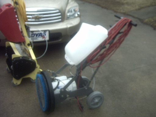

I like both velcro and bristle drivers for different reasons, they each have their pro's and con's but I liked the pad driver on this machine the most. CX picture.jpg

If you haven't already broken your pad driver in by running it a few min on some concrete then you need to do that, it will help not tear into your pads as much.
The larger orbit machines and bristle drivers are just going to rougher on pads, you need to try the pro cotton ironman pads.
