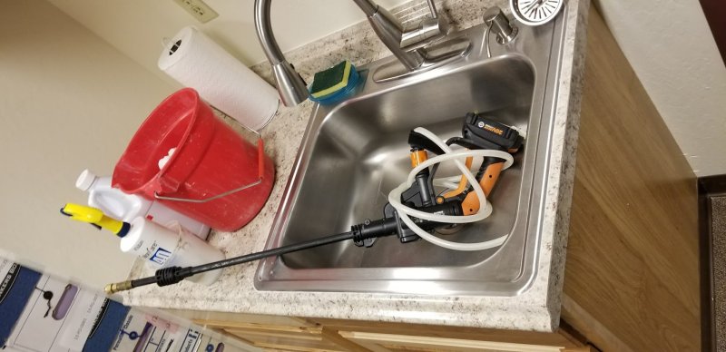

Late to the party...Worx Sprayer
116,511
change the tip out to a T jet...
Reactions: GreenTechAgain
May 16, 2010
1,191
Noble Carpet Cleaners
I prefer a 4.0/40 degree pressure washer tip in place of included tip, you can then rotate the spray/fan any way u want. Shorten the hose to way less then half the included length, it will then prime in just a couple secs. I like it on low speed with short lance for upholstery, on high with the full extension to prespray ahead for bonnet cleaning. Very handy gizmo.
