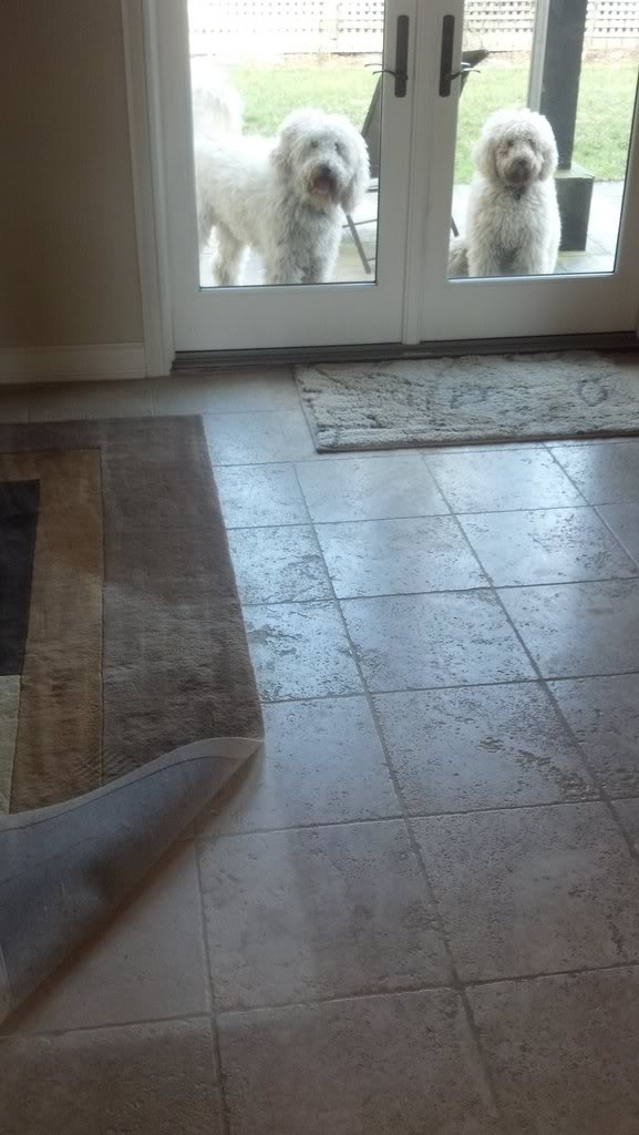

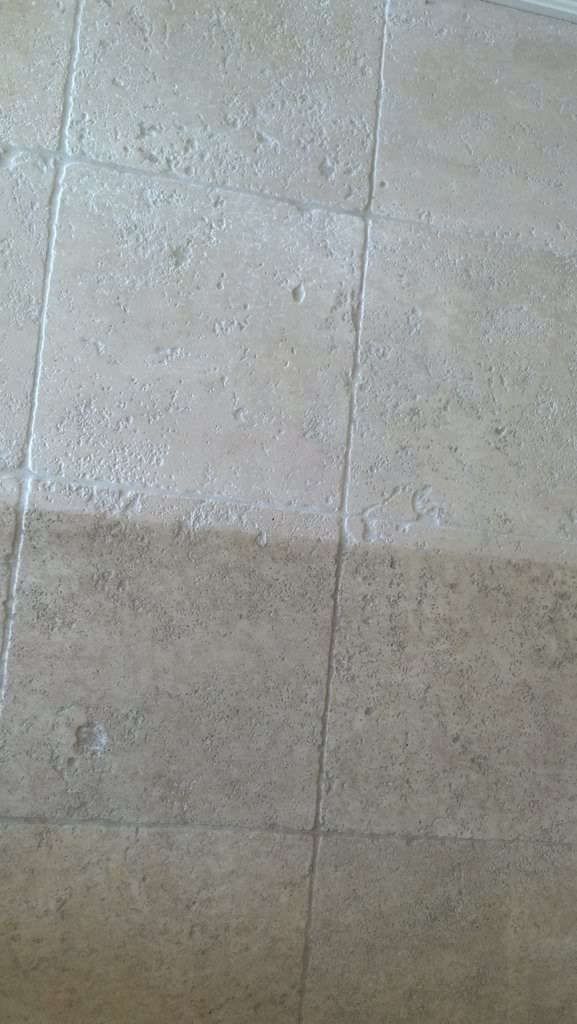

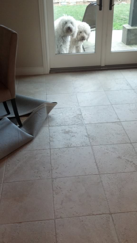

Loving my custom PMF tile tool..
115,995
We Dry Treated this travertine last year..
now with Magic Wand Oxy Blaster, a GLS scrub and a quick rinse it's as easy as this...
click pic to watch video
$225 in an hour and great custom retention considering they already paid us 2.50 a foot to clean and seal less then 8 months ago

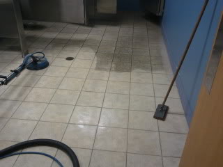

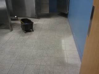

do they still get as dirty with the dry treat on there??
I got one place that they put in a pretty porus tile, in a rest room....in a warehouse :roll: :roll: :roll: :roll: :roll:
always cleans up nice when i hit it....but they want something they can mop and have it clean up....
and have me in every 6 mth instead of 2
I am thinking this next time i need to hit it with an acid cleaner though....
as nice as it looks in those pics....around the urinal, and sinks...its having some issues, and i have spot used acid, and it makes it brighter still

That looks standard for a warehouse restroom. If this place has forklifts there is no way your going to keep the restroom tile looking good unless you have people remove shoes at the door and stop dripping at the urinals.

i figured....but i was hoping there was a bandaid type fix for this....
why the hell they choose to put that in there i just dont know...
in fact can you see how ridge and porus it is in the pic???

I think texture is a better word for that ceramic,when you use porous,we assosiate that with absorbent which it is not very.The travetine he sealed is very absorbent so it can take a sealer.The culprit "is" the mopping crew as stated above.

oh they mop everyday, and while not a new mop, or if they dump buckets multiple times or not, i dont know...
but they clean everyday...
in fact you might get your TP from this place 8) 8) 8) 8)
They have to keep it cleaned up....
Looks like ill tell them they are SOL...
