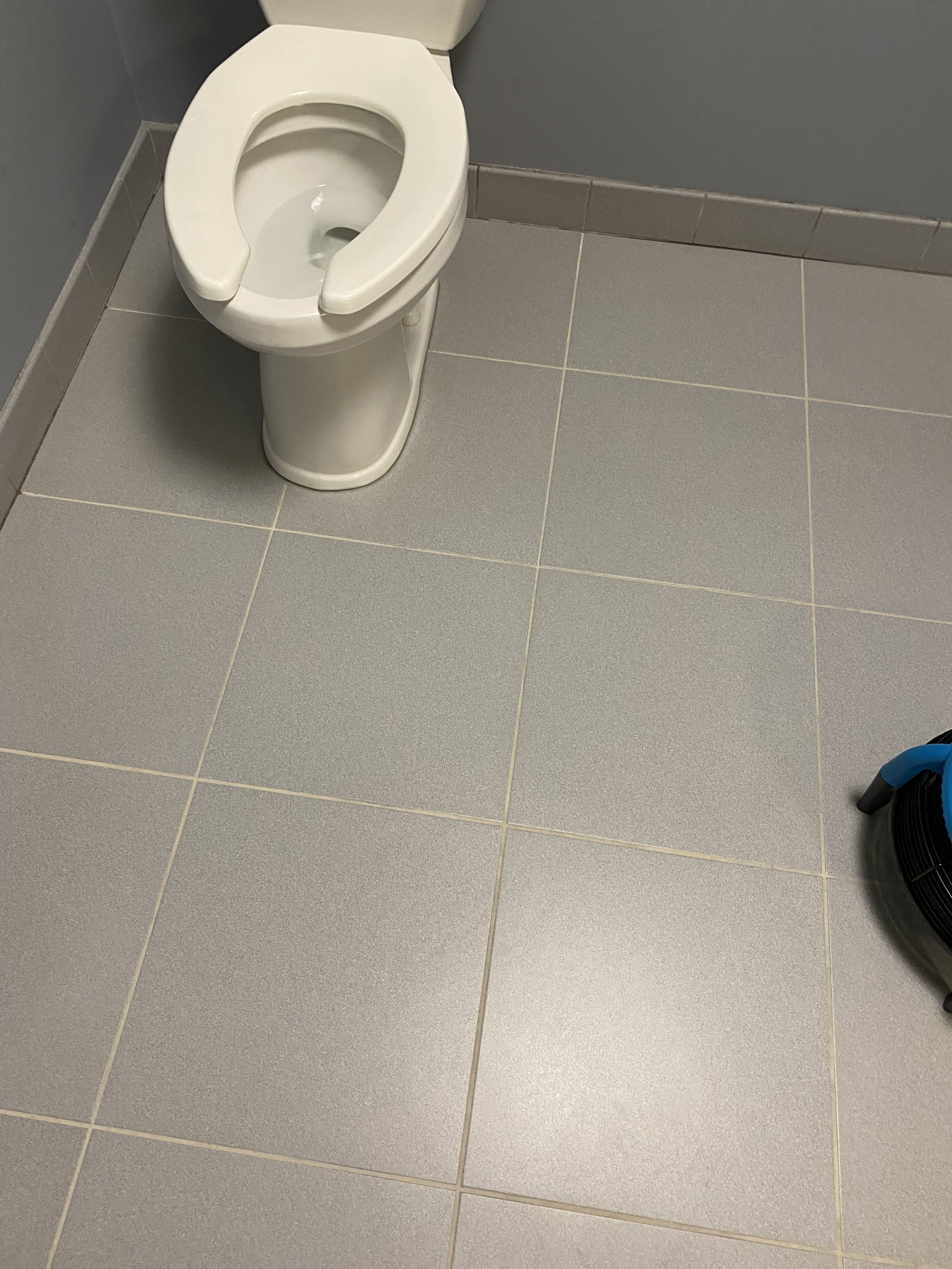

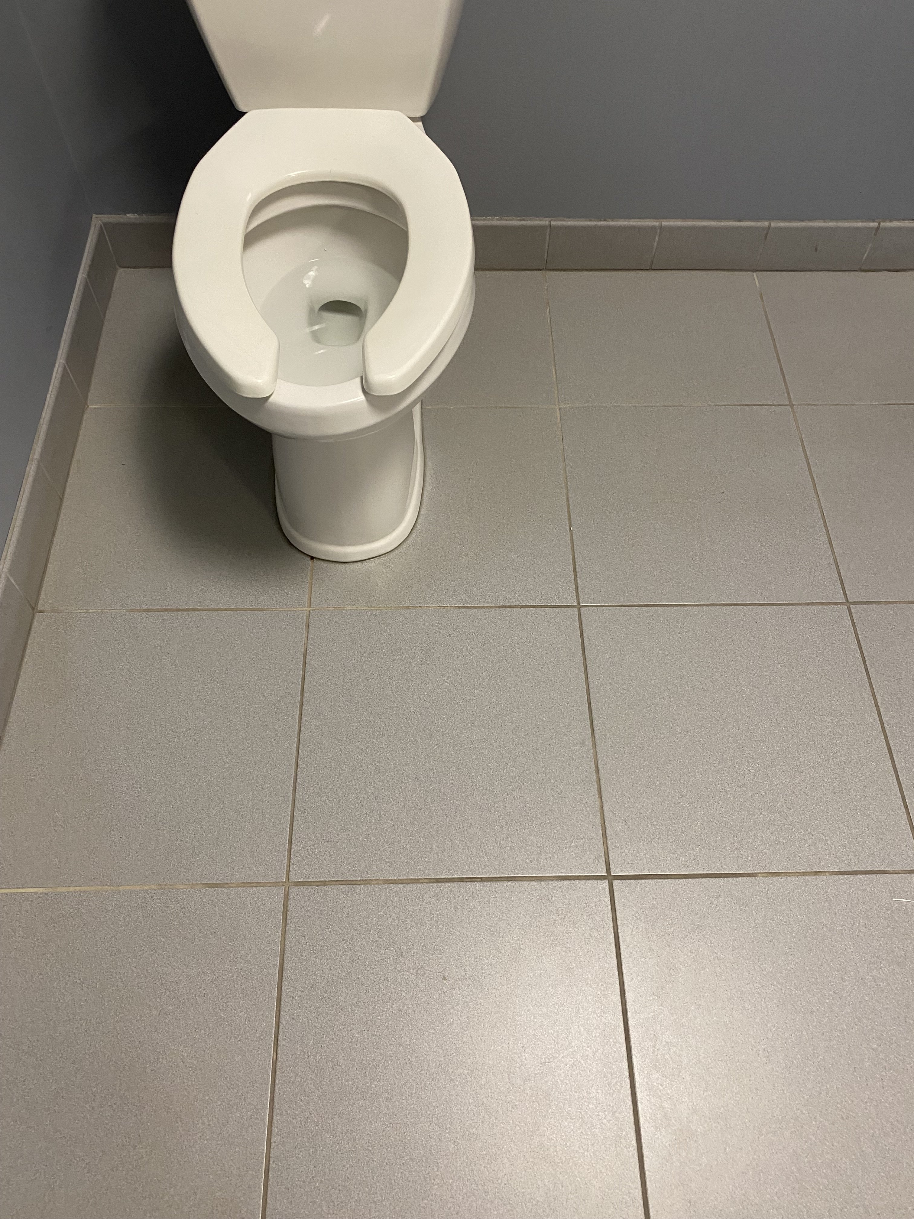

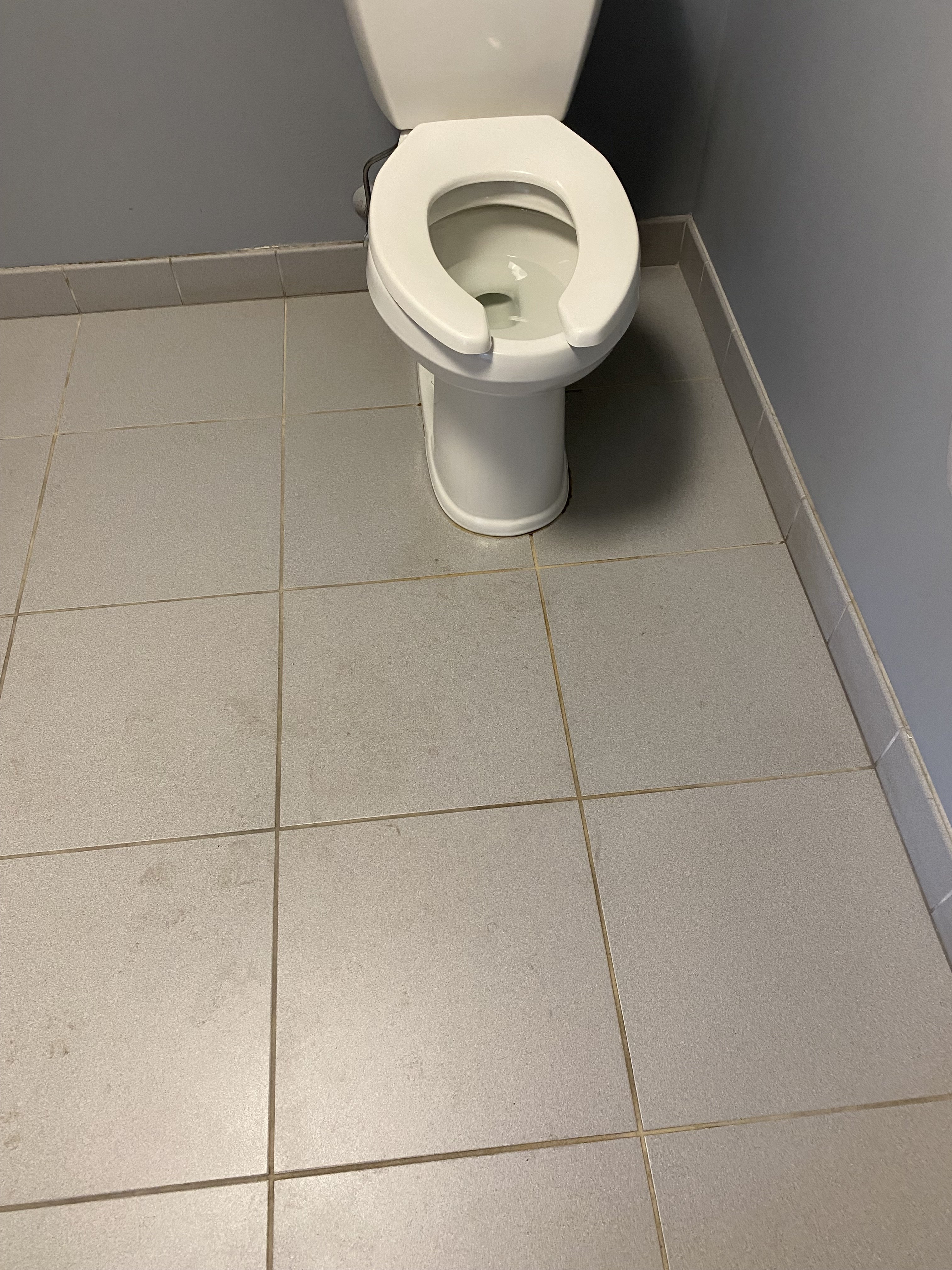

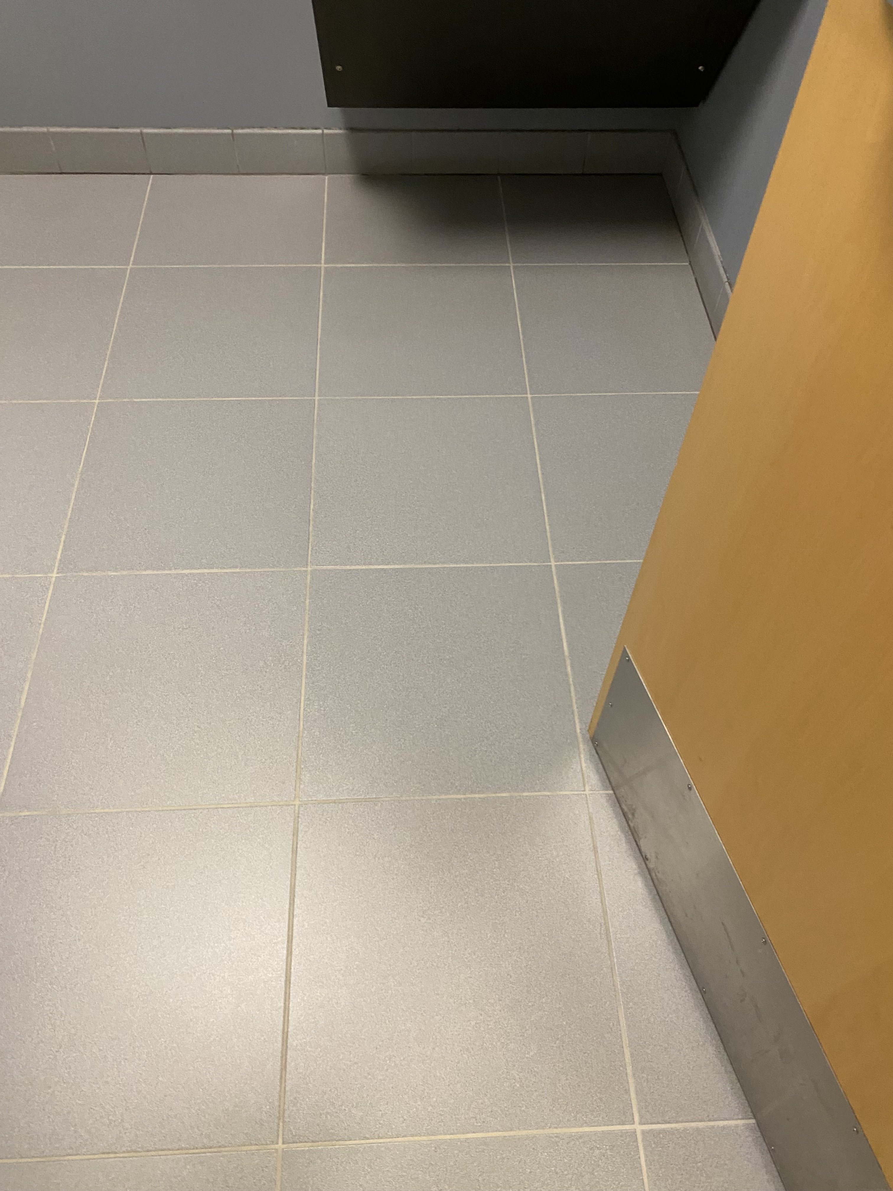

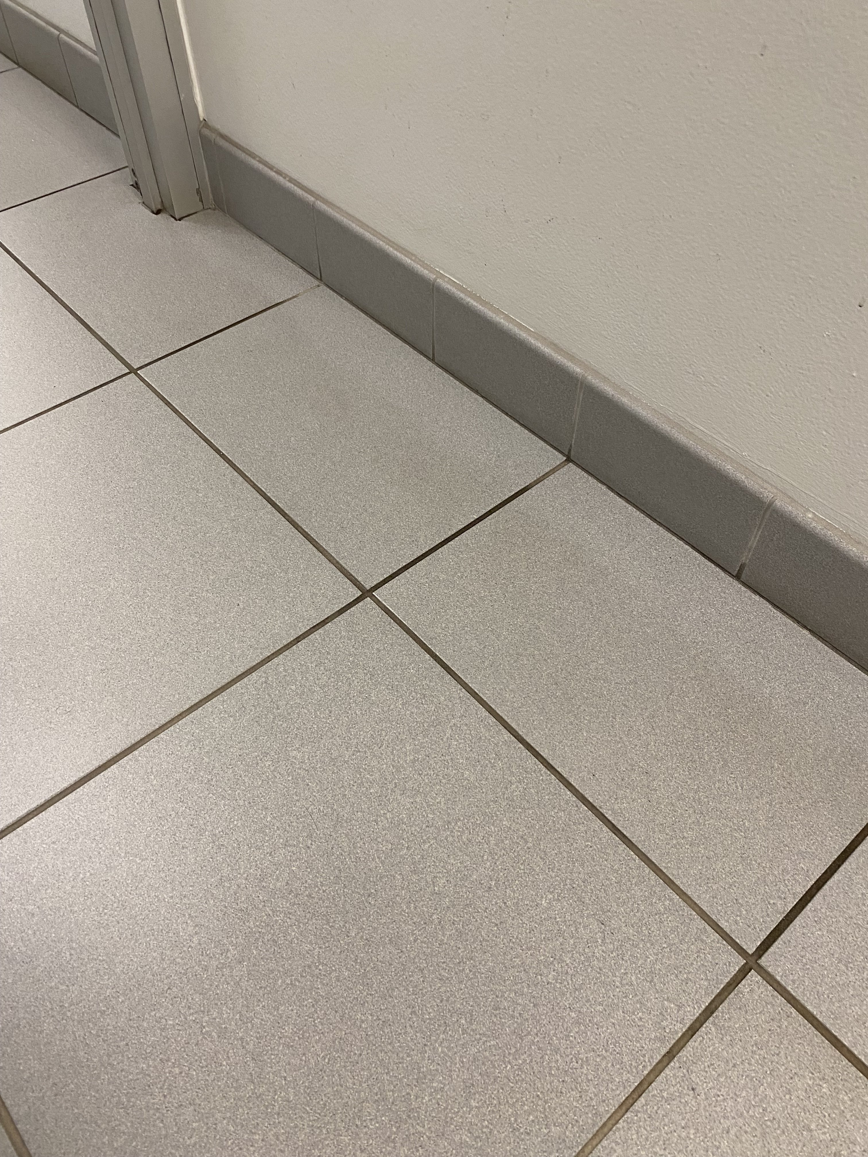

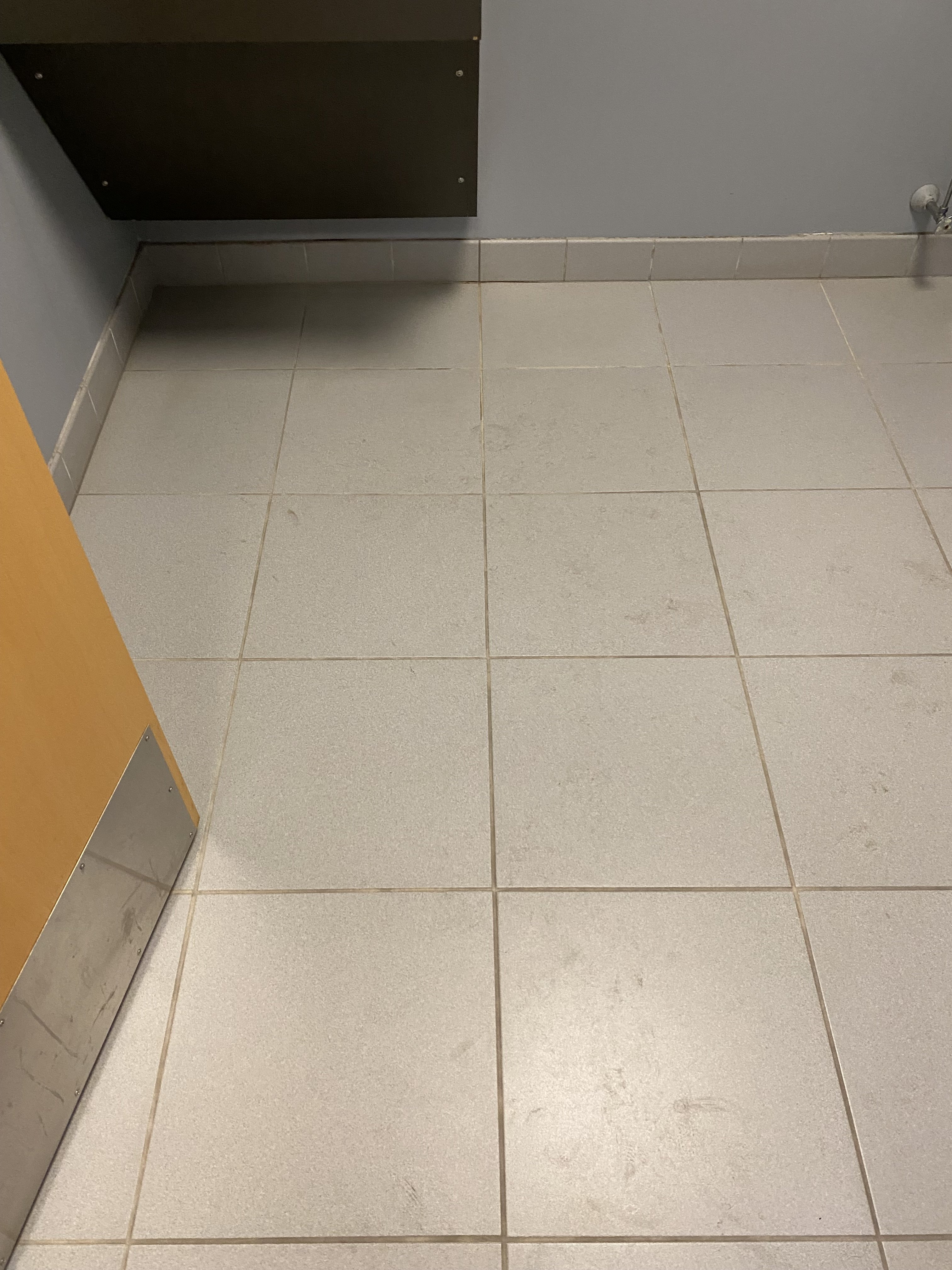

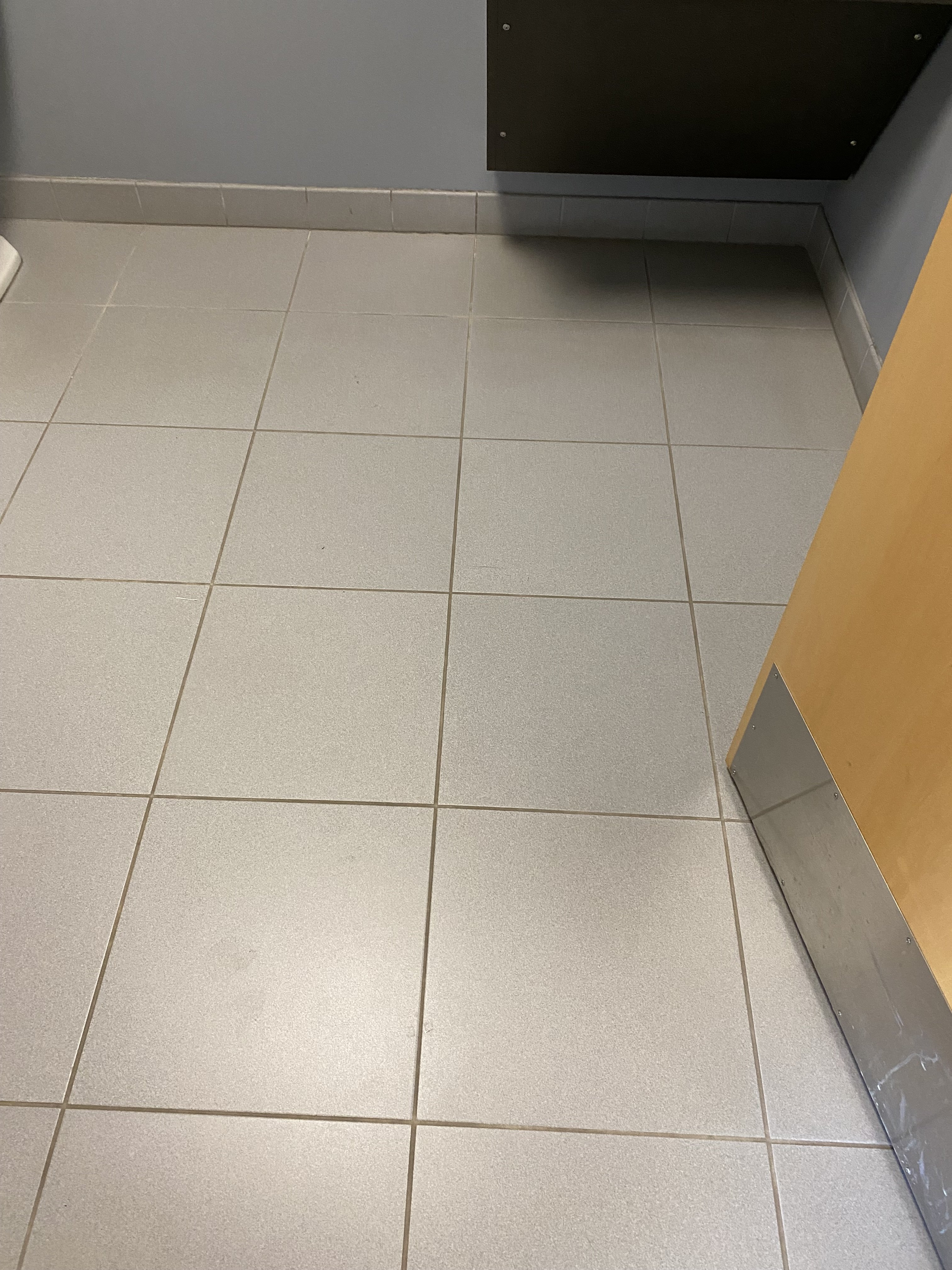

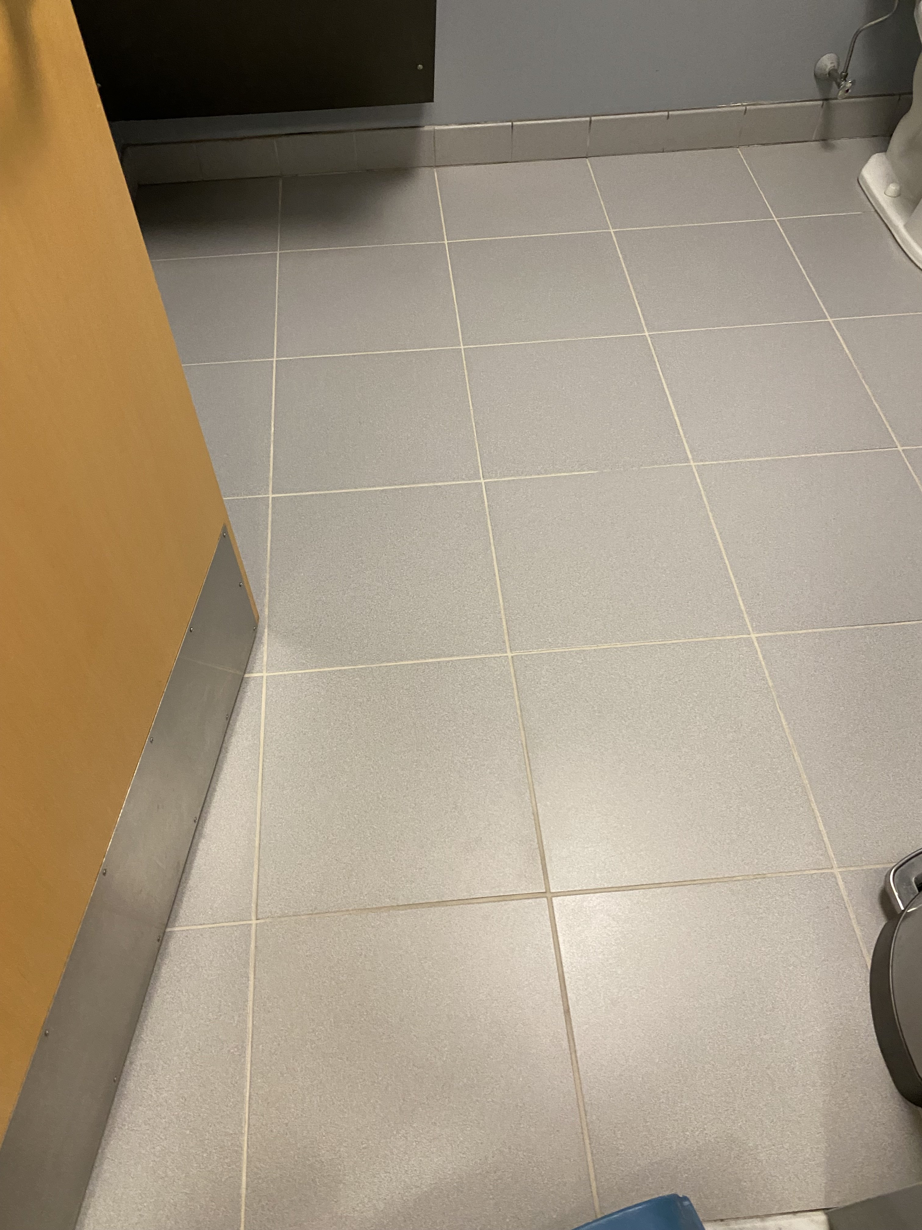

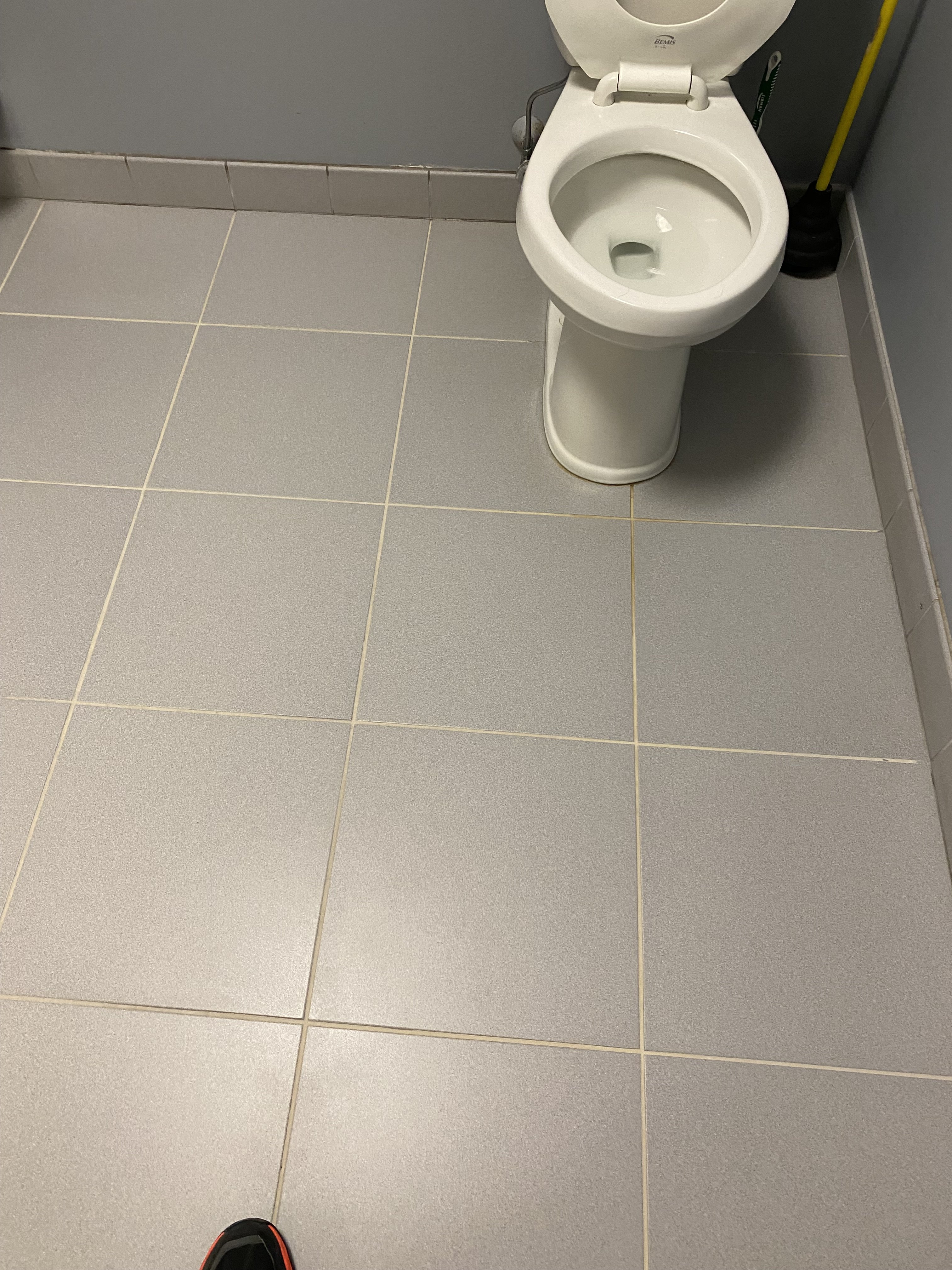

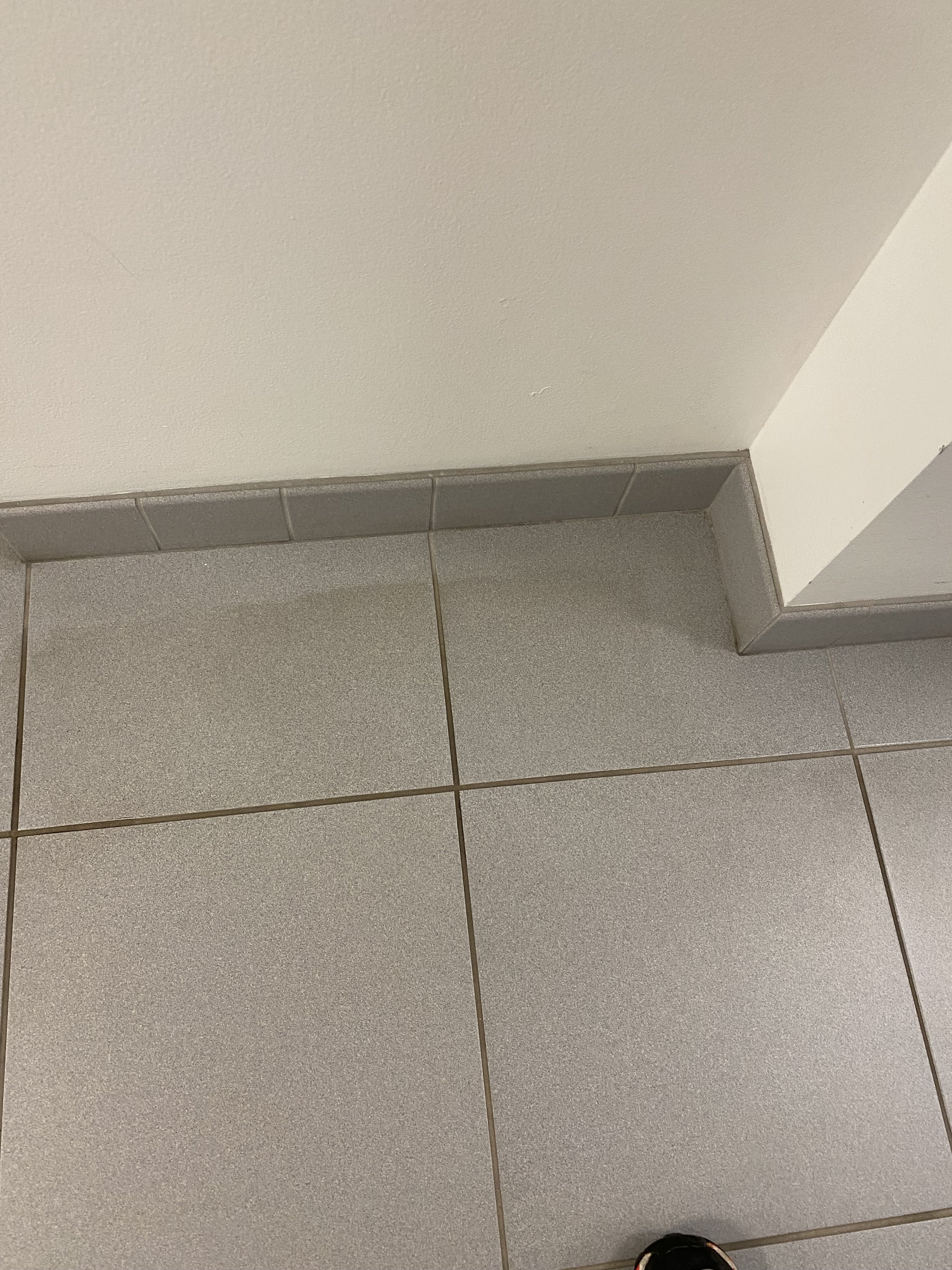

IMG_0645.jpegIMG_0648.jpegIMG_0643.jpegIMG_0646.jpegIMG_0642.jpegIMG_0651.jpegIMG_0640.jpegIMG_0649.jpegWell I cleaned the dealerships service department floors and they didn’t come out great… There is/was heavy soil build up along the edges and the grout lines were heavily soiled! They are definitely cleaner but look like crap. Some of the grout is worn in high traffic areas. Owner told me that the grout is epoxy and that he has tried many things to get them cleaned in the past. Floor has been down over 10 years and hasn’t been professionally cleaned.. although he did have the contractor that installed floor back because they said they could clean it with no problem. Going back this weekend to go over some areas is service department and start on showroom. I don’t have after pics from the service department but I did do 2 bathrooms as well, they came out better than service (with exception to the men’s room where urine has stained the grout by the bowl)!! Grout still looks like crap to me… ugh

Looks like a nice improvement. No need to beat yourself up sometimes the cleaning has some limitations.

Is that a Men's room or Ladies Room?
First 2 pics are men’s room but I think they also use the women’s room. About a month after I cleaned them I went back to look and the men’s room looks almost the same as it did before I cleaned it. Women’s room close behind…
