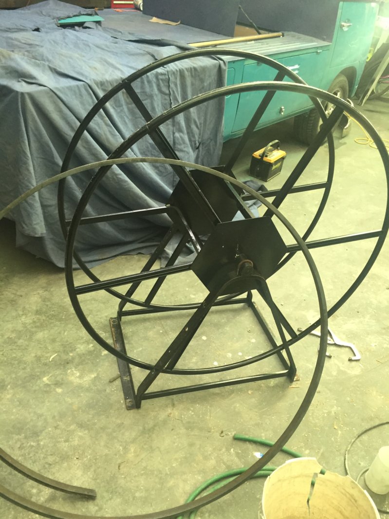

Have a fabrication shop roll the channel.
Reactions: Lee Stockwell
J
JS41035

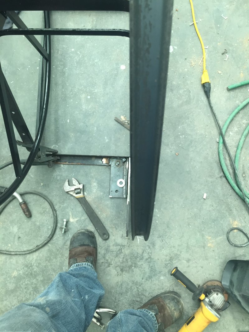

Clamp the channel to the round tube and tack weld it on. Cut the channel overlap with portable bandsaw or cutoff wheel.

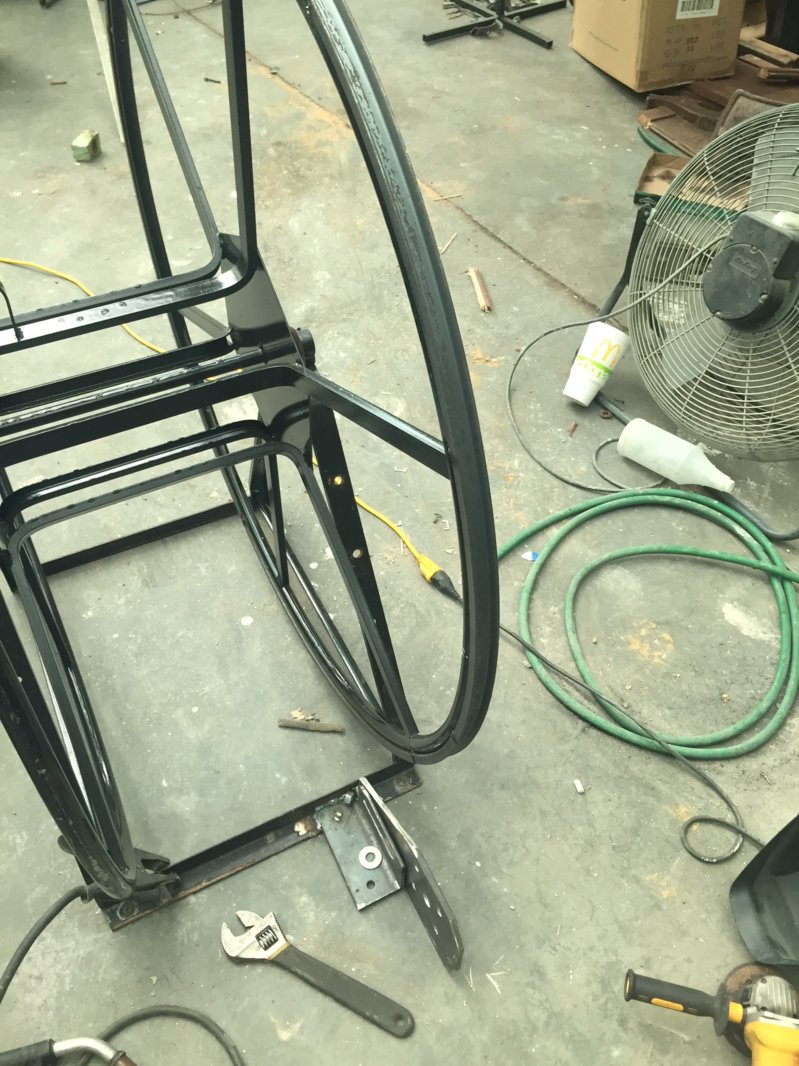

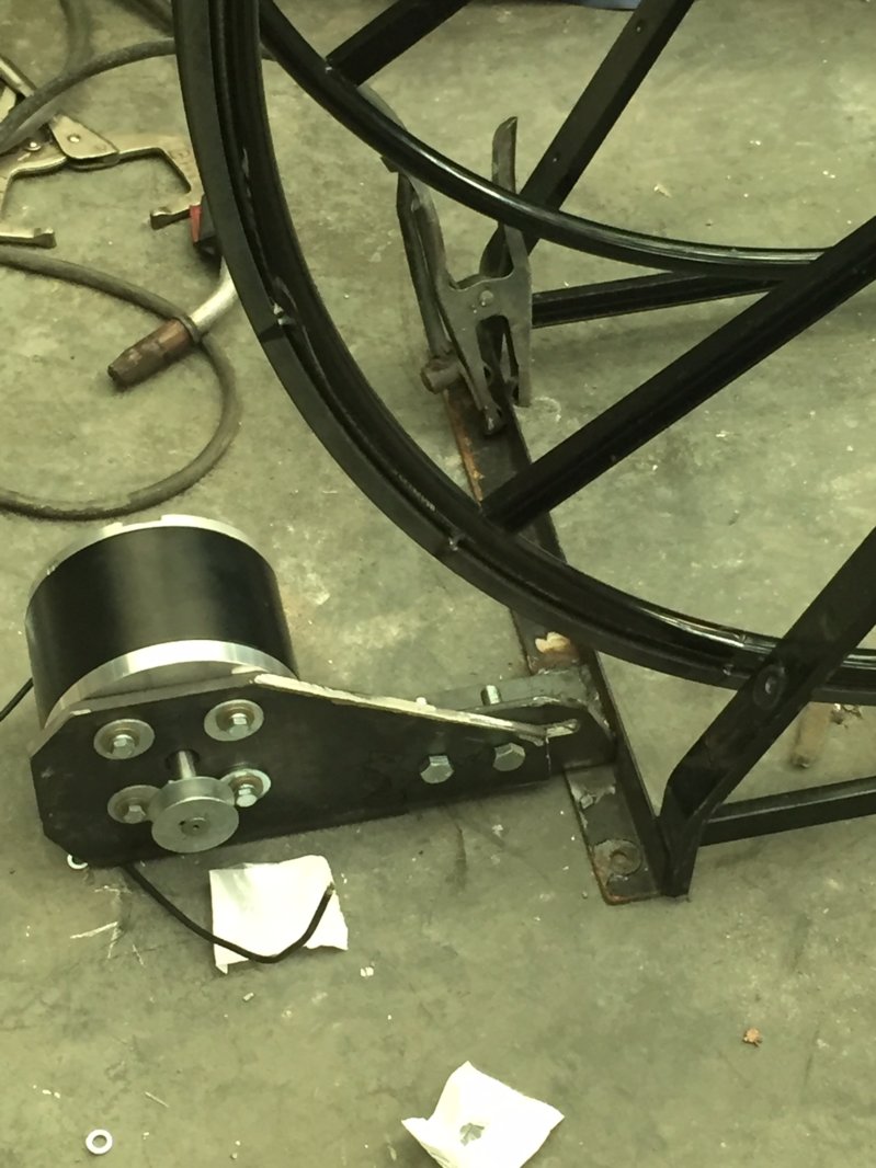

Very simple bracket. Use a piece of paper and a very small ball peen hammer to make a template to transfer the motor's bolt pattern to the 6 in plate.
Put paper on motor. Softly tap on each bolt hole to transfer pattern to paper then cut out with utility knife. Basically the same method you use to custom make a gasket. Drill those holes and bolt motor to plate

Nice job, I would have done it differently for rigidity purposes on the bracket(fixed/welded) and motor mounting (slotted for all four mounting bolts) but the way you did it makes it easier to adjust tension and faster to install.
Are you going to do the other the same way?
J
JS41035
Well you would have to slot all 5 holes. Four mounting and motor shaft. Yeah I'm did the other the same way.

four slots and a larger hole for the motor shaft, we have 2 that are this way and 1 that is the way your is. We like the all welded bracket with slots to be much more rigid and not trouble free.
