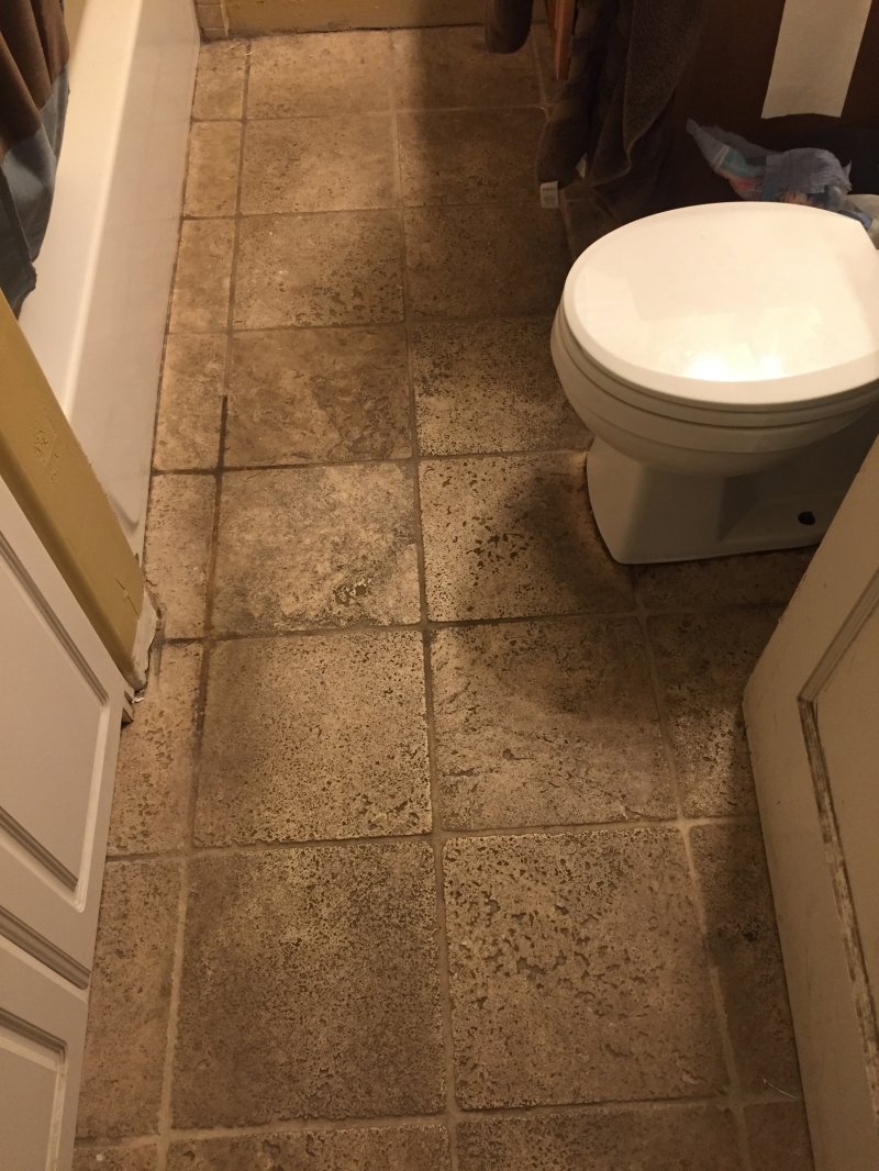

Ive got to clean a marble bathroom floor next week. It needs polishing, which I don't know how to do, but she said just clean it.
I assume I need to avoid acids?
What else do I need to be aware of?

why people put travertine in a restroom then turn it into a rental. homeowners are back in they'll be replacing soon. what would be your plan of attack?
they just want it clean
clean image
Oct 5, 2012
970
Orlando
Carl Maddock

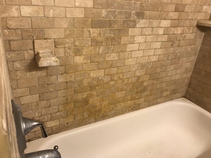

It really depends on the type of stone, and finish.
Some stones benefit greatly from just cleaning, like the one above- I filled,postfilled with tumbled edge.
If they are asking you to clean a factory honed and polished, then there are other problems , as it's difficult to get dirty
Polished, honed, brushed finish?
Castle installation or standard
Sand unsanded grout lines = width
Butt install or 1/4"
Un filled, postfilled or factory filled trav
Chisel.ed, tumbled, micro bevel, square edge?
