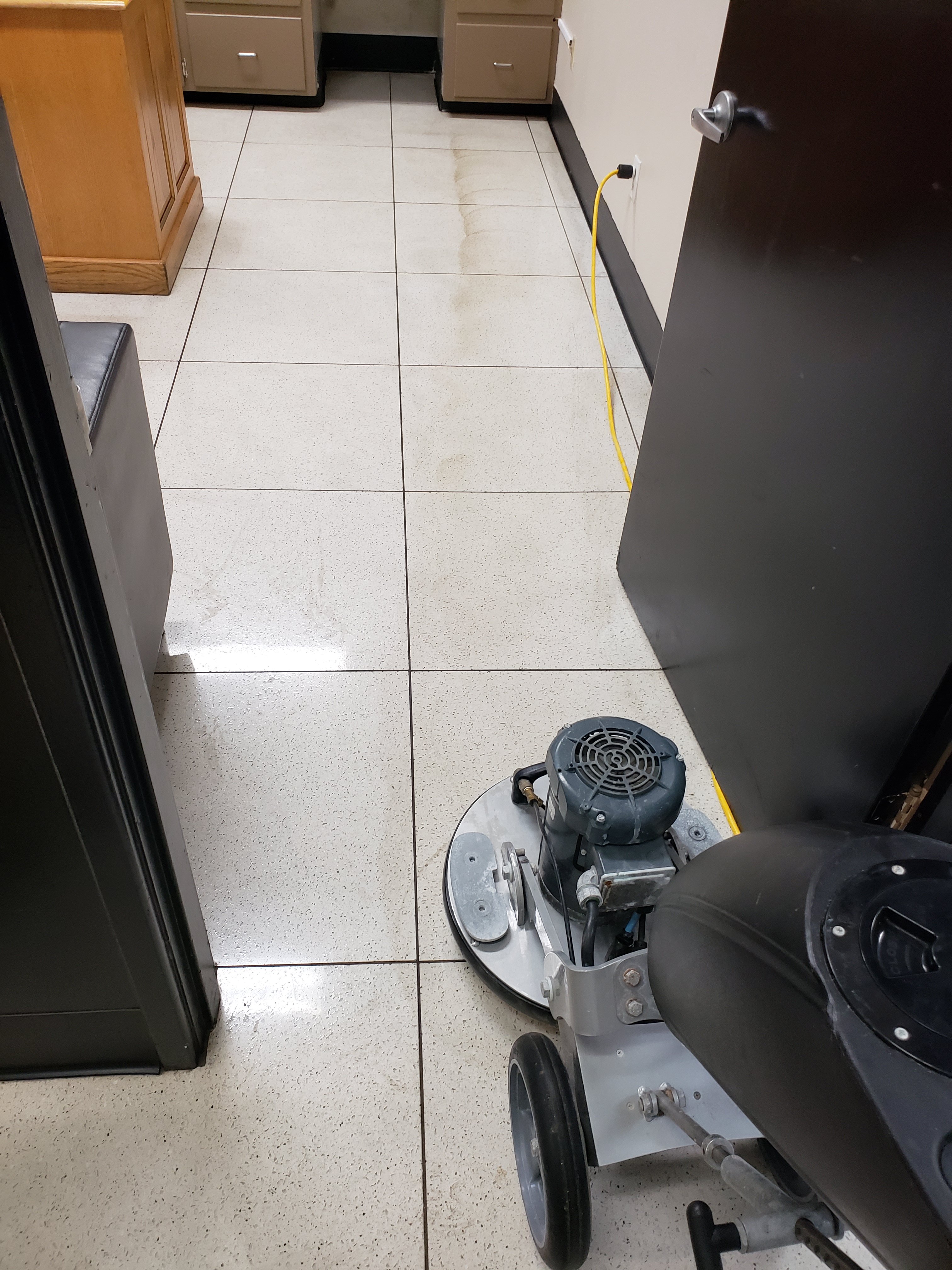

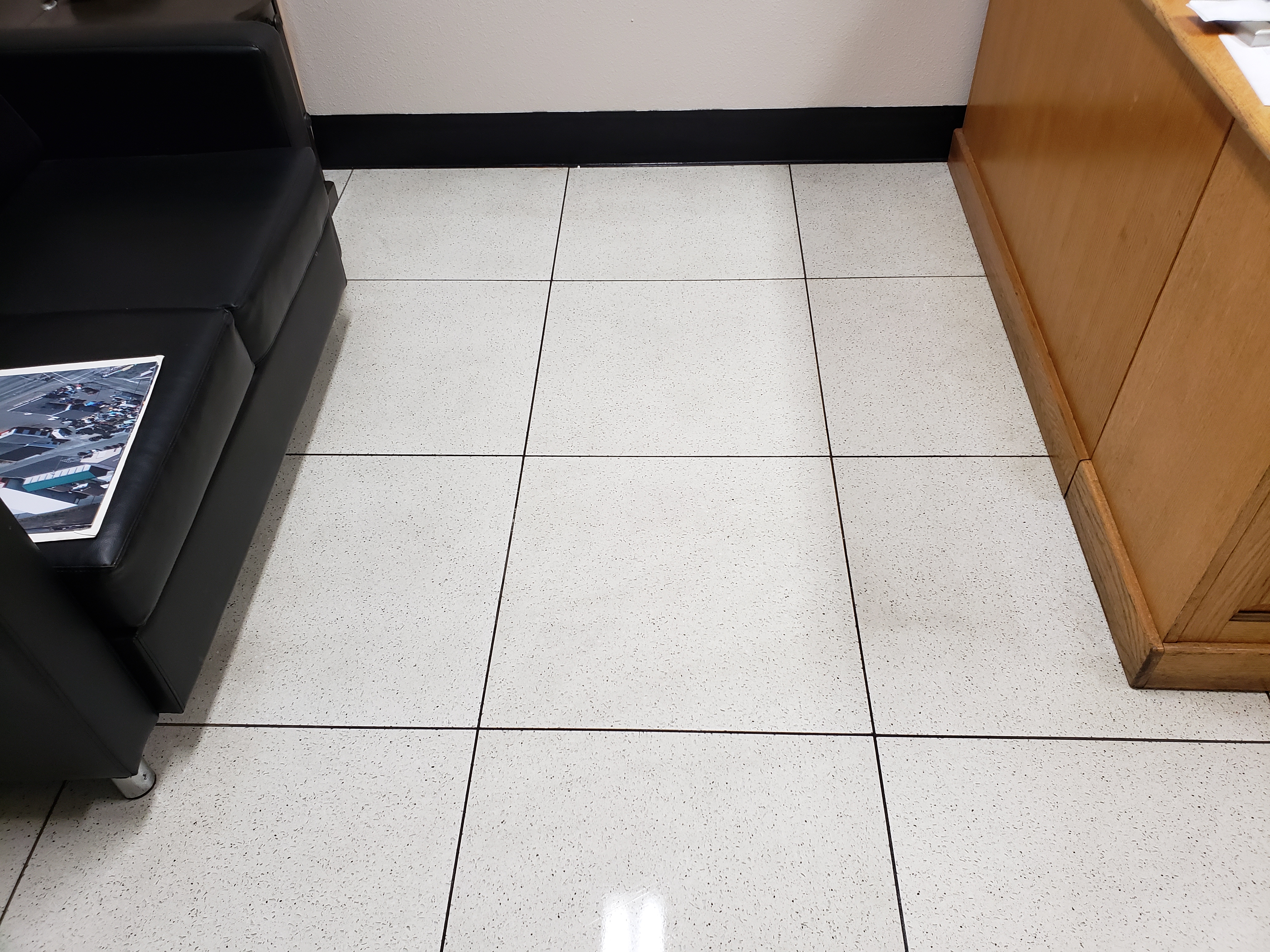

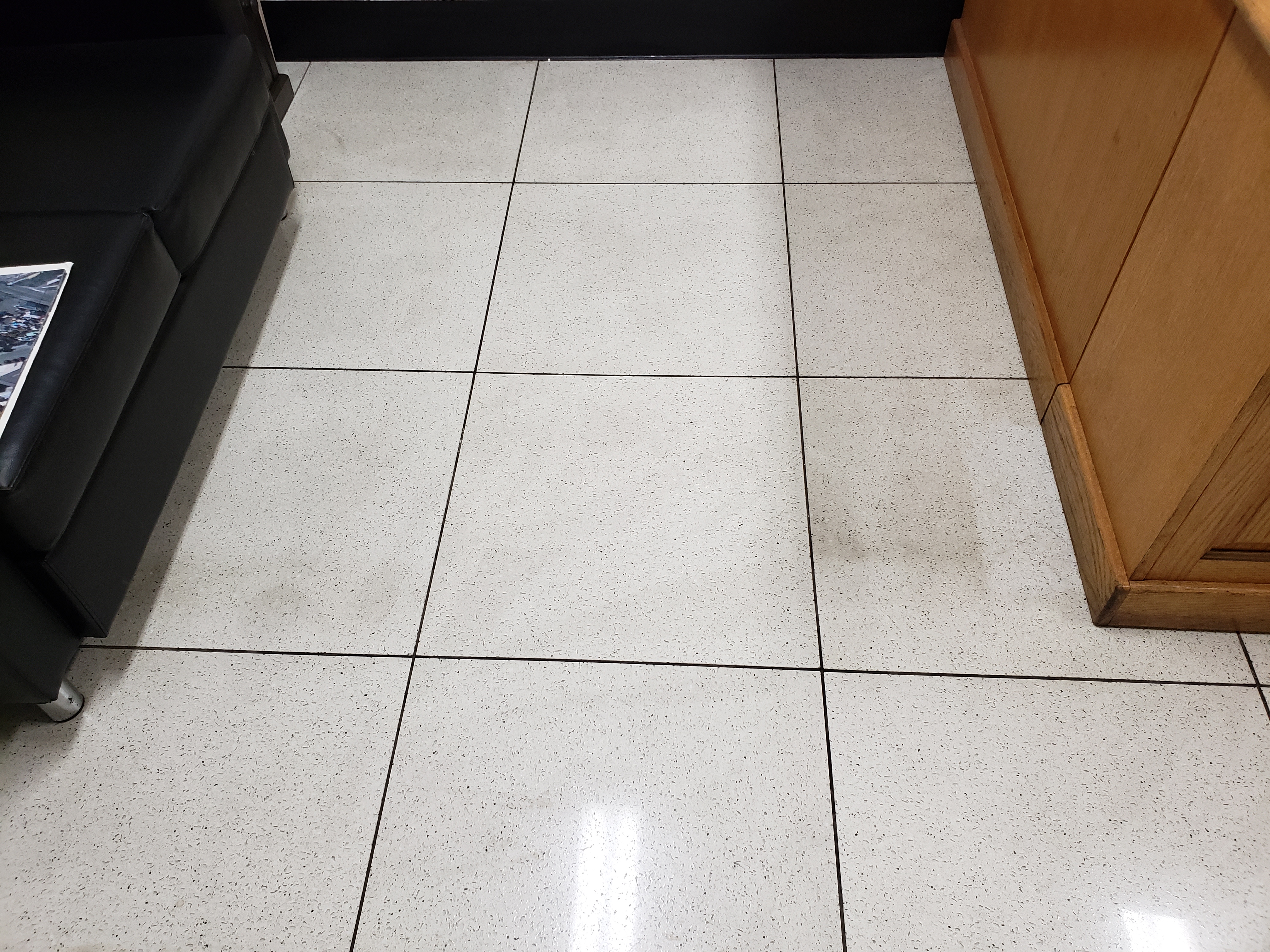

I have a janitorial account with a really strange floor. It's a chain tire store that tried this fancy new floor which claimed low maintenance costs and all that stuff... here is the link to their website. Some trendy(pub intended) "eco friendly" floor that costs way more than it's worth. Anyways it has been impossible to keep looking clean. Its "non porous" and you cant use anything abrasive to clean it, but it seems to absorb stuff and stain. So it's useless. But anyways it's like 2500sq ft so i didnt want to flood the place with acetone or bleach like they suggest for a deep clean. I had a melamine pad from my orbot vibe package. They call it the ultra lift pad or something. I tried a small spot and it didnt take any shine off, so i went for it today in an office. Worked amazing. Pictures dont do it justice, sorry. The pictures are all after mopping, so the dirt just usually doesn't come off. This helped a ton.
