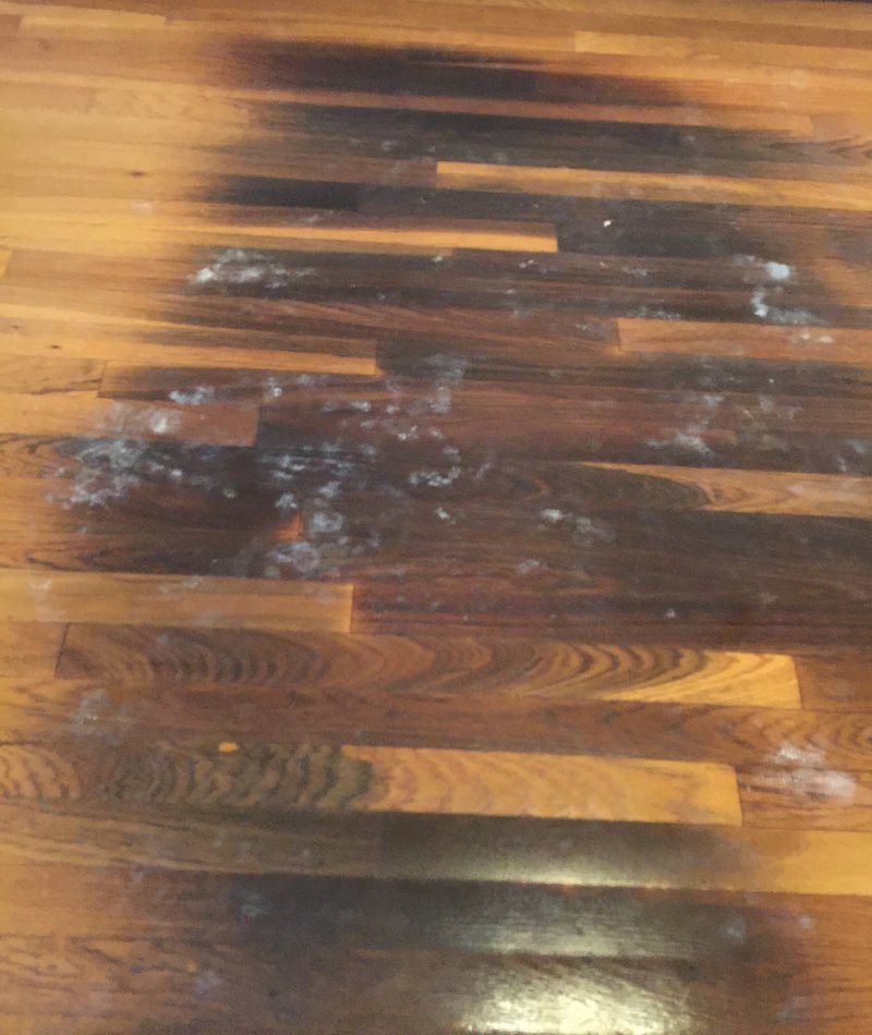

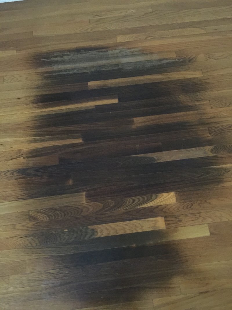

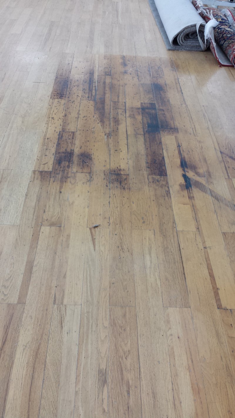

Wool rug with mold was left on wood floor only 5 days, after picking up we noticed this
Sprayed Quat-a-lot, let dwell for 20 minutes then steam cleaned...then sprayed Microban Germicidal Cleaner Concentrate & hoped the "blackened" area would dry out & go away, 5 days later it looked like this still
So tried some solvent cleaner & a high PH cleaner & the "black" won't budge, I sprayed some bleach as a last resort but after 20 minutes didn't look any brighter, what are my options?
Steel wool?
Sand it down?
Doing this as a favor but honestly its my first time so I could use some help.

I would suggest a screening which uses a screen under a 175 RPM floor machine. This is like sand paper, but less aggressive than sanding with drum sander or belt sander.
I am not sure this is a job a beginner should tackle.

I would not put anymore liquids on that floor. Moisture has gotten in between the boards. Is there any cupping or crowning? if not it might dry by itself. It needs to be completely dry before you can fix it.

I feared cupping but so far none has occurred.
Going to pick up some wood bleach in the morning & take a belt sander if I can't find screens.
Found some highly rated floor company's on Yelp to call if I feel I am making the situation worse.

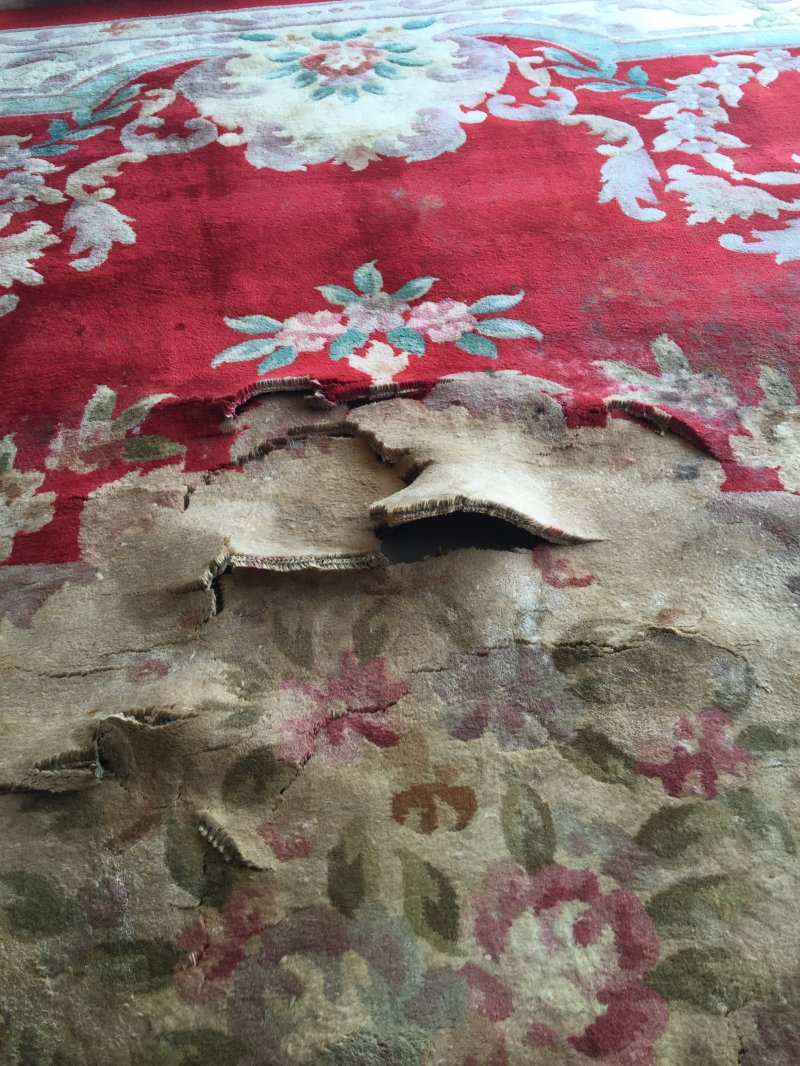

Heres the whole story, 6 months ago the owners were put into an assisted living home, the kids brought in a cleaning lady who happened to have a husband who cleans carpets, he cleaned this rug & wrapped it plastic & it sat rolled up for 6 months, they finally unrolled it & discovered mold so they called me, I bring it into the shop & fully unroll it & discover its "rotted out", I find out home owner in the past had used bleach & rug Dr type cleanings...so I cut up the rug & trashed it.

It would cost about $700 to fix that correctly here. I'm sure much more there. It didn't happen the way they said. It was wet many times, a little at a time. Guessing a pet used the rug over time, rug "cleaned" in place several times, etc.
What did the floor smell like?, the rug likewise?

Nah, a belt sander will rip that right off, best to do whole room. Follow with some color voodoo, stain, and poly. Will look like a million bucks.
PS If you've never mastered this, well this isn't the job to practice on.

No pets.
The rug & the room it was in did not have an odor when I first picked up the rug, the floor has no odor!

Concrobium Mold Stain Remover is in stock at several California Interlink Supply locations. Also some other good mold stain removers such as Advanced Peroxide Cleaner from Fiberlock.
You may as well try the easy way first, but I still think you will get back to the screen or sand options to make it completely right. Maybe since it is not your issues they will settle for good improvement.

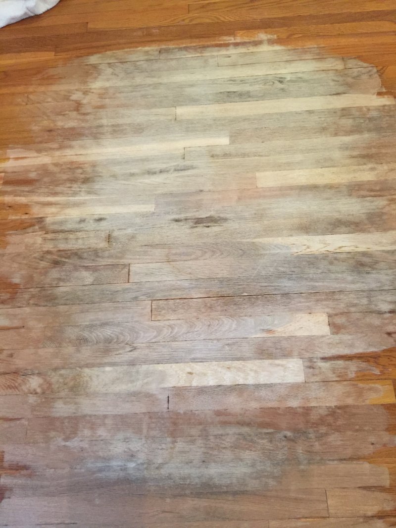

I made 2 appointments with floor restoration company's today accepting boards need to be replaced then stained by a pro, 11:00 appointment no show :hopeless: my 4th grade daughter flew to Sacramento with her class so I have lots of nervous energy so I grab the belt sander, slap on 50 grit mostly to kill time & since I am likely stuck paying might as well really mess things up right? So I sand down the area (haven't sanded anything in years) then grab some Clorox Outdoor Bleach that I had in the van & spray the area (don't worry, nobody lives in the house, its going to be torn down after its sold anyways...land is worth way more then the house...Sherman Oaks, Ca.) I was going to order the 2 part Concrobium Mold Stain Remover but the Clorox appeared to be doing its job in the mean time. The 2nd contractor finally shows up & says boards don't need replacing, he would just finish sanding, stain then polyurethane..I tell him great when can you start, he tells me they are booked until May 8th :madder:
I guess I will experiment & practice until I can hire someone.
Progress???
