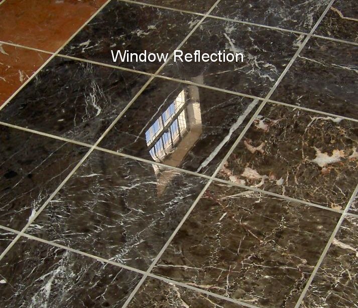

Here is one picture on some black emperador marble showing reflection detail of our showroom window about 15 feet above:
After Polishing, check out clarity.

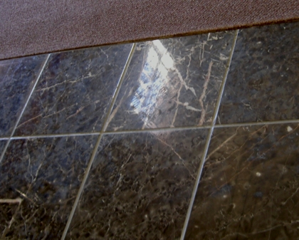

Same Window Before Polishing

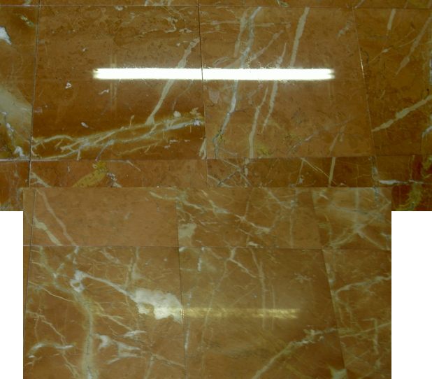

Another Marble - Fluor. Light After & Before Polishing
