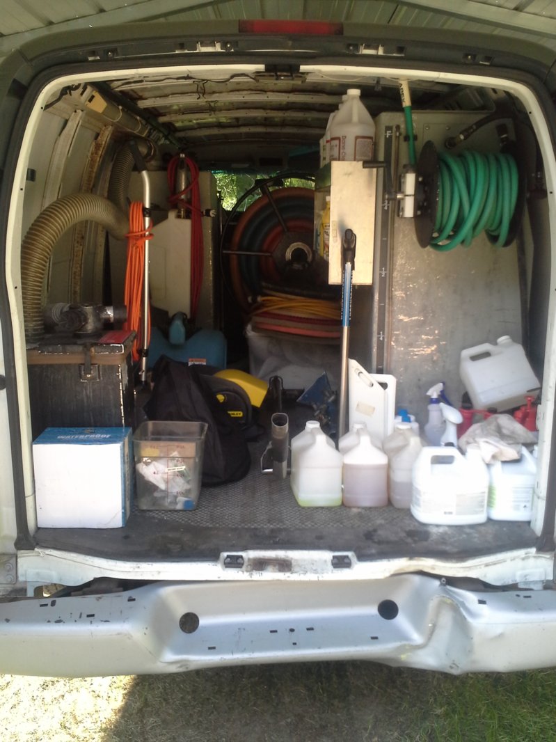

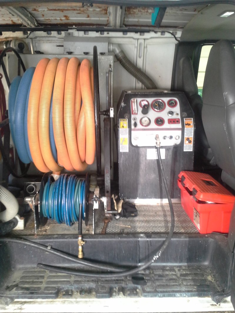

Do you have some good pictures of your setup to show us what you're proud of? I like seeing some good white magics.
steve_64
Aug 11, 2012
13,372
Bumper and rear door. Its not high on the list but its there. Want a new drivers seat also.
Got s bad squeak that started after replacing wheels too that needs to get fixed. Mechanic isnt sure why yet.
Still in the middle of a bathroom remodel and got a bay window on the way. The house has been eating up funds.
