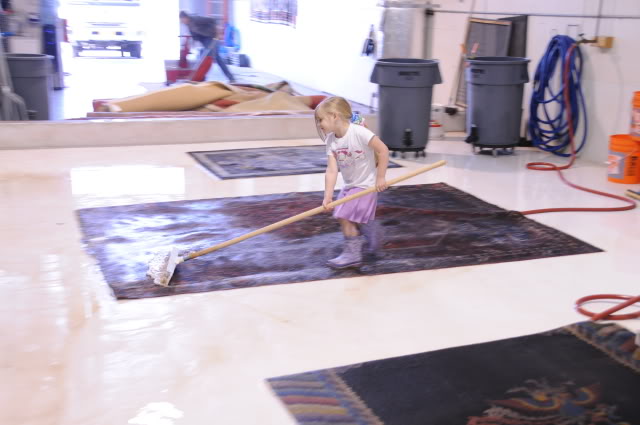

I've had a badger for the past 5 years
here it is in the background you'll notice we often use it with the sanitaire at the same time...cute kid eh!
