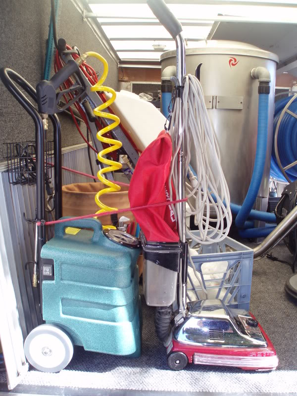

So far the Mytee Sprayer I got to test has been working very well.
The bigger wheels that were sent out as a upgrade helps it's top heavy tendency to not tip over backwards.
It's next biggest fault is the way the tank is mounted to the cart. Just two screws that love to back out and let the tank loose.
The powers that be are aware of it's short comings and I can only hope they sturdy the fittings up soon.
Battery and pump have worked flawless so far.
Hose and gun/wand work well too.

Tell them you'll buy it if and when the fix the screw issue. I would hate for you to have to deal with the constant tightening I am having to do.
Locktite is out of the question because it will need to be taken apart to access the pump and battery and the torque need to break blue Locktite may strip the plug nut thingies that are embedded in the plastic.
It's a real easy fix from the manufacturing point of view.

Only one I have now.

The nuts are embedded into the molding it's self.
Another part of the problem is the screws go through slots that are right on the edge of the cart's frame, rather then holes, so as they loosen the jug falls right off.
Two tiny screws hold it all together.
I would recommend four larger ones with some sort of intergrated locking system.

Glad I'm not the only one using bungy cords and milk crates on my truck. How much and where do you get the mytee? Looks way more durable than my POS omnipro.

I call and left a message on your cell phone about a week ago. I sent the mold back to the mold maker for some mods.
1) increase the wheel well to fit a 8" wheel.
2) put in 4 inserts and change slots to holes in the plate.
Would you prefer a 25' straight hose over the curly?
We appreciate all the suggestions to improve our product. These changes should take only a couple of week I'm told.

Try some silcone (rtv) on the srews in the meantime. It'll stop them from backing out and can easily be broken loose. Once we get the upgrade done anyone who has an old Mytee sprayer can return for the fix. No charge, just inbound freight.

The small tube that hold the spray gun, make it wider so the QD fits inside it. As it is, the QD lip rides on top and if you hit a bump moving it the QD comes apart real easy. Having a larger tube that will sink the QD inside the tube should solve that.
