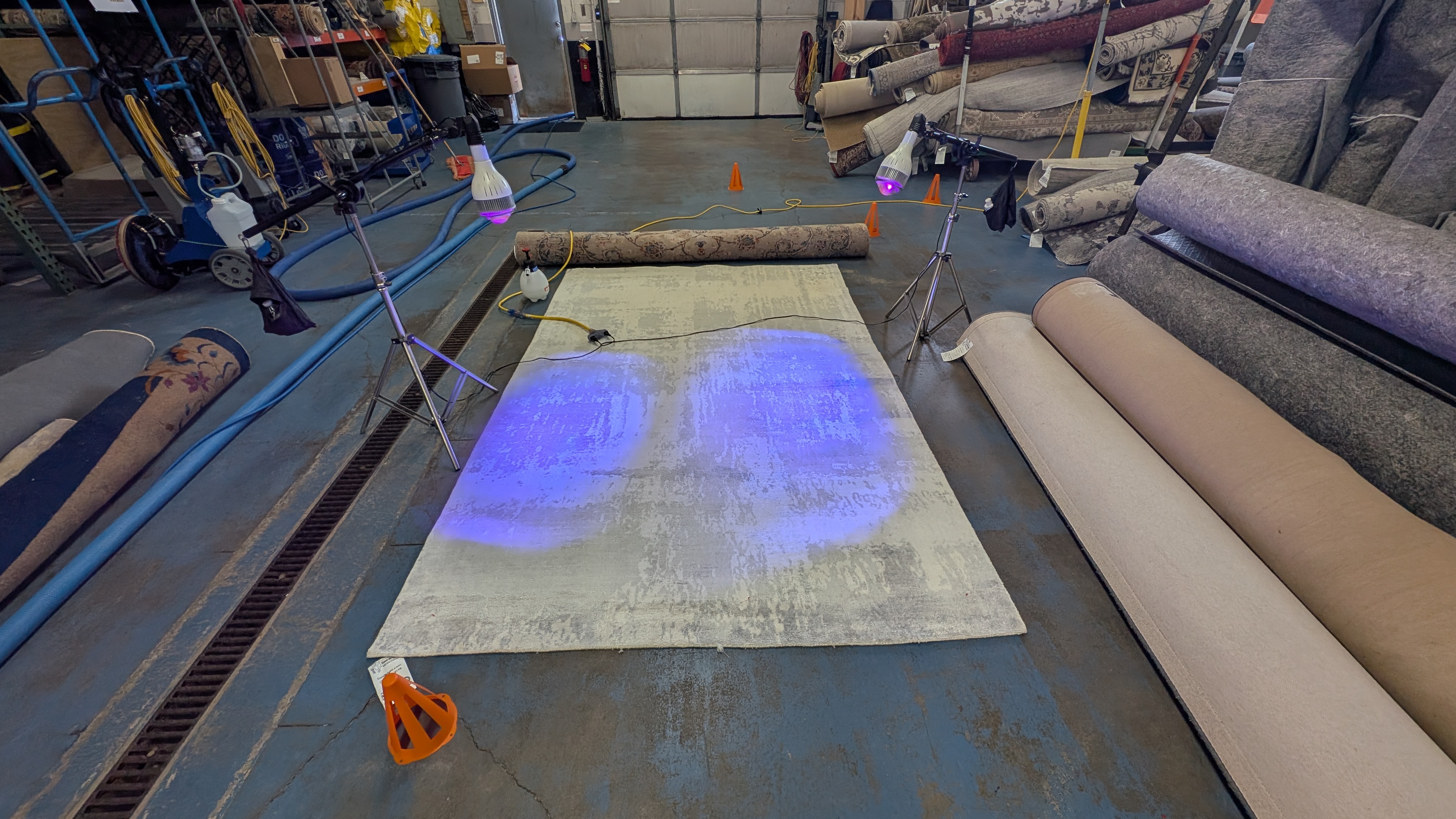

UV light helps if it's stubborn.. I haven't had a problem with multiple applications.....but it requires various trips..
Reactions: SWass

116,530
Sani-Bright is big on UV

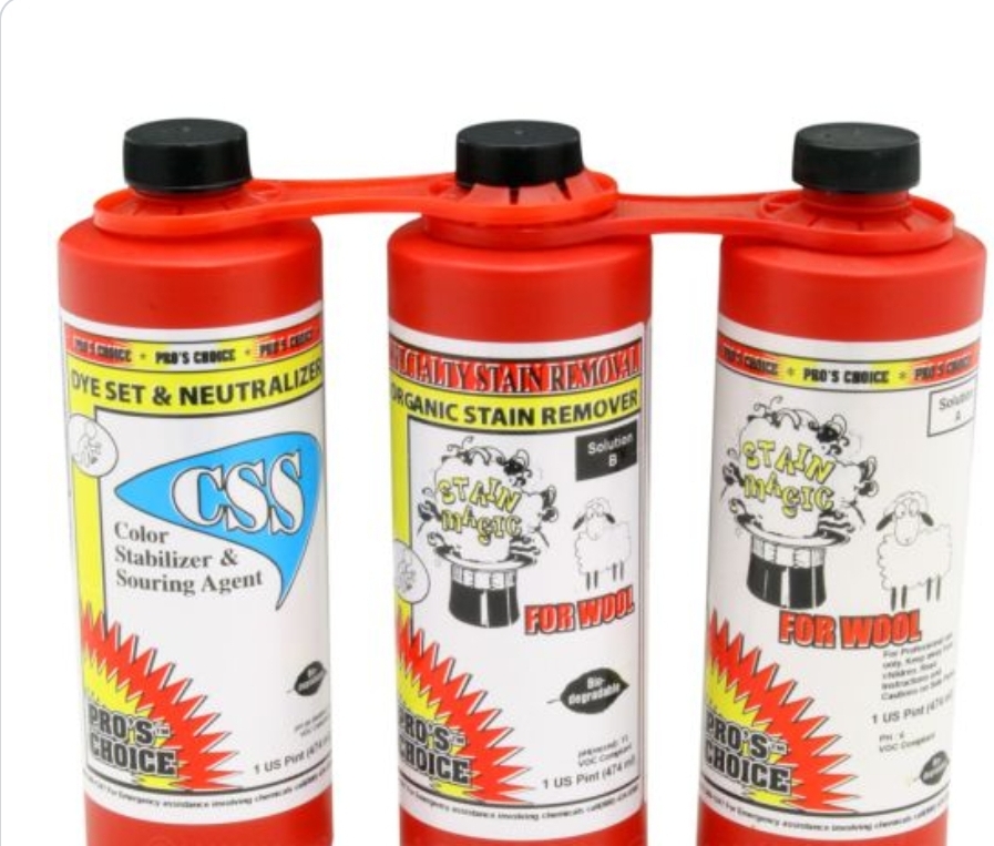

What are your usual safe products? Can you find out more about the coffee? What kind was it? Decaf or not? Cream or sugar?
Depending on the questions above I've had good luck with Pro's Choice Stain Magic for Wool on straight back coffee. Screenshot_20250123_194732_Chrome.jpg
Yes, I'm planning to drop off a bottle of 3% peroxide and my UV light & invite the spiller (husband of course) to go at it carefully. UV was the only other safe thing I didn't use cuz of time constraint. I've left a light and spray bottle on site with (different) customer before & had good results. Thanks
