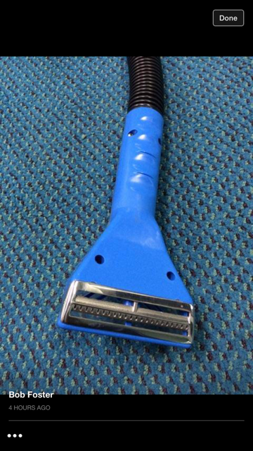

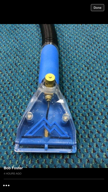

At least one manufacturer knows how to design a clear top on their Upholstery Tool . . .
22 Jets and Dual Vac Slots . . . Comfort Grip
and have you figured what the Cobb version will need to fix to make it a "top cleaning tool" according to your "testing" :oldrolleyes:
Reactions: AshleyMckendree
117,270
No trigger.
The designer of the Cutie must have dreamed that up.
Dry Strokes will require shutting off the valve...lol
And a potentially patient infringing spray bar?
Reactions: FRANKRRADUAZZO
Are there plans to make a version where the valve is not in the way?
I like the design other than the position of the valve. :errf:

The trigger on my SS uph tool stays locked on, and i always wished I could have a parker flow valve somewhere OTHER than the fookin END of the tool.

I set my needle valve to what I want it...locked it...and I have never touched it since I bought it...
as far as I am concerned all it does is save me from going out to the van and adjusting the PSI so I don't blow out the valve on the UPH tool...
At the very least the valve could have been put on the side like the Prochem tool. Still out of the way and with in reach if you're someone that likes to mess with the flow.
As it is, it looks like a toy for porty users, or for those that rarely clean upholstery.
Someone that doesn't know the issues of putting a valve in the way of processing. :icon_rolleyes:
I look forward to version 2. ;)
Totally agree.
Get the freaking valve out of the way. I can already count all the snapped fibers. Who's the doof who gives these guys advise?
And do get a trigger. Some of us do not like working with continuous flow.
I'll be happy to try the tool and the RV one too.
I never said it won't work. It looks like a good tool....some dumbass just stuck a valve in a bad spot. :oldrolleyes:
Seriously it looks good but that is a flaw I can see in design.
Will it get in the way all the time? It might.
If you don't clean that much upholstery maybe it won't frustrate you but if you clean a lot of upholstery you likely get tired of the nuisance of dealing with it.
I'd shoot the fool that positioned that valve. :winky:

i like the looks of the tool but prefer my trigger on the side. i need a trigger!
i wish i could find a good upholstery tool.
