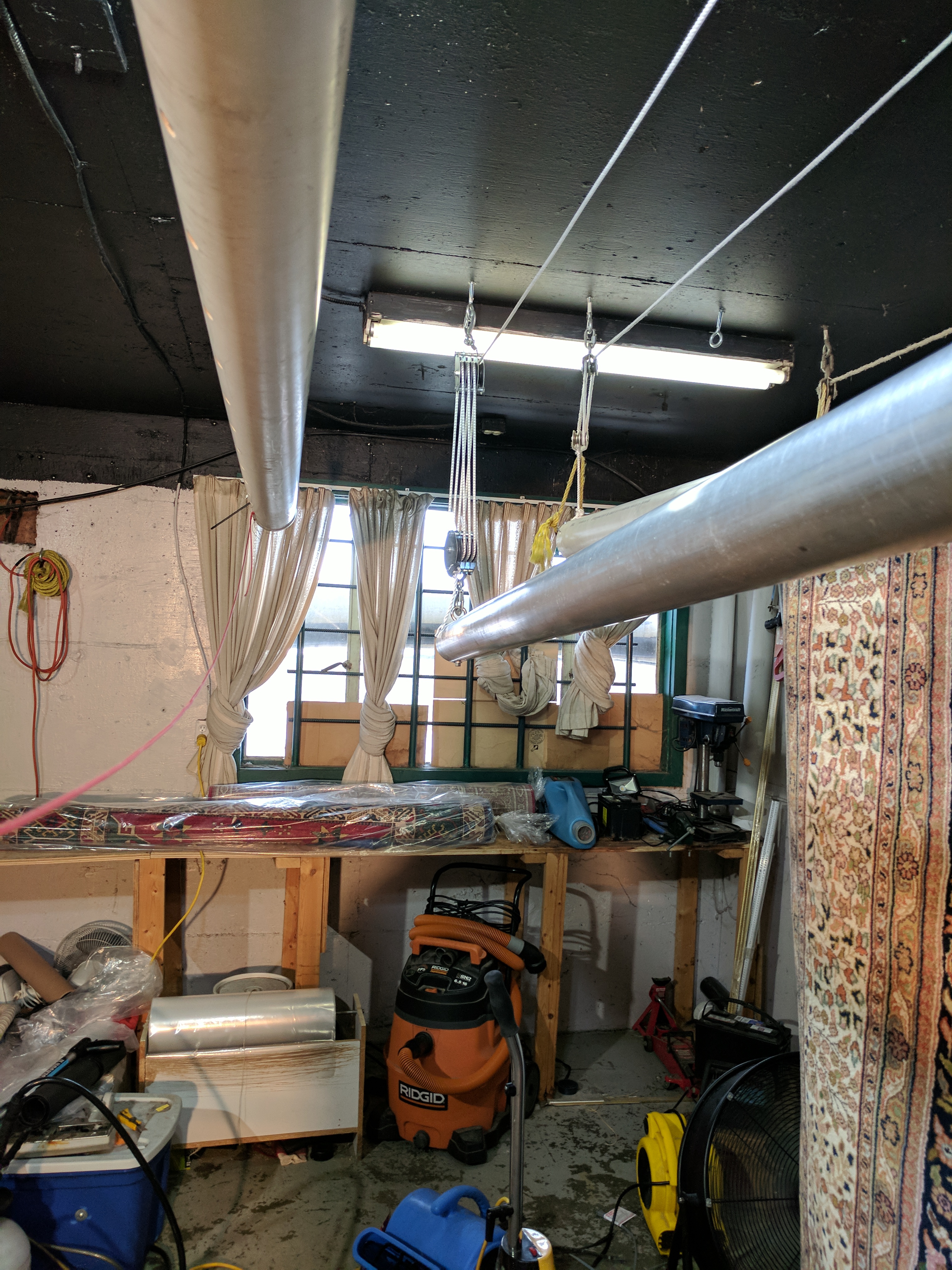

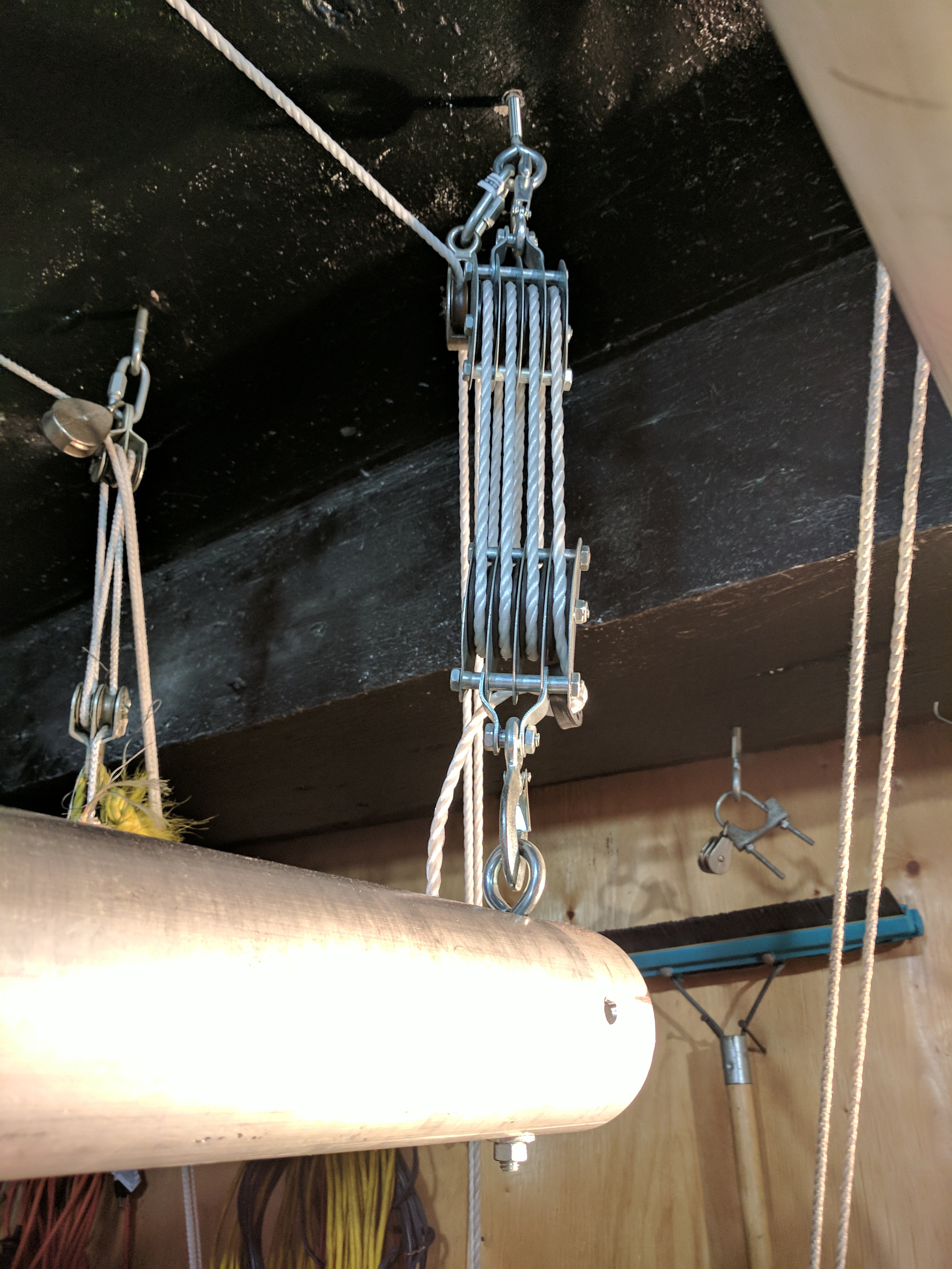

When I get back to the shop I will send you a pic of a ready to use pulley system that I bought from princess auto.
Reactions: Sierra Clean Care
6,564
I’ve got a pulley system set up on 2 out of 5 drying pipes I have.... I now wish that I would have done all 5.... easy when they are small and synthetic.... REALLY hard when I’ve got 5 dense wool in the shop at once....

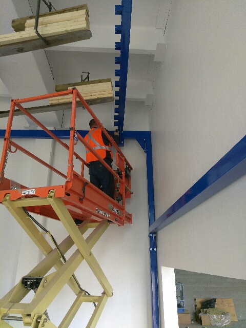

The vertical connection in the ceiling looks potentially weak to handle the load. What did you use?
What are you secured to in the ceiling to carry the load you lift?
28,265
We've drilled into the concrete and installed concrete anchors that spread when you screw in the eyebolt. The poles are only 12 feet wide and the largest rug I do is usually a 10 x14 so the weight is usually 200 lbs or less. I test them for movement every once in a while and so far they are rock solid.

Poly rope is NOT the way to go. Nylon Braided Marine Grade, still have circa 1994.
28,265
I agree. These systems come pre-rigged with poly. The poly is slippery and tangles easily. Just have to keep every thing straight and it works good enough. Just enough rope to traverse a 12 ft length ceiling up to 10 ft high.

The pulley system looks good. Be careful with how you secure into the ceiling structures. Especially in the instance shown in the above pictures.
