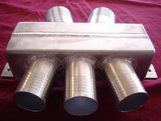

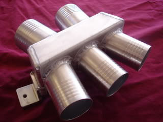

I've made several versions, each one a slight improvement over the last for net airflow.
Here are a couple of versions, the next one will probably be the final, it's a combination of the two you see here, it'll be ready in a few days if the planets remained aligned.

"Greenie, very nice, now how the hell does that thing work"
First off.. the pic is actually showing the manifold from the Backside.
It just brings three 2" hoses off the waste tank to a common "chamber" then goes out to two 2.5" ports, that way you have three hoses sucking on two hoses if you follow me, it totally unleashes the beast, and is particularly wicked in a round tank with three evenly placed ports that have 90º turns inside, it really induces a Vortex in the tank.
Jim: If you just want to use 2" hose, and just run a single 2" tool, I'd probably just stick with the Y off of the Vortex/AT standard ports, the 5 port manifold is really for 2.5" hose use.
If you look close you can see the 3 ports are all 2" and the two are 2.5"
As of now the manifold looks like it will be $125-150, I'm gonna weld up 10 and see how production goes. In the final version all ports will be straight, none of the angles will be kept, looked good on paper, turned out to be a PITA to hook up two big hoses at the same time.
2"sYs are $49
2.5" Ys are $59
Already have 5 "sold".
