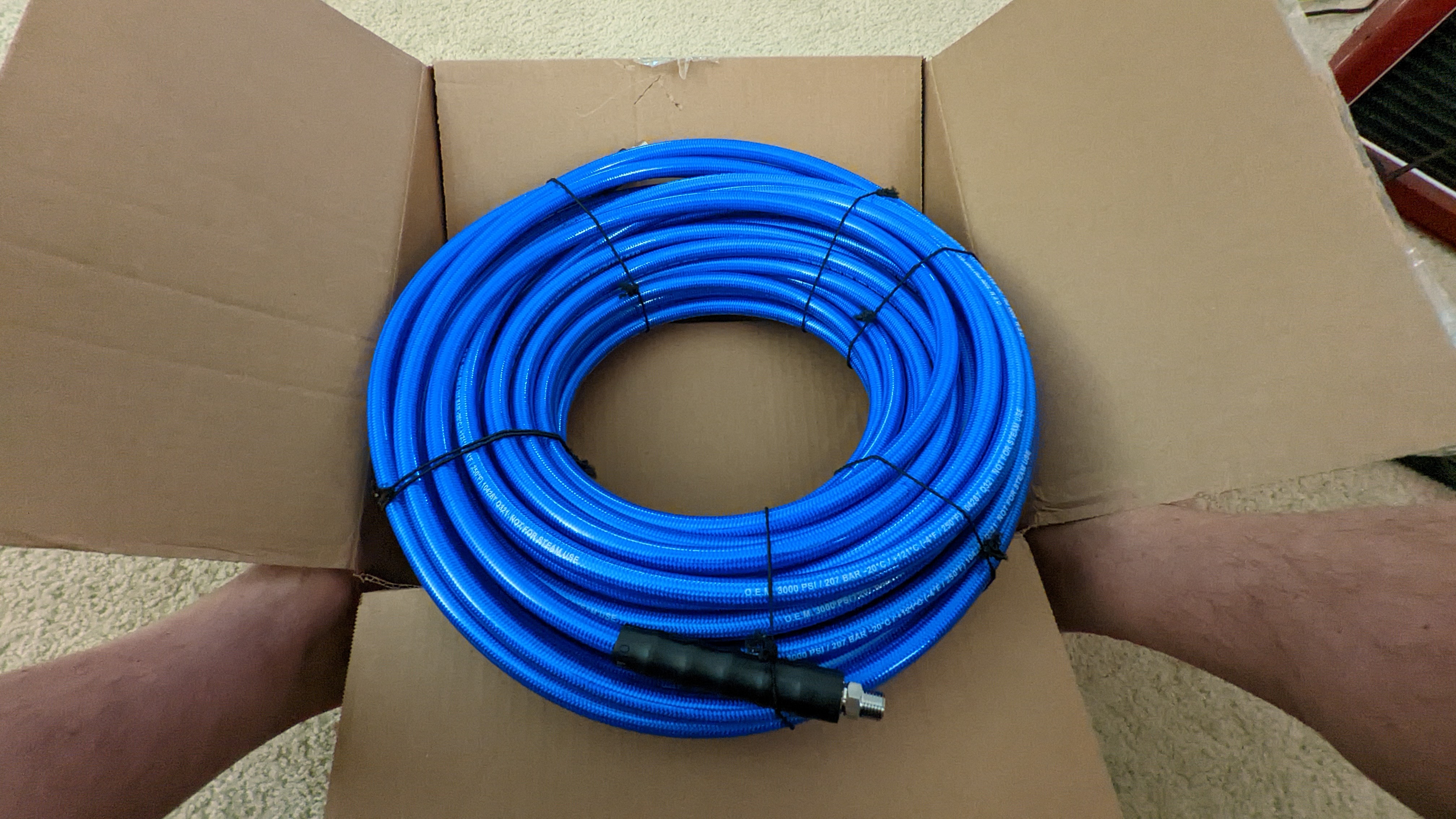

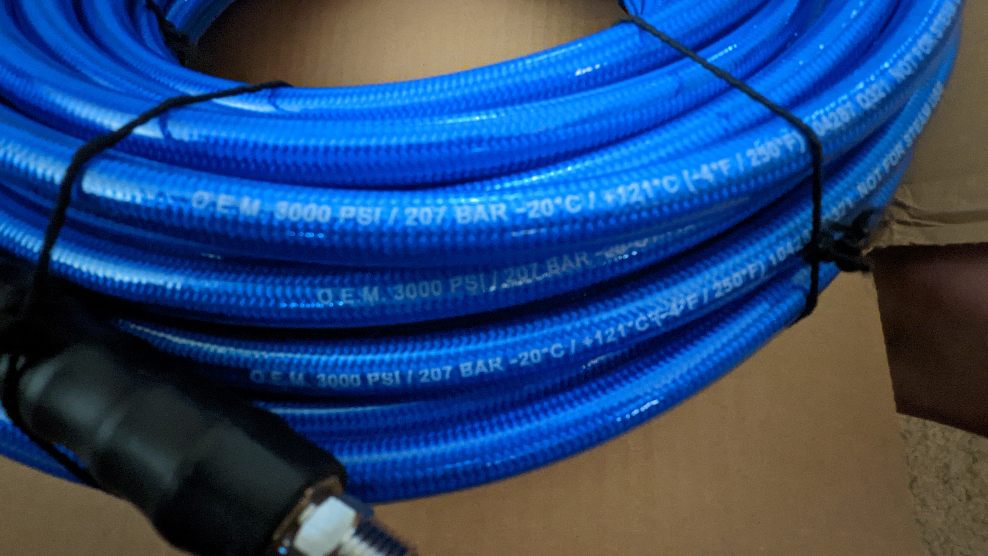

Exact same hose as a major supplier.
Picked it up a 100 ft says currently unavailable $79.00.
Amazon product
I have 2 of these that have lasted over 2 years on 570 and a pro1200se lead line attached to the truck.
When they go bad the get pinholes very small leak just toss and replace.

Temperature shouldn’t matter. The hose manufacturers know how hot our machines get. They should make them occurring to our specs 200-250

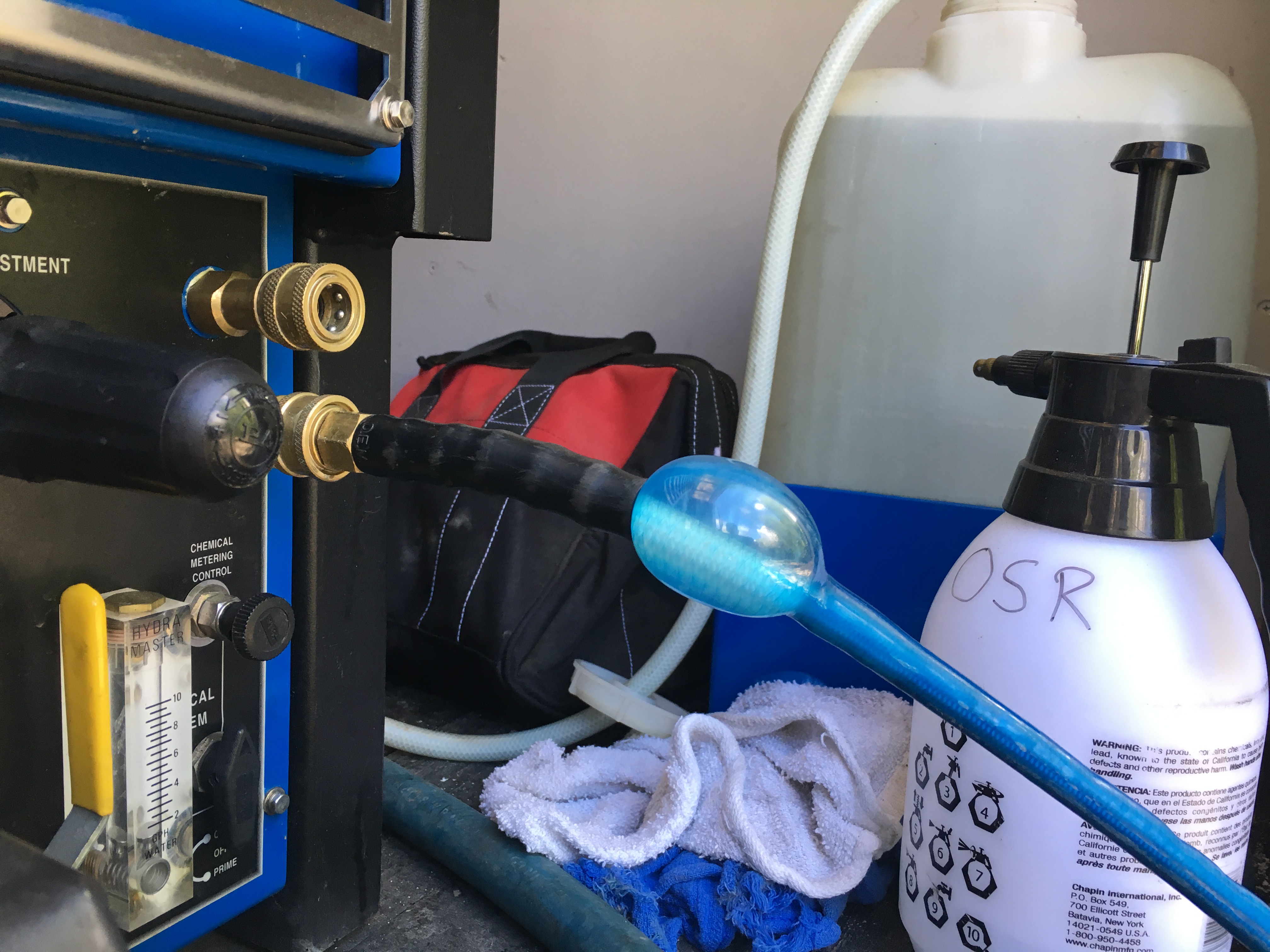

That happened to Ron Werner with his $159 Cobb hose.
His machine way over heated.
I don't have that issue with a pro1200.
My 570 I set it medium and it holds 220 atm never had a problem.
Still I used bristor, Cobbs and bought direct no issues.
I wouldn't use it with diesel heat
