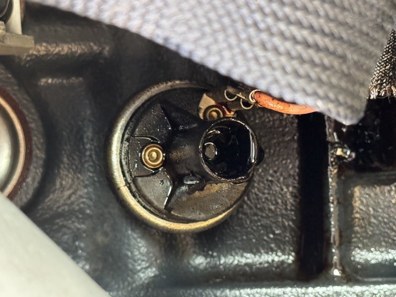

Hi guys I have a problem this thing is leaking pretty heavy and I just noticed it
It looks like it’s missing the cap in the center
I need to complete my day tomorrow but not sure how I’m gonna
The part number shows it’s a prochem part but is there anything I can grab at autozone to fix this and not wait

You can temporarily bypass the switch by removing it and plunging the hole with a 1/8 pipe plug if the machine won't start/stay running that means the switch is normally open and youll have to connect to two wires together. Keep in mind that you are bypassing a safty switch and it should be replaced asap but that should get ya back to work

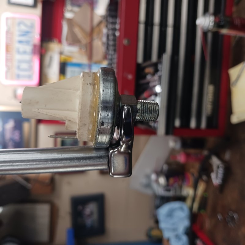

And the version you have pictured is the old version. the part number on it is 78826 7psi 2030 mex1
14,266
The plastic headed one you have crapped the same way on mine as well because the plastic weakened due to the heat over time

Thanks for all the help I got the new part and it looks totally different
I’m trying to figure out best way to remove the old one
No way to grab it except in the back and it’s hard to access all of it

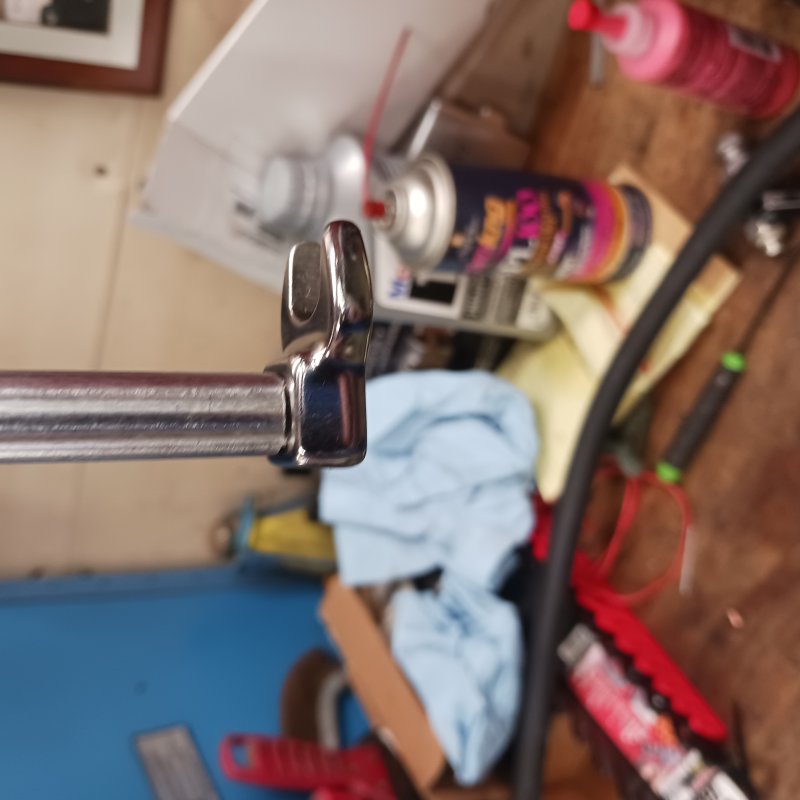

If you can't get a wrench in a 1/2" crowsfoot or a plumber's wrench should work

Yeah, I remember tearing my old one up trying to remove it.
