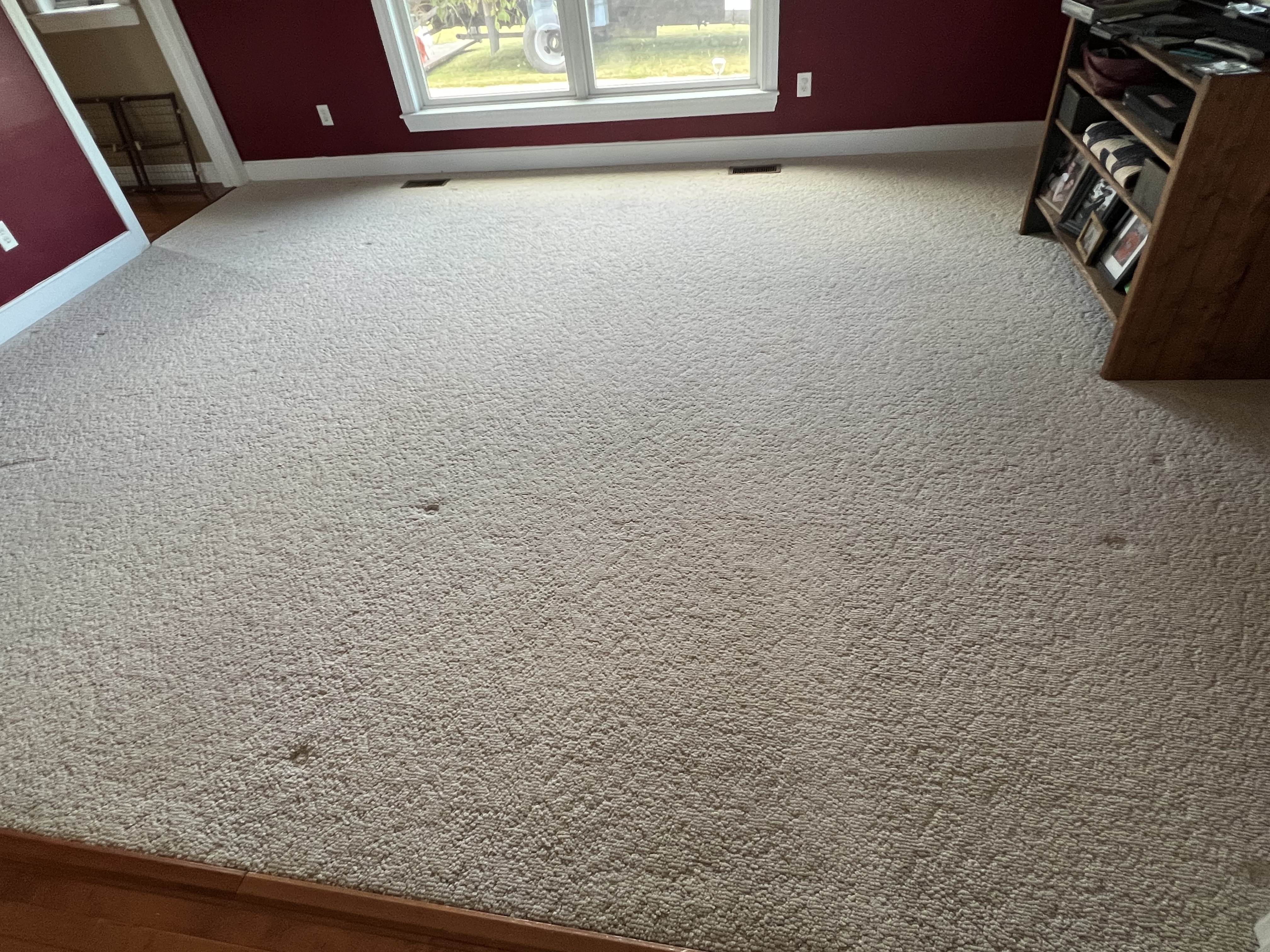

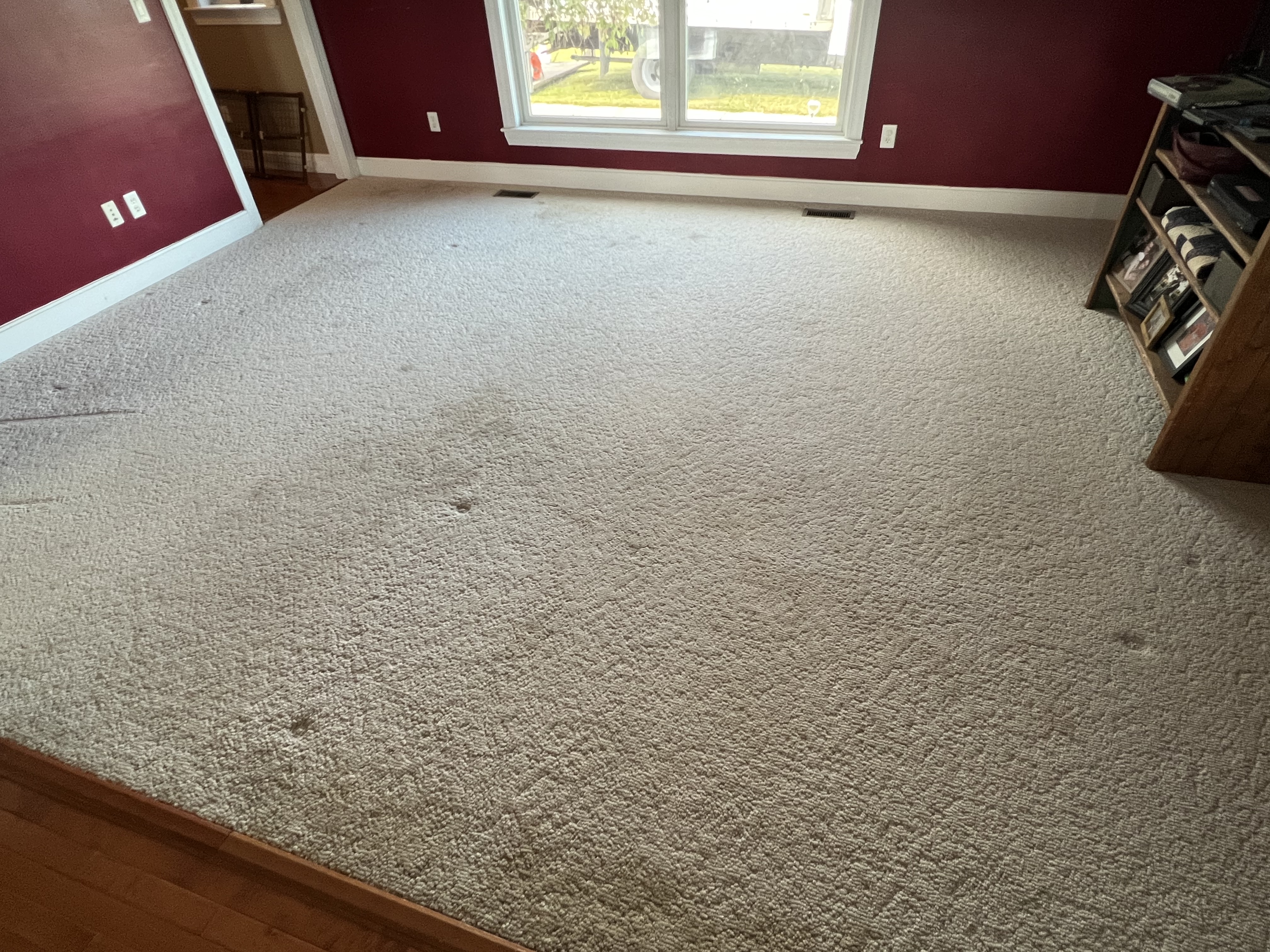

Slow dry times.
Wicking
Browning
Return visits and unhappy customers.
I easily avoided all of these issues yesterday morning on an older, white, dog urine saturated, residential carpet by using plenty of peroxide and a microfiber under the Phoenix.
I knew from experience that there was a strong chance of this stuff reappearing if I tried to HWE it. Because it was bone dry in 30 minutes, I reduced that to zero chance.
Why do I still own a truckmount again?
View attachment 118302 View attachment 118303
Impressive
Reactions: AlienAgent

Impressive
Thanks!
I thought it would clean up well, so I shot about 30 seconds of video and used it for a Halloween promo video for the VLM business I’ve been working on.
