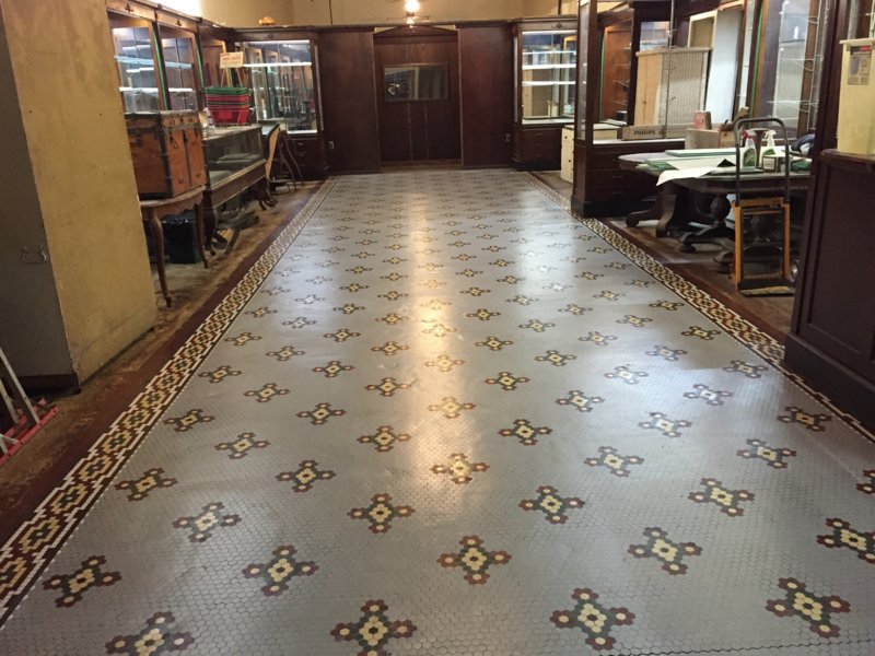

In an old church, we used paint stripper, stainless wire brushes and superheated steam to remove layers of paint from this lovely tile.
The thing driving us crazy was the bottom layer
of green paint that actually permeated into the ceramic surface of the tile. Gawdamighty it was stubborn. Look closely and you'll see that we could only steam out a majority of the pigment, not all of it. No, chemicals only went so far and no, pressure washing wouldn't have done any better. It cost three times what I would have guessed..

About 70 square feet. A sunday school bathroom and kitchenette that is being remodeled.
This will floor you (geddit?): we put 51 flipping manhours into getting that stuff off the tile and grout!!
It took 4 gallons of methylene chloride stripper, three gallons of wax stripper and another four of Viper to finally leach the pigment out of the tile. The grout also had 60-year old waxy dirt embedded under the green paint, which gummed up and hardened within minutes. It was apply, dwell, scrub, recover, repeat and repeat and repeat.

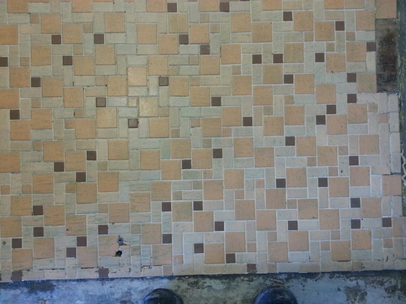

116,002
The county called me today (nv)
The courthouse had its carpet removed and the tile underneath still has glue residue after the last tile cleaner gave up..
The manager said the young crew were on hands and knees scraping away. He figures they asphyxiated and gave up..
Goo gone and black pad?

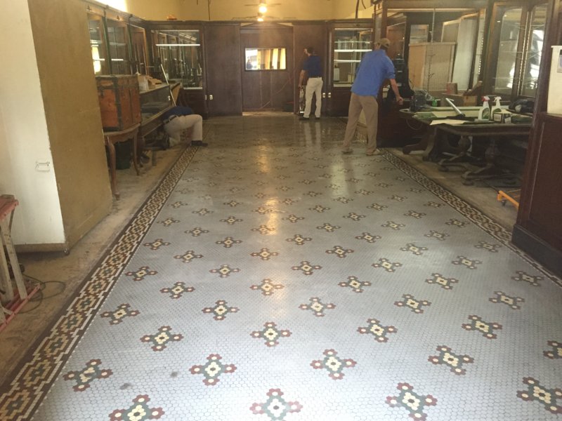

Mike, we did a job like that a while back. Study the edges carefully; we discovered mosaic edges that had been covered with carpet glue. We used a strong butoxyl-based VCT floor stripper to dissolve it, and steam. Just like removing gum on a sidewalk. Before, dull and dirty, edges caked over. After, much nicer.
