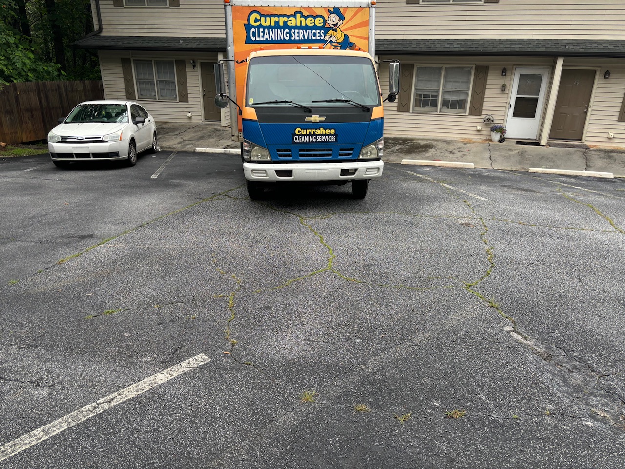

- Parking the work vehicle.
- Logistical concerns when deciding on where to park your vehicle:
- Who owns the parking space?
- Is it legal to park there for an extended period of time?
- Will parking permits or legal permission be required?
- Do you have enough vacuum and pressure hose on board,or will you need to bring extra?
- Are there any elevators needing to be used? Do you need special access granted?
- Will you need to hook up to a water supply? Will you need to bring extra hose to reach the faucet?
- Will you need any special permission or faucet water keys or adaptors to gain access?
- Are there sprinklers that may turn on during your visit and create access or moisture issues with your vehicle and equipment?
- Are there condominium or apartment complex ordinances to be considered?
- Will you need to move your vehicle in order to drain the waste tank? Can your parking spot be saved while doing so?
- Will the home or business owner, family members or employees need to move vehicles that you are blocking? Can the vehicles be moved before you start working?
- Is the space as level as possible?.Truckmounts should not be operated at extreme angles in any direction.
- If using electric extraction equipment, is there nearby access to sufficient power/amperage?
- Health and Safety concerns when deciding on where to park your vehicle
- Will the vehicle or truckmount exhaust create any health or safety issues?
- Will neighbors, landscaping or surrounding areas be affected by the heat or exhaust from the vehicle or cleaning unit? Plants and grass are easily burned from either exhaust source.
- Will safety cones or signage be needed?
- If your hoses cross a public thoroughfare or sidewalk, will access ramps be mandated by local laws?
- Will the noise involved be an issue for neighbors? Are there any noise level or time ordinances to be abided to?
- Is there a safe and legal place to drain your waste tank nearby? Know your local laws on where you can dump your wastewater.
- Will there be any snow or ice obstructions or slip and fall concerns?
- Can you run your (hot) pressure hoses to the project without creating tripping hazards or causing harm to landscaping?
- If running hoses over landscaping will there be any pesticides/ herbicides to come in contact with?
- If working at night, will there be sufficient lighting?
