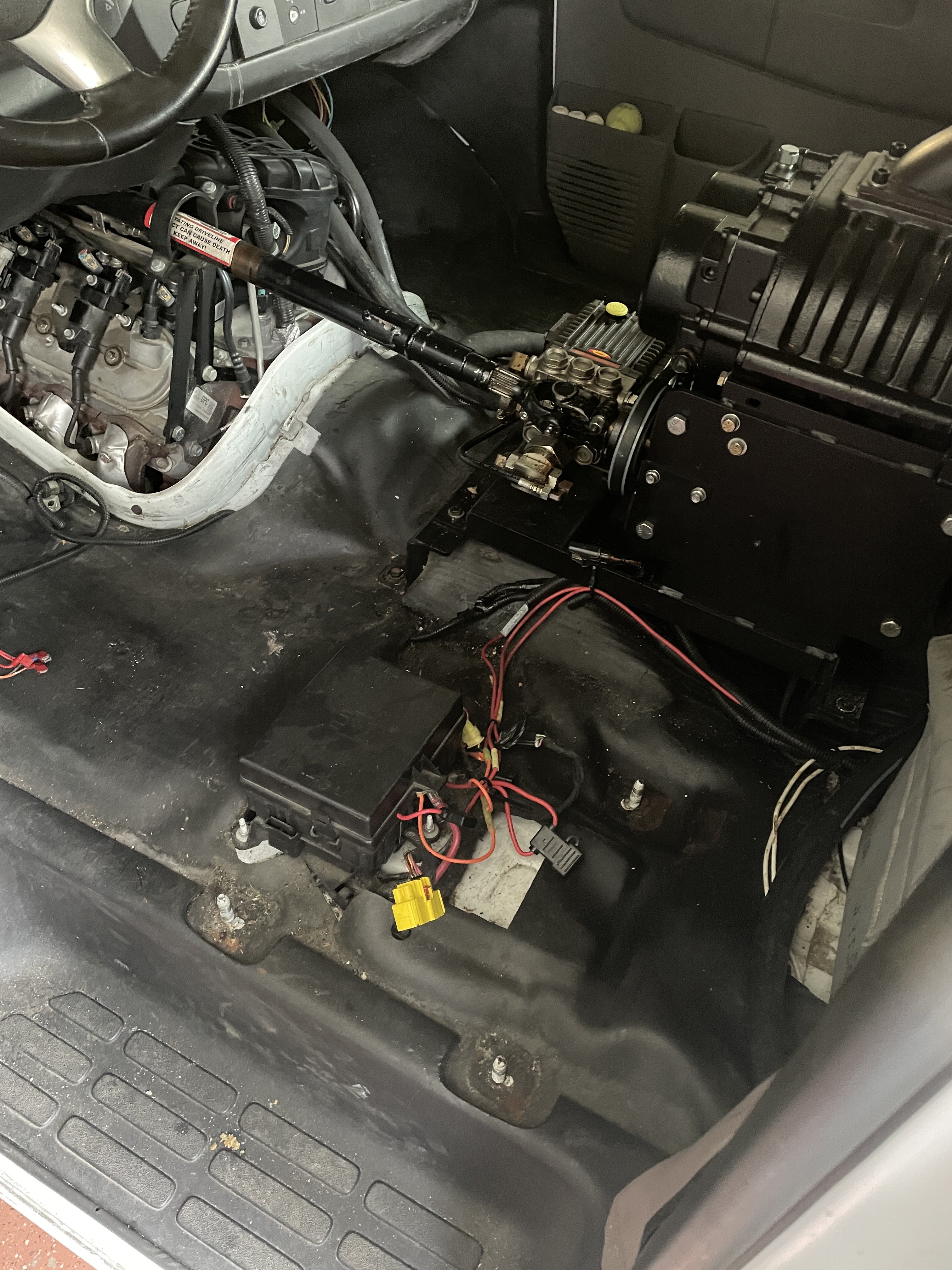

So Im starting to misfire when fully loaded with h20 and accessories. 350 Chevy 2016 Express. This happened once before a few thousand hours ago on the machine. I know I replaced the plugs, and I think 1 coil.
To do all coils and plugs..... over $2K. Dealer.
You PTO guys go through plugs and coils too occasionally?

Got it done. All new wires, all new plugs, and 2 coils replaced. cost about $1150 for that at the dealer. $560 labor and a $50 tip since they diagnosed, set up appointment, did the job, no glitches or side stories of how hard it is to find help and parts. Next time I can do this in the winter in my garage.

looks pretty simple
