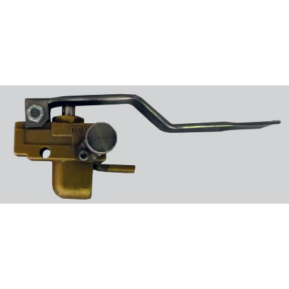

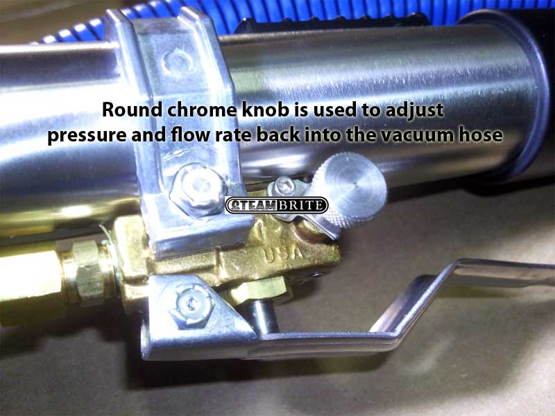

I stumbled upon this today, never seen one..
Very much like the valve on the PC hand tool
http://www.***************/u1574sbp...ed-stock-specail-order-hand-wand-p-93363.html
I know a certain inventor who may be interested in this....

How many here actually use that feature?
I know it maintains more and quicker heat and can second as a dust downer, if you do dry vacuuming. Or with certain machines letting out hot water (not letting the heat build up) when not using much water.
However I never found it really necessary.

They come with many TEXAS truckmounts.
I have a stair wand with a hole drilled In the side and a tube for the bypass. But I like this PMF design better.
Oh hell why do I care anyway. My other van just sits in my backyard. But I can dream.
I like it. It can give you scalding hot water or closed off and just get average temps. I know it wastes water but sometimes you need that heat that you can't get by triggering off and on.

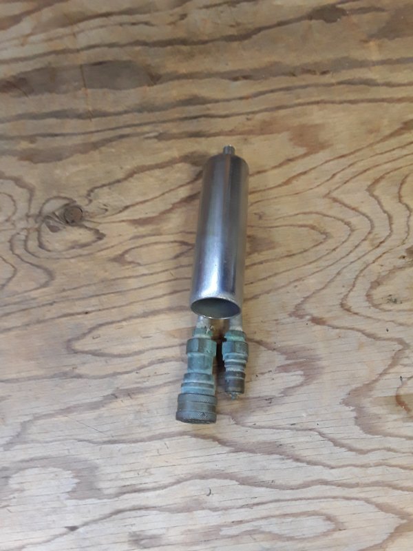

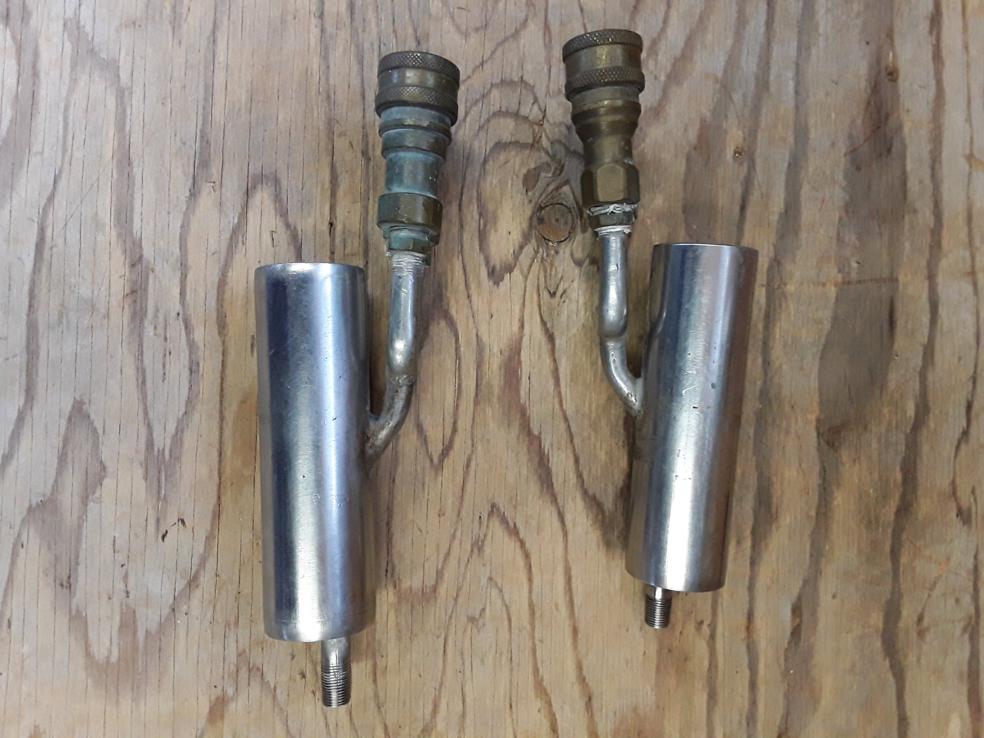

Here are a couple of bypass units that are probably close to 40 years old. They were on Steamatic upholstery/stair tools that came with their machines of that erase.
