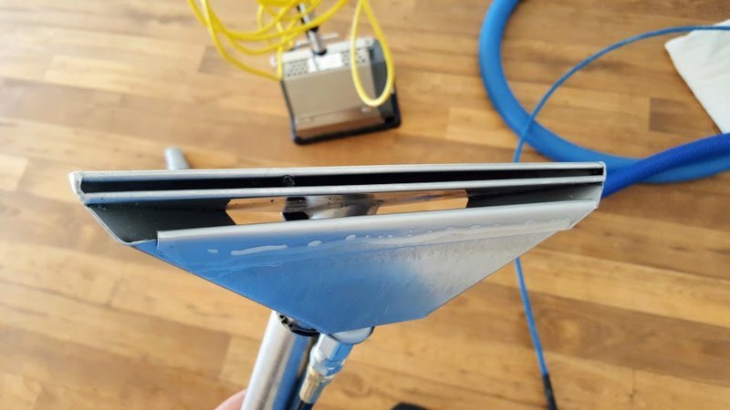

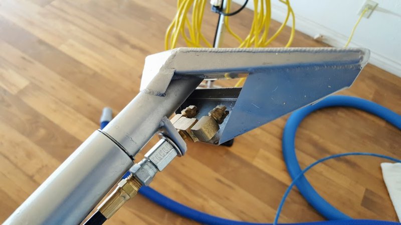

This is a Ti version made with two jets because they like me.
I used a 15" 2-1.5 tapered vac hose.
I hardly ever see stairs out here in Ranch land but I'm finally getting a hang of this thing.. I likes it!
Jimmy, youz a MORON.
No way do you need a 2" tube on this thing, It screams louder than than a stuck Marty.
Want better dry times?, do a third dry stroke.
Odd shield thingy. :headscratch:
Personally I wouldn't want a swivel and can't go back to 1.5 8nch tools. We don't use or carry a whips, our whole team is used to 2 inch.
Not saying you're wrong. :shifty:
Next! :winky:

I have been using the PMF stair tool also. When I was up there last time I picked up one of there metal 2" to 1.5 adapters and just pressed it on the end of the stair tool this thing screams.
I was not super happy with it at first, but dam guys it is pretty reasonable in price, after using it on the last four jobs I think it the easiest stair tool I have ever used.
The solution line is just a little short so it makes it a little hard to swivel it for the riser but it is very light.
I have the single jet version and there is a little splash back when going from wand to the stair tool but I just reduce the pressure with the ball valve on my solution line. The spray cover on yours possibly gets rid of the back splash also.
The adapter gave it a little more length perfect for me anyway. I actually really like it, I went out today to get some towels out of my van the carpet was poly and I needed to do so touch up on the bullnose, I could hear it all the way out at the van the thing was screaming, the water recovery was VERY good.
I'm pretty happy with it, I think I will do the @Mark Saiger two jet set up on it and call it good. I don't have glide for it, I don't think I'm even gonna get one as I like the extra scrub with out the glide.

View attachment 20020 View attachment 20021
You Pansie! Why would they make a titanium version? It's already a small weight with it's original steel model

I like the splash guard Tom, it also helps keep the slot at the correct level.
The hose is an inch too short though.
14,630
I wonder if that was why I hated the swivel
NAAAAHHH! There's just no need for a stair tool to have a swivel

Yeah I had to add a brass extention to the SHORT solution hose so that it would swivel all the way.

Seriously, I have been using the pmf swivel lately, (it came with a used tm I bought recently) and although I agree on lengthing the hose so it swivels completely, I like the single jet. I am using a 11006 and I find flushes over the bullnose extremely well. I wouldn't put a glide on it as it really digs into the crevice between the tread and riser. A shield would be nice to limit over spray but the over spray isn't bad with the single jet. Very powerful little tool.
