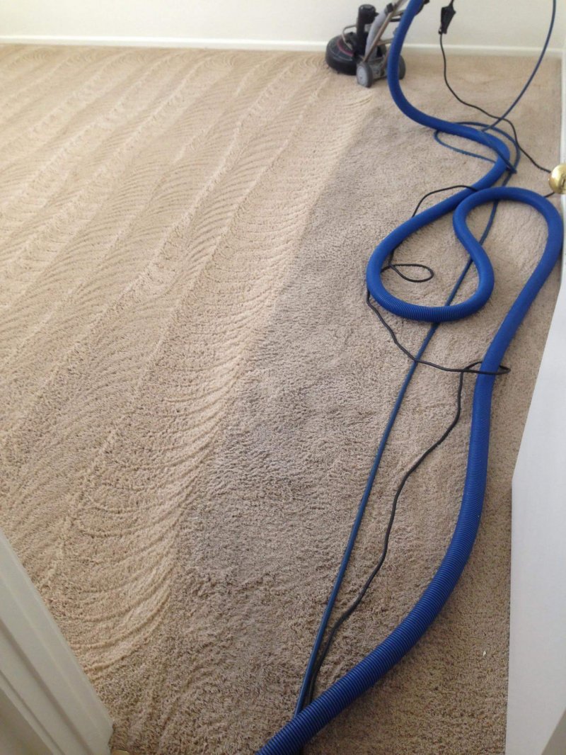

Hey Guys,
Quick question? Lately I've had a lot of polyester carpet with dark wear in the high traffic areas. Usually I can get rid of it but lately it's fighting me. I'm using Flex powder and Prochem All Fiber Deep Clean. Sometimes I hit it first with a quart of Prochem Power Solvent (spray trigger installed) then RotoVac it, then clean as normal - it's better but not to my liking? Is there some trick here I'm missing? Ty (yes it failed the nylon acid test, and it smelt fruity, and it was black shiny and hard after the burn) - the attached photo is usually how I clean so you can imagine my frustration with these dark wear areas.

This carpet is white, they have a dog, cats, and a creek / pond. He vacuumed with a Dyson, they I did with a Shark (filled my canister) and it still plugged my external screen filter outside (lost all vacuum) just a massive load of sand, soil, dog hair, etc (nasty) there is way to much crap in that carpet and it's wicked up brown now for the 3rd time / cleaning.

Good video, it's crazy as he vacuumed with his Dyson prior to my arrival, then I vacuumed with my Shark, (Clean filters and canister) and filled my Shark up over the fill line, then my external screen filter gets completely plugged up and I lose vacuum. Now it just turned brown all over - major wicking. It's amazing how much soil got in there since I cleaned last year. There was a carpet cleaner who 1st cleaned it, he gave them their money back, I was called in, cleaned it again, then had to go back and spray oxidizer on it to get rid of the wicking....I told them to just go buy some hardwood flooring......(omg) (eye roll)
