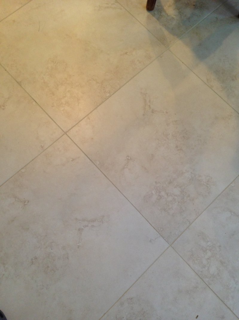

I cleaned this tile awhile back. It was a brand new install which they spilled syrup on. They spent a few weeks and just couldn't remove it all. It was a nightmare for me to clean. What gives❓I'd swear its porous. Today I cleaned his carpet and was very careful to not drop anything on it.
Every drop seemed to leave a stain. I will in the future have to clean it again. Is there a different product I should use to clean it. A different process.

probably couldn't hurt. he has extras. i could test one for fun. still, porcelain shouldn't be porous.

The cheap China porcelain is "unglazed" to give it a "matte natural stone" look.
The unglazed porcelain is "semi porous" meaning the lack of a glaze on top leaves microscopic porous uncovered so anything spilled on it actually absorbs / penetrates the top layer.
I would try a heavy alkaline cleaning first at 1200 psi at 180 -200 degrees and if that doesn't work try an acid cleaning followed by neutralizing rinse.....dry and seal with a penetrating sealer.
I have had to do this many times with "unglazed" porcelain tile.
Hope this helps
That sucks... Looks great on the floor.

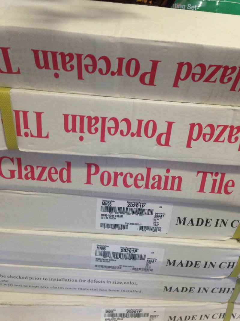

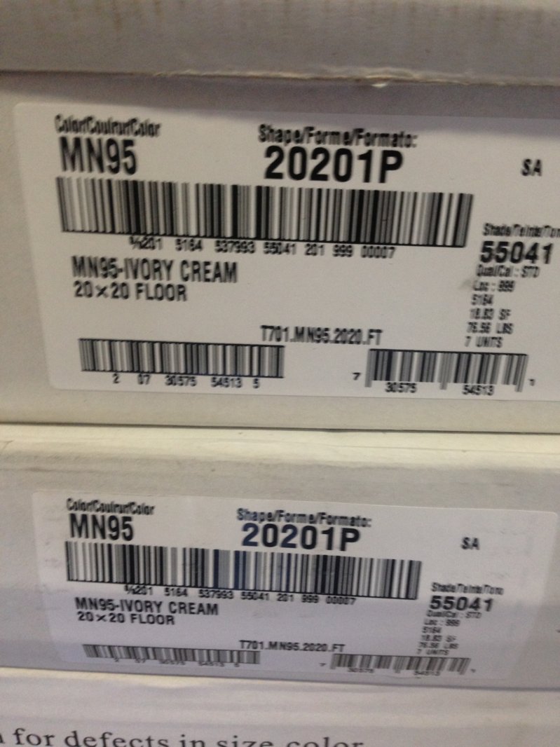

Says glazed right on the box, but also made in China so who knows.
