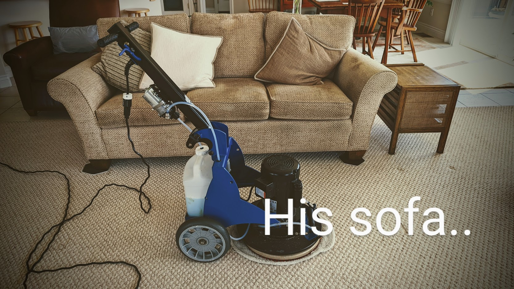

I went back to OP the Berber today.
His couch was back in place..

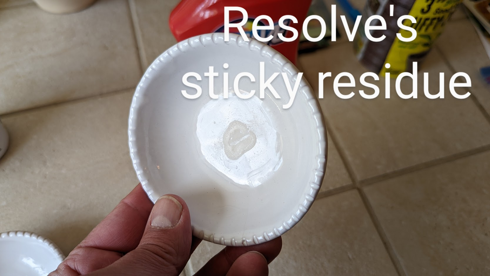

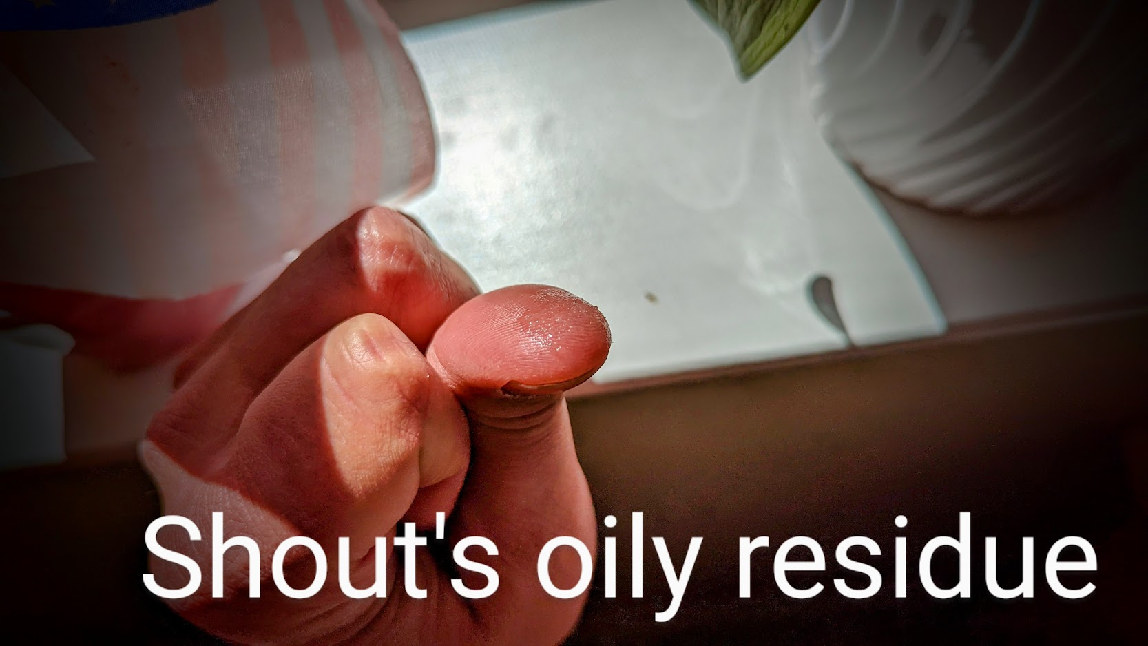

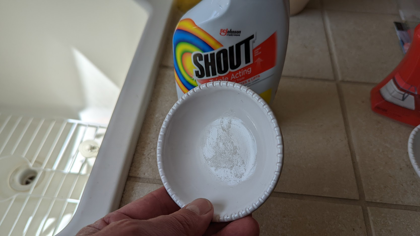

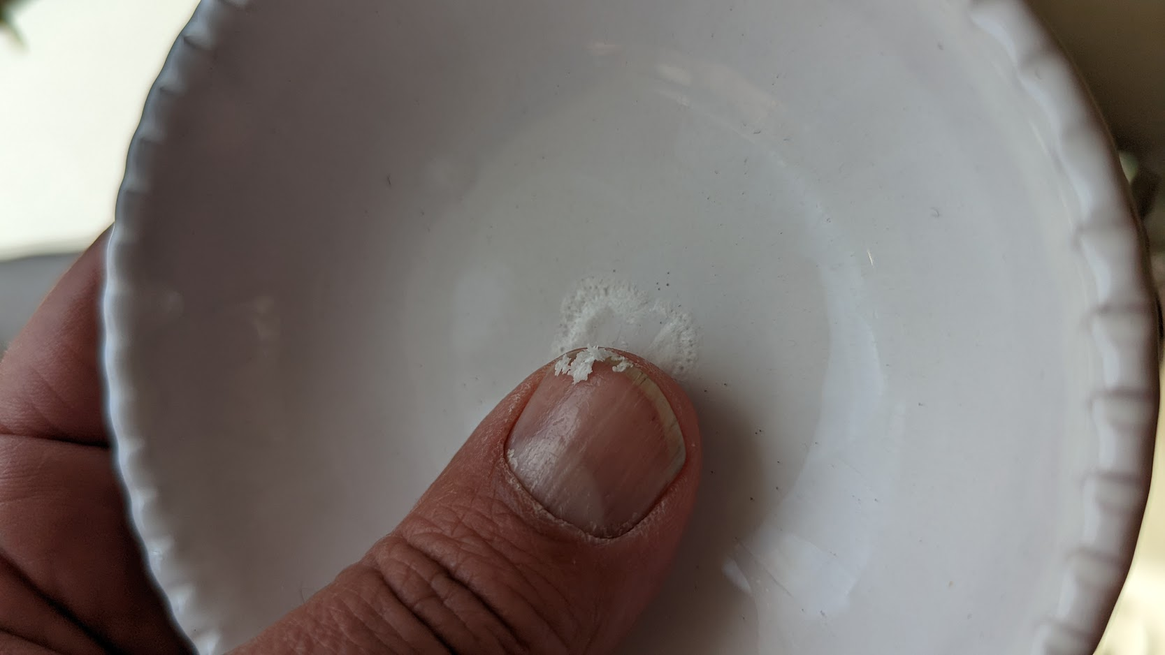

When I was explaining to her that yesterday the benefit of the post padding and using an end cap to deal with any potential residues she totally got it and was very interested in the science behind it all, interested in the point that I had her spray some of the shout spotter as well as some of the resolve spotter into some little dishes so that she could see what was drying up in her carpet, see the pictures below.
I left her some of my PCP so she could see what it would dry up to
