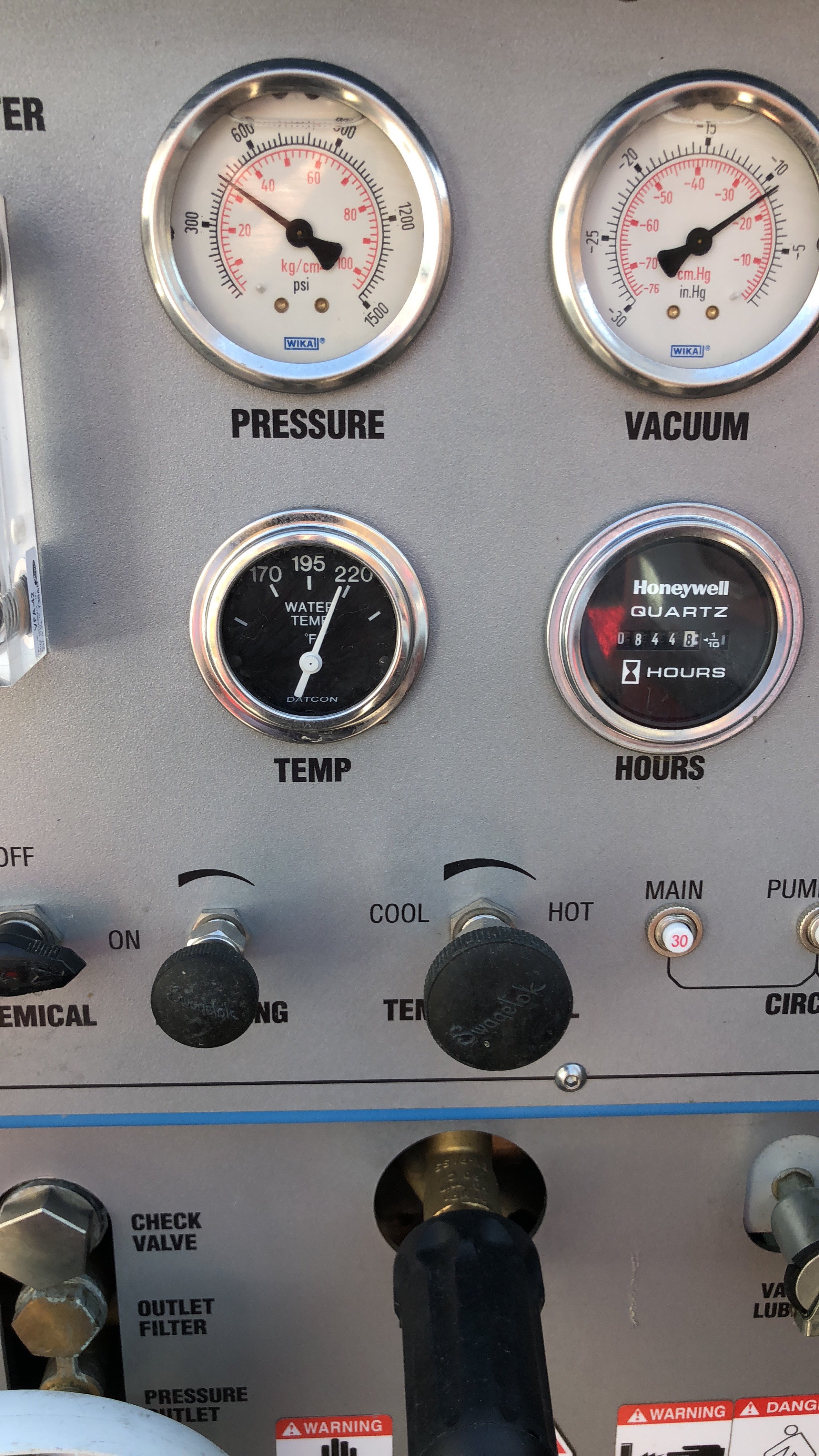

so I ran it hard for four hours straight it was spiking well over 250-260 if I let it sit to long.

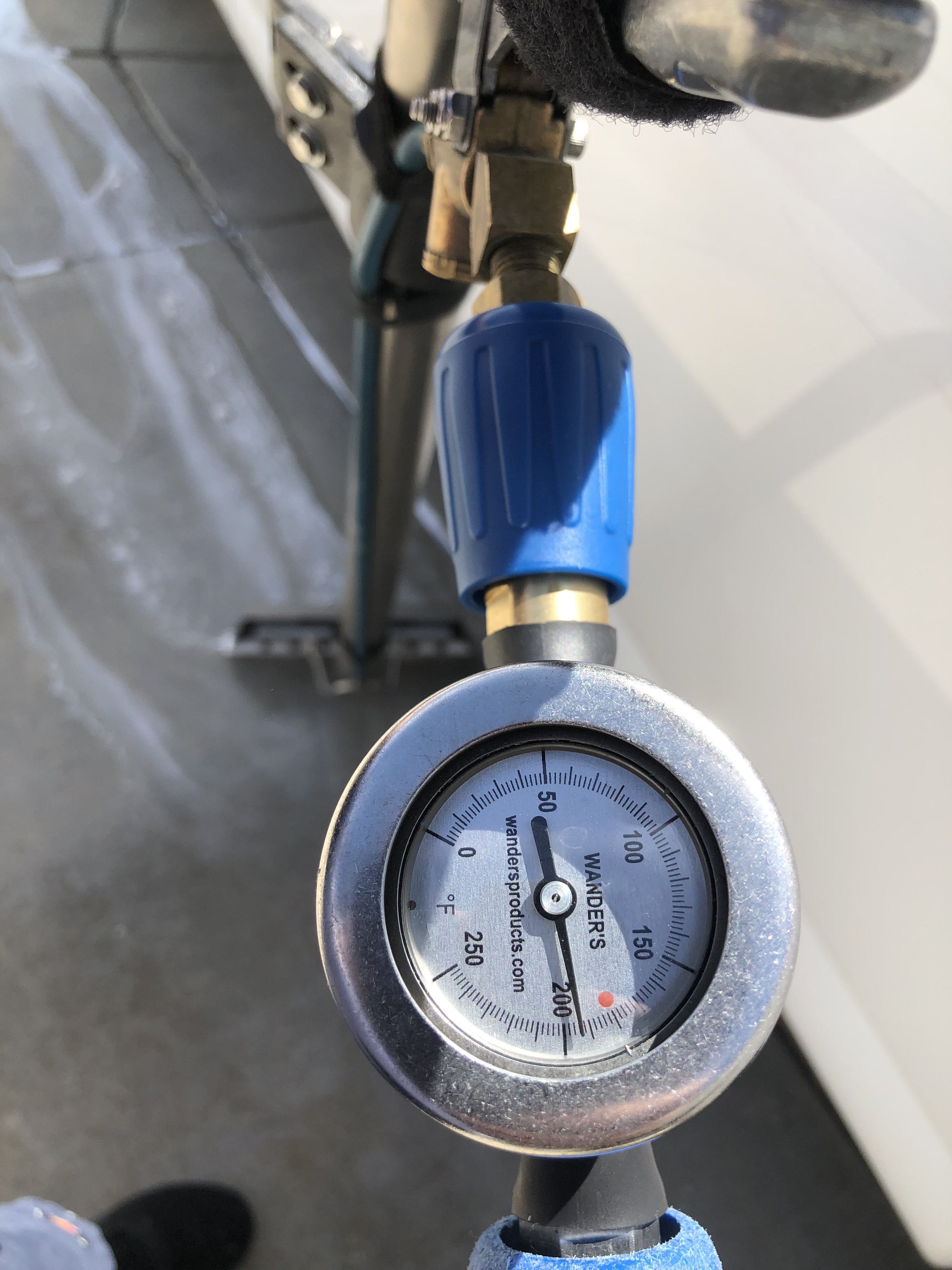

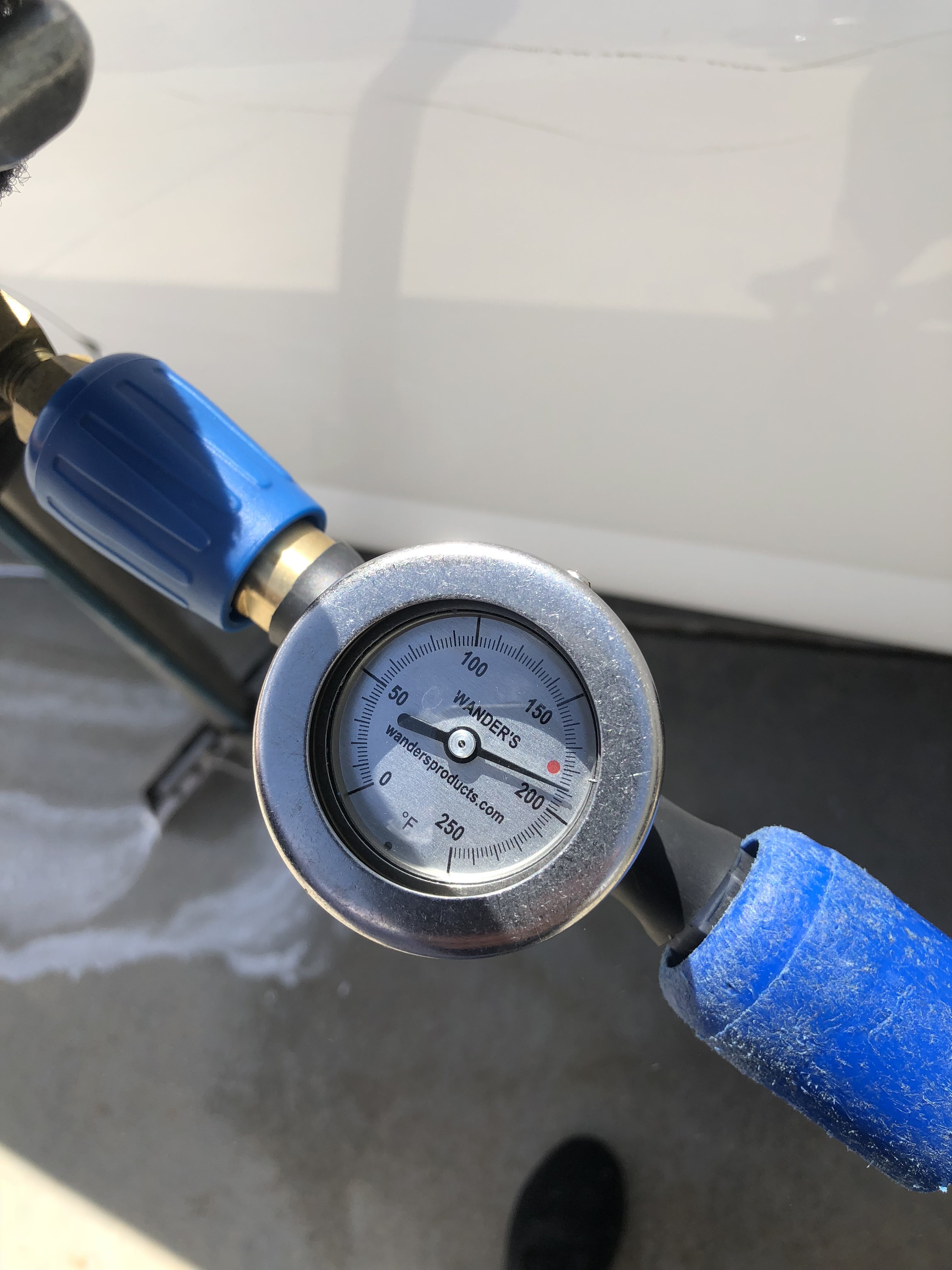

Well well we’ve been seeing numbers steady at 180 atw on medium 1200 rpm blower spinning 3000 rpms no need for high!
I know on high mine runs at 1400rpm,
Ashley M modified his at set it to 1500!
I’m tempted Rick A said go for it!
New lid gaskets really helped to!

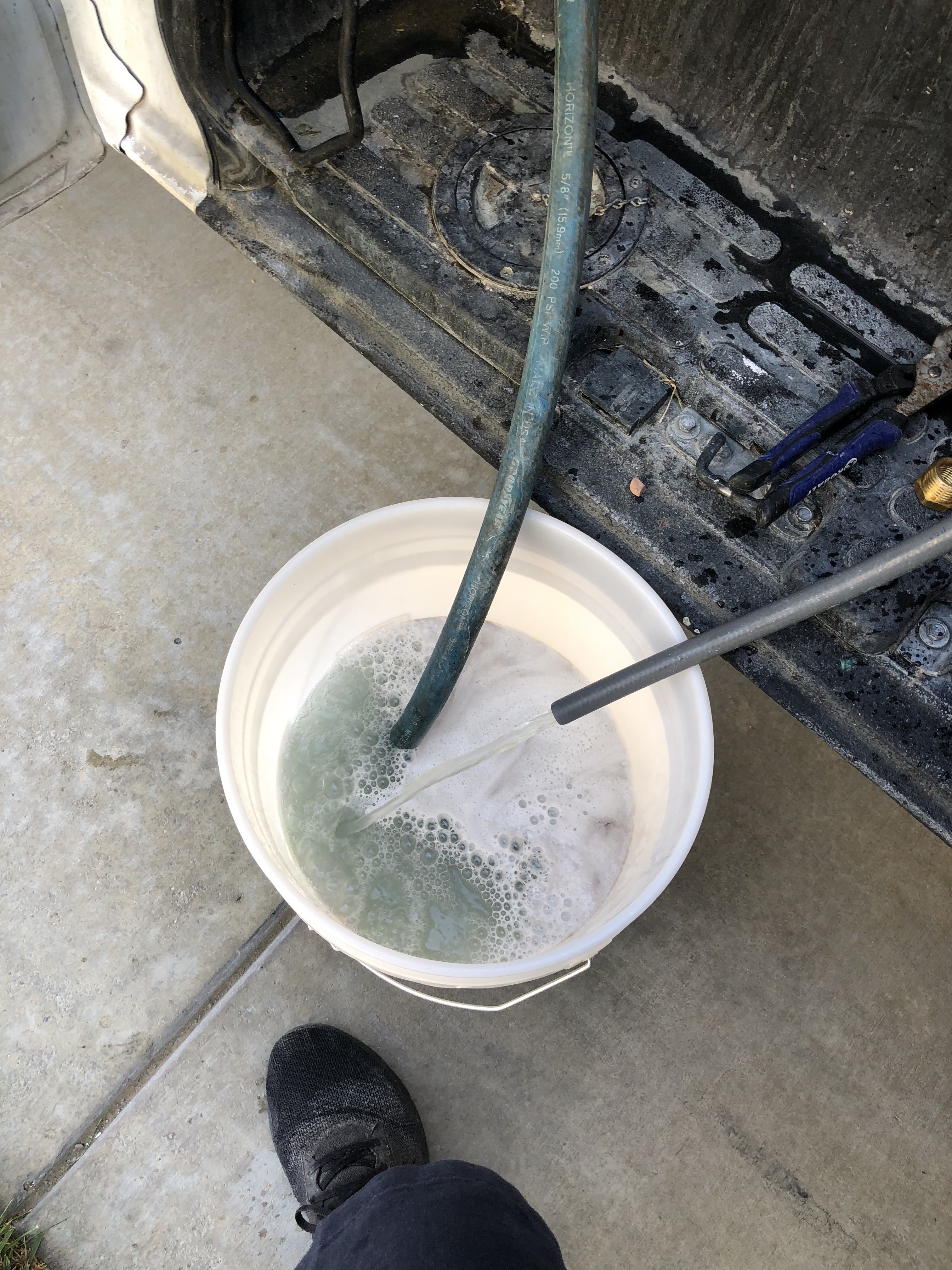

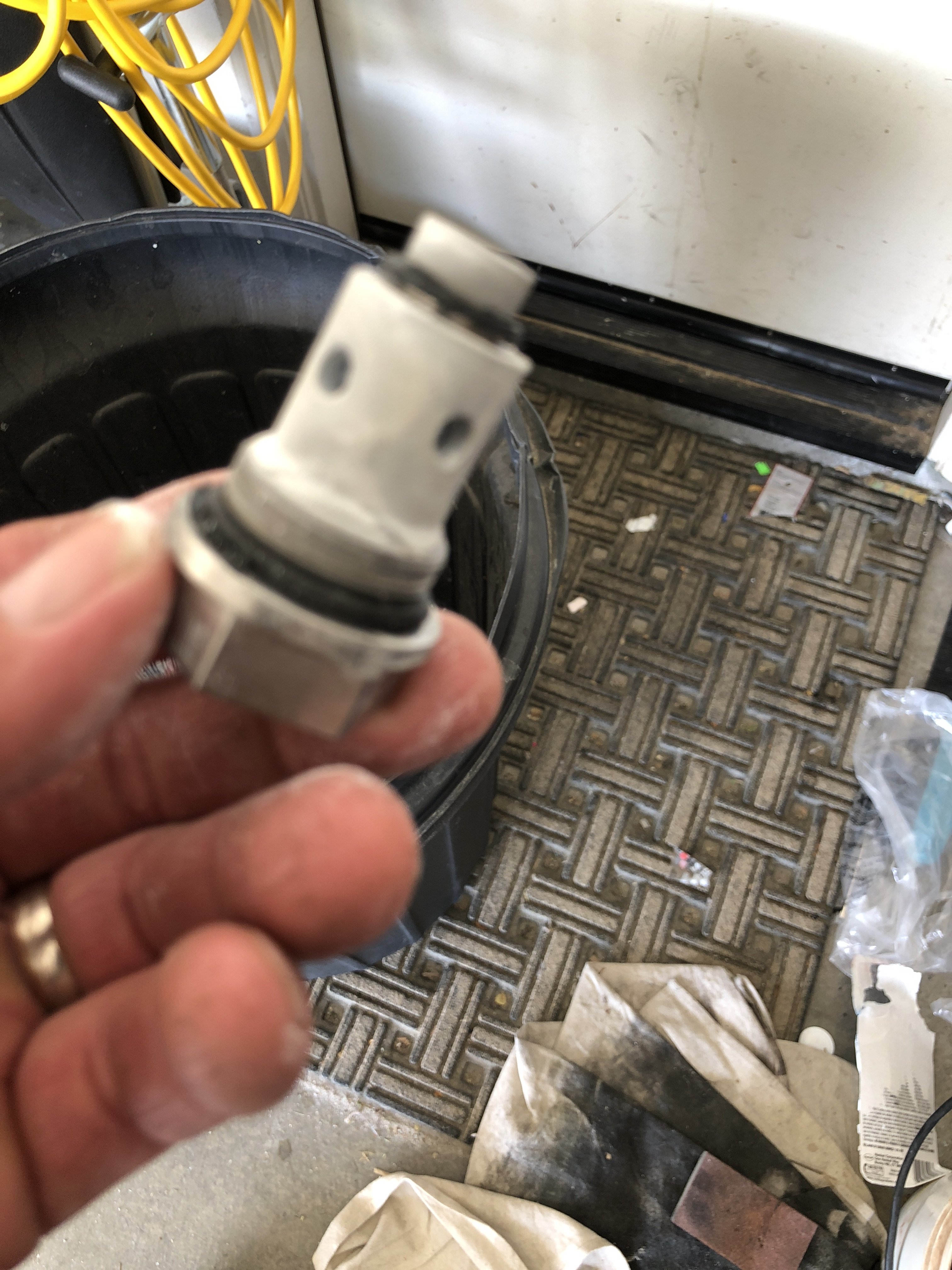

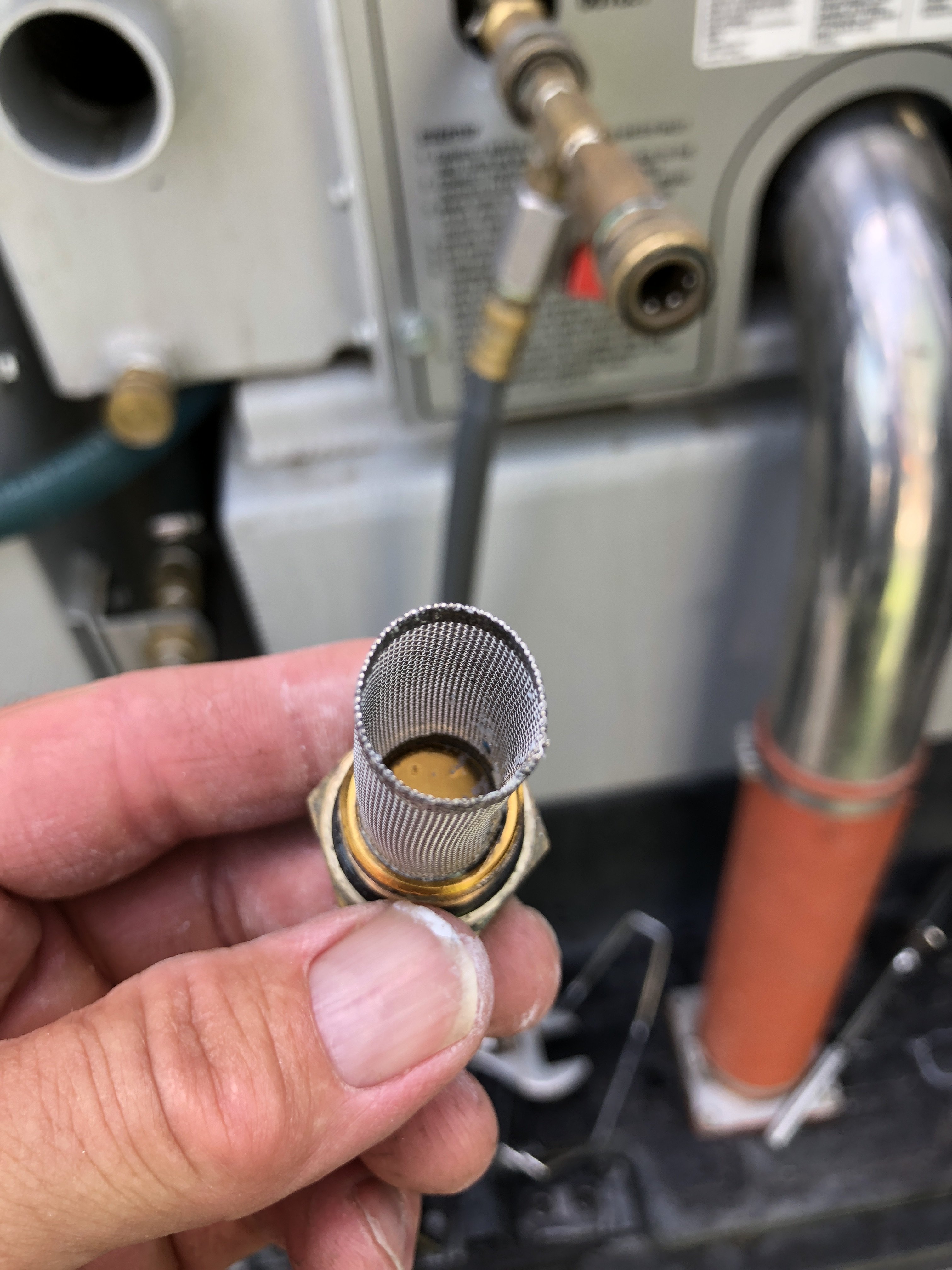

So I’ve had some serious water pressure issue but no cavitation or pump fluctuation
I opened the out bound filter clean as a whistle!
Opened the check valve and scale baby scale
So I called a few people and a dude from Sapphire Ron gave me the most useful advice!
My water mod was empty so I pulled the draw hose off added an extender into a bucket and put Prochem descaler in the bucket then let it cycle for 10 minutes.
The water pressure was back to normal.
