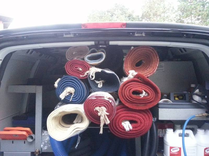

Please post a picture of your Van with the back doors open. We have a ProChem legend, waste tank with 250' of hoses Chem Shelf and storage for all tools needed to HWE and still have a shelf 4X8 foot to put rugs on. It's a E250 reg length. Granted longer then 12' we can't get in rolled and sometimes with 10-20 rugs it gets a little cramped but if we know we have a big job/order we just take out some stuff out and away we go. You can even take the hose out of the reel and use that space too!

The shelf works really well we've had up to 12'x20' rugs in there. As I said you can take all the hose out and place a piece of plywood on/in the reel and then you could place even more rolled up. Folding is less labor intensive but you need to know your rugs and signs of dry rot.

Loading the truck is always possible, as one can see from the pictures above.
