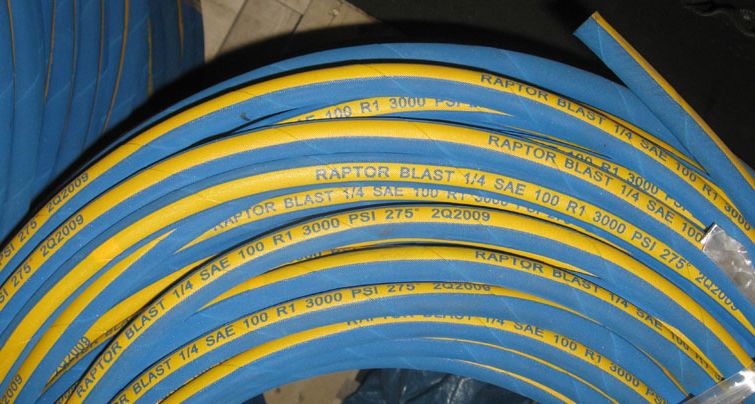

Just a note to our TM hose customers...
that the Raptorblast 275° F hi-temp hose has finally arrived.
Thanks for your patience,
Larry

The jacket is rough...
but it beats Goodyear all over the place.
Larry
