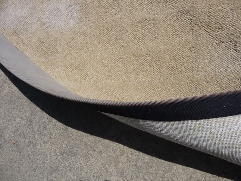

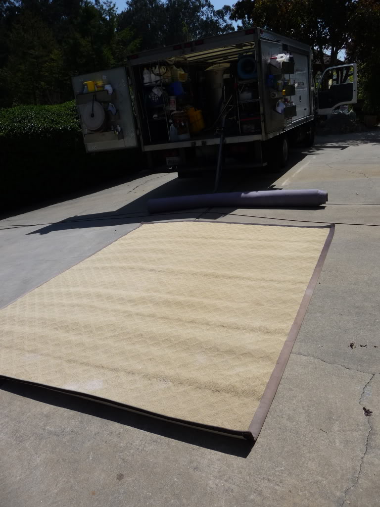

Cotton boarder on a Nylon.
Black has been sun bleach perty bad.
Will Rit fix this.
They dont want to spend much...

I had an interior designer we work for order walk off mats
with that same black cotton border. You know how some
of them are "it looks pretty". Well she forgot, people track
in salt and snow. So after we cleaned them it totally faded
the black dye. I took them back to the shop, hung them on
the drying rack, masked off the border and made sure to cover
the rug with newspaper. Then I went to Auto Zone and bought
2 cans of black automotive carpet spray paint, I think made by
Duplicolor. Spray painted them with 2 coats and they looked brand
new. Until more salt and snow was tracked in and it got black
dye all over the tile floor and rugs. It was a cheap attempt to
make a designer not look too stupid. I suppose it would work
in your case if the rug was kept dry. Keep in mind any loose dye
like that "rit" or what ever may be might transfer off onto other surfaces.
Its hard to make it jet black with Rit but that auto carpet paint would work.
http://www.duplicolor.com/products/vinyl.html

If you don't want to replace the border, just leave it and live with it. Any half-assed attempt to dye it or paint it will make you look half-assed.
G
Yes it will; I would be really careful around edges of borders; hang sun bleached areas closest to the ground and use a small cut in paint brush to dab in slowly; let dry completetly before doing any other areas; don't you carry a die kit??

I think for me it would depend on the origin and value of the rug. You are fixing what is broke, and it probably won't look perfect.
117,273
I think they may spend $100 to make it look "better" so I have to be able to do it quick.
The "rug" is already bleached out from Oxy spotters.

Mikey replace it or don't touch it.. You will create a problem when she wants it cleaned in the future or as mentioned above and it gets wet.

Mike,
I have DYED many carpets with SUN FADEING ...when I owed my Auto Detail shop!!!
The DEALERS only wanted a QUICK & CHEAP touch-up of COLOR...so they could
send them to the AUCTION....
Here is the SECRET...The Paint Kevin is talking about is really called a spray DYE.....
It is just a LAQUER based paint with an added FLEX agent.......Mask off the area.....
Apply several thin coats of paint....Remember it is LAQUER..it will dry Fast with very
Little over-spray damage...
Before you REMOVE the tape ......Brush the FINISHED product with a STIFF brush.....
This will give the DYED area a softer texture.....If there are LIGHTER AREAS..Simply
LIGHTLY mist with more DYE.....Then remove the TAPE....Inspect for any bleeding..
If you have any bleeding..Use a Q-tip & Laquer Thinner to remove......
I had great SUCCESS with this process.....NO oxidizing & they would sustain 1 or 2
cleanings without dye loss..........
GOOD LUCK!!!!!!! lots of Profit in this type of repair.....Have them SIGN-OFF....

With the advent of quick strike dyes for nylon, it has become a fairly easy fiber to recolor. Cotton requires a different dye process. To do it right, you'd have more money and time involved that just having the faded edge re-bound.
Ever heard the phrase, "No good deed goes unpunished?" Trying to save the customer a buck by doing something half-assed means you give up the right to complain when the customer forgets all of your warnings and holds you responsible. If you hack it and the color crocks, you're on the hook for the damage.

Using Rit involves boiling the cotton in the dye mix.
I wonder what it would cost to put on a new boarder ?
Otherwise, I'd walk.
