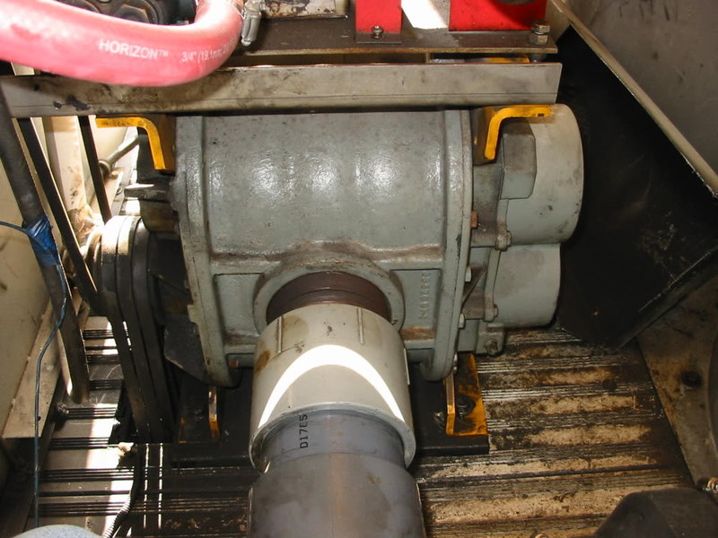

this is the mounting foot on mine....one of these in each corner...and you can see that they did not even use both mounting slots....

What brand blower is that? Did u bring the diverter silenoid inside the box, or was it bought like that?

the blower is a tuthill 6008......... I removed the solenoid from the frame under the truck and re-mounted it inside the box next to the blower to keep it clean and dry.....pretty easy to do....there is more then enough vacuum off of the booster to add the extra line to run down to the diverter ..then just trace the power wire back towards the front of the truck till you have enough to bring it up to the solenoid....and then just reground it into the mounting plate....you will never have another problem with the breathing stone and never have to worry about the unit again......

What year was your truck? The blower looks nothing like mine, from what I can see. On my 6008 I put the cylinoid in an electrical box under the truck. Thanks for the pics. I will do that to the 777. Now that both are paid for, Ineed to put some $ in them. May be a good winter project.

mine was a 2004....a lot of these trucks don't look alike..and even the ones that do...some components are different ...they were having problems with the solenoids getting wet and the breathing stone getting dirty...once the stone plugged up then the diverter would not open back up and exhaust out the tail pipe....so guys were driving around with a stuck diverter and cooking the lower HX..........so there big fix was to put it in a box to try to protect it......I guess it worked OK...really don't know.....IMO..this was one of Vortex's biggest down falls...the machines were not cookie cut...something could happen to one..and you can fix it....same exact thing happened to another one and it was a whole different ball game trying to figure it out.....a mechanics nightmare.......

This is my 777 59 blower foot. Excuse the venturi grease, before cleanup pic.
The blower is shimmed to match the pitch of the pto under the truck. I did have to put bearings in the 59 after this pic was taken. 3800hrs on the clock

Notice on Brads blower...all he has is angle iron holding his blower in place it is shimmed level and bolted down solid to the plate....
notice my old one....small little wings that both slots are not even being used...you can't see it in this picture but I have shims on the back side to level the belts.....
and now notice yours....probably one of the most rigid I have ever seen...nice and strong...but it starts to taper up to the right...the foot should of been shimmed instead of brought down to meet the plate....way to much torque on this...that blower is under stress.....and is causing the shaft to ride uneven......you can tell just by the way the bolt holes are not lined up from where you removed the one on the side.......be willing to bet it probably needs a shim or 2 on the other side also....
