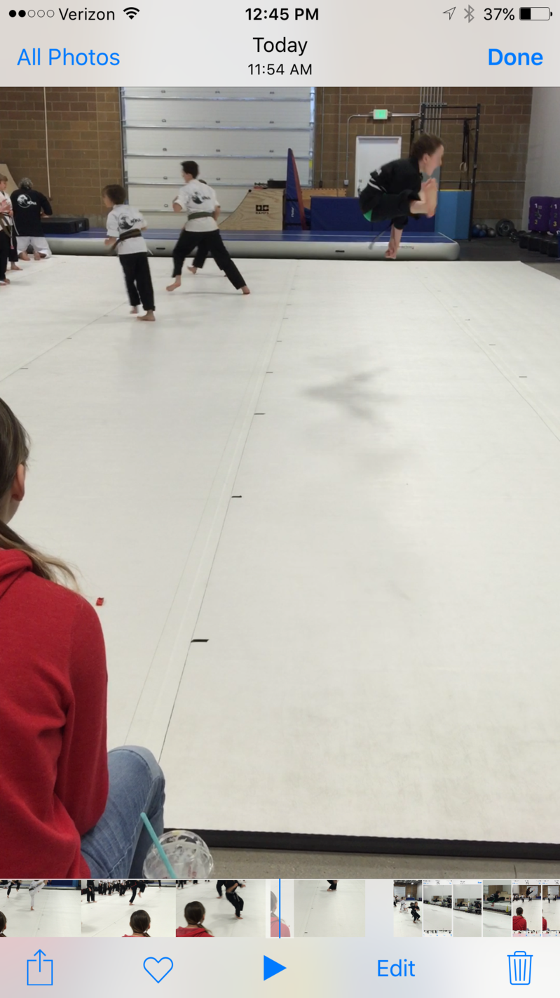

I have been wanting to clean this karate floor my son attends. It gets disgusting when you see some peoples bare feet. I'm guessing neutral cleaner, brush pro scrub, hot water extract? Guess I need to gather manufacture care info too.

Yeah I have the oversized turbo hybrid with the brush ring thats what I was thinking of rinsing with. That's my son doing the splits kick. 6 years in now, he is getting his black belt in a few weeks.
You'd better do what the boy says. Gotta go fix my penguin..
