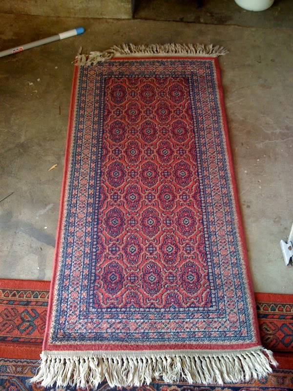

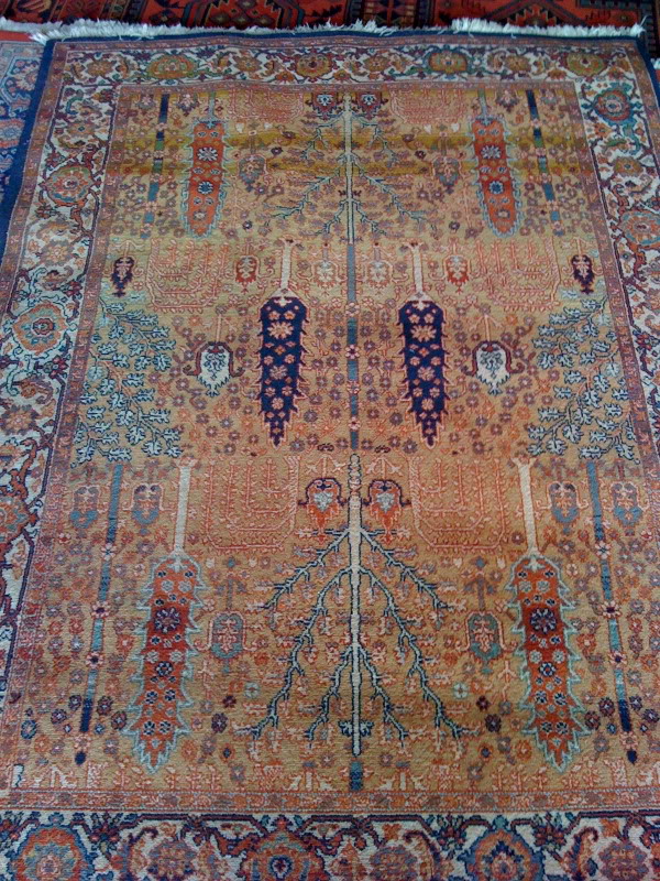

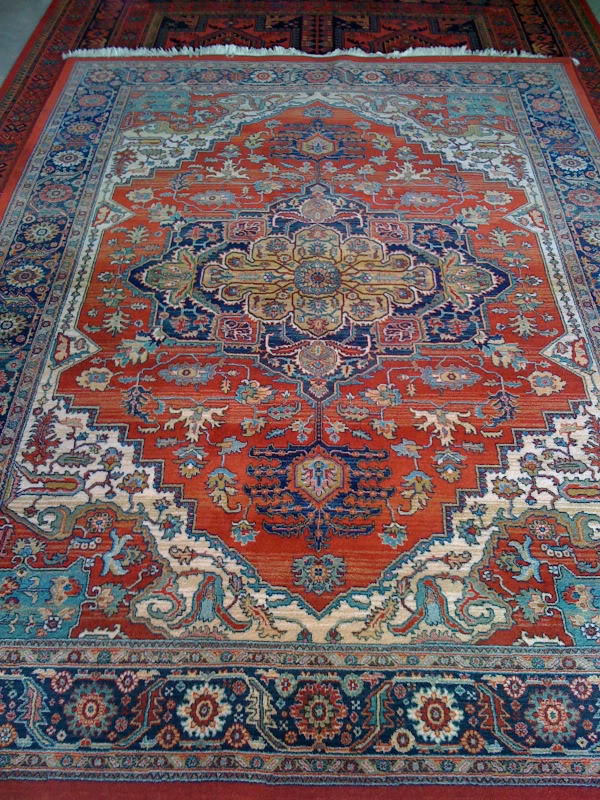

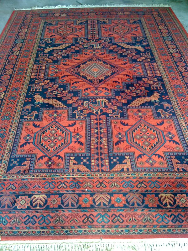

What type of rugs are these and how would you clean them step by step?
Would you vacuum, spray with hose, spray with fine fabric pre-spray, agitate, hose off cleaner, clean fringe, and then squeeze the water out.
Or would you do another process?

Ben I read on another post you wrote 1 rug is wool and silk. You were asking I believe on the ICS board .Which rug in the pictures contains silk.
May 7, 2008
8,180
I'm Rick James
I am putting my money that the 3rd rug down is the wool/silk. I would say 90% on this BB dont immerse the rugs to clean them. Do the best you can with what you got.

If you can give us a picture of each rug at the back corner so we can see the edge, fringe and knot construction, we could give you some id's.
