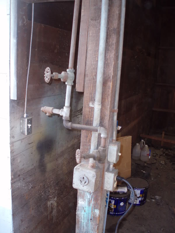

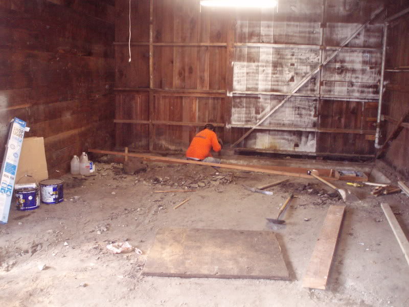

Prepping the ground to install the sump pump for the 12 by 16 Concrete wash pit.
Air Pressure hook up just to the left of the Pit

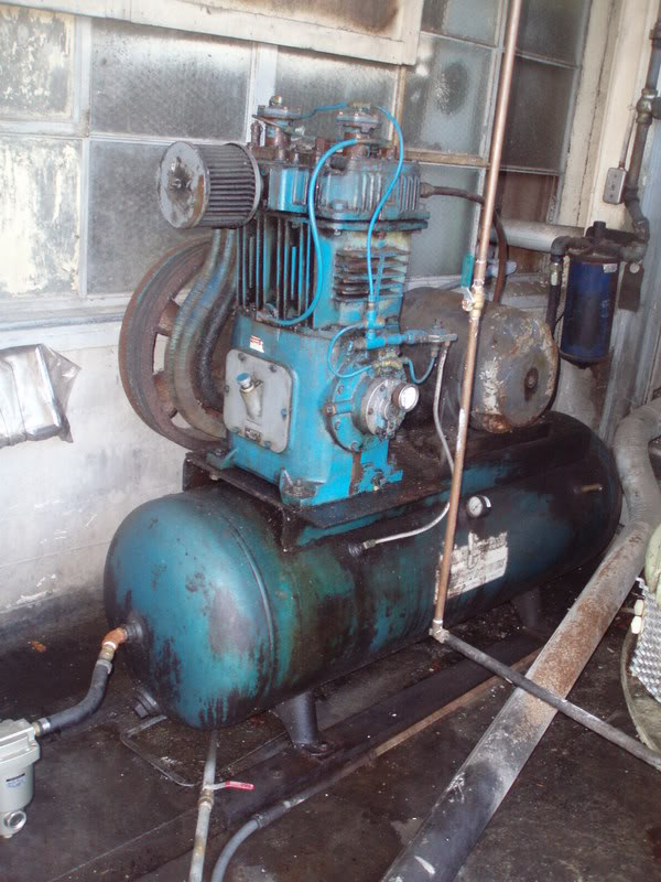

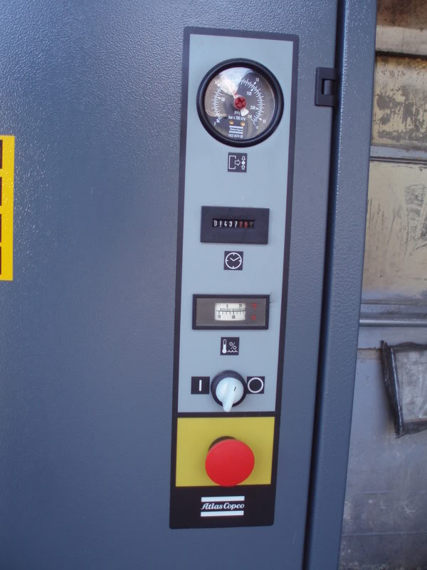

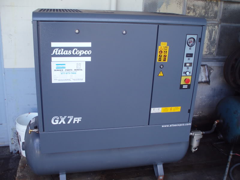

Think this baby can handle the job?
If not we have this back up compressor.

Are you planning to do an Auserehl style air dusting, or just use compressed air to blow water out of fringes? If you want to air dust, call Phil Auserehl at Castle Rug Cleaning or orientalrugcleaning.com and ask if he will sell a wand without the rest of the 'system.' You can ask him if your compressor is big enough for air dusting while you're at it. He told me he recommends a 25 HP unit.

Why a sump pump can’t you tie into the sewer?
