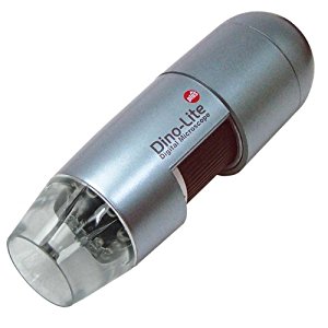

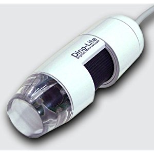

A microscope you can plug into a computer allows you to take digital photos you can e-mail. On-location you can show a customer what you're looking at on a notebook or tablet.
This one is both inexpensive and works very well. AM-2011
You can spend more money if you want. Better lens, features, couple hundred dollars. AM-3013
