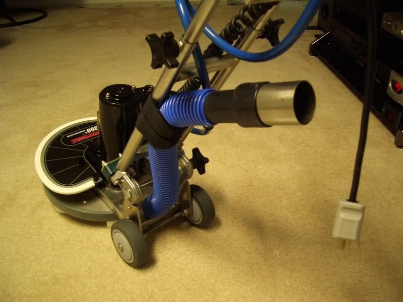

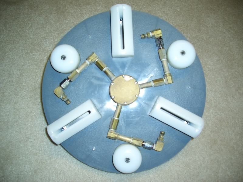

I cured the drippy jets by installing Green stubby CV's and re-designing the jet assembly in order for them to fit. I ended up with much better jet positioning causing no over-spray. I ended up notching out the end of the glides for more airflow and less Kunkle cycling, but it's hard to see
I added a short section of vac hose for much easier hooking/un-hooking vac. Also cut the power cord. I plan on getting a 2" vac manifold made soon. Also, leaving the 360 handle in the desired fixed position makes hassle-free.

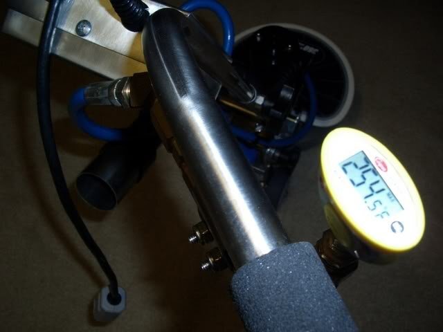

Here is my inline permanent mounted temp gauge lets me know temps ATW so I can monitor my LP tank. 254.5F is my max temp I reached ATW.
My tricked out 360 is a beast. Can't wait for some glides.

have you ever damaged olefin carpet with temperatures that high ATW
I was told of a cleaner here in Portland that damaged olefin carpet with a RDM with temperatures that high, I wondered if it was true or not

Steve, no I don't clean at those temps, it was just a test to see how hot I can get if needed, I was to nervous to go any higher. I usually like to clean around 215-230 ATW
