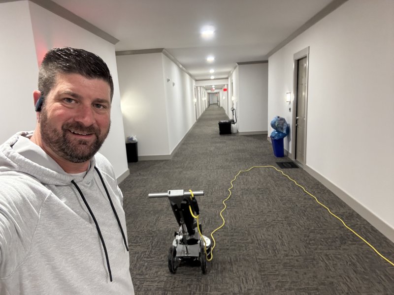

104,000 sq ft that included 15 four story stairs. 8 total days but had 1.5 days off to fit in a few other customers. (6.5 days on the job) My first VLM job. Mark never did show up but his 2x Oxy encap sure did. Stuff worked great. Went thru probably 9 gallons. It was my oldest son an I for 90% of the job. That’s a lot of work. But I’m now ready to VLM full time. Way more profitable. They are pleased with the results and booked 3 more units all almost the exact same size. Only 320,000 sq ft to go. Thanks for the info in my prior post to get me going. I did watch a lot of Mark’s videos before I started.

We're you using the Saiger Blue or the Red?

VLM allows a guy to reach any job. The sky is the limit when someone understands the process and concept.
We did 2 jobs over the last weekend. Both commercial, both VLM. Neither one was accessible by TM. I sure as heck didn’t want to porty them, as the soil load didn’t warrant it.
Used properly, it’s a viable way to maintain commercial carpeting…
Just remember, vacuuming is an essential part of the process.

I underestimated the amount of time vacuuming would take. Fortunately they had a ride on vacuum and a large area vacuum. Each of the facilities I’m cleaning do. I will need to buy myself a large area vacuum vacuum soon if I’m going to continue this.
Any recommendations on one with baseboard brush? The ride on had one and it’s very helpful.

Well I finished up all the buildings on Saturday. It was 2 more not 3. Total of 318,000 sq ft. The last 2 took 6 days each. 65-70 hours a week. Ain’t gonna lie, the hours were tough. They were very happy with the results. The last one I did was cleaned by a large company with lots of portys 4 months prior. The head janitor was telling me how impressed they were with the other company when they showed up. Lots of people, equipment, etc. They soaked the carpet and left. As it dried many of the spots were returning. They couldn’t believe how my little machine and all those pads could do such a good job. I bought a Ridgid 6” orbital sander to use with 8” microfiber pads on the 93 flights of stairs I had to clean. Worked very well. I learned a lot and should be able to streamline things a little on the next big job. I do enjoy the big jobs and will now be doing my best to land large jobs that I thought were out of my league. I think these 3 jobs may have single handedly turned my 18 y/o son into a man. He ran himself into the ground trying to keep up with his 47 y/o dad. Let’s say he won’t be talking trash about my age for a while. 😂
